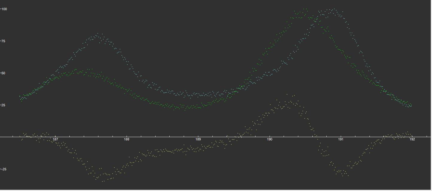

(6) Create difference spectra - type in command line @+ =@10-@11 where10 and 11 are the spectra numbers

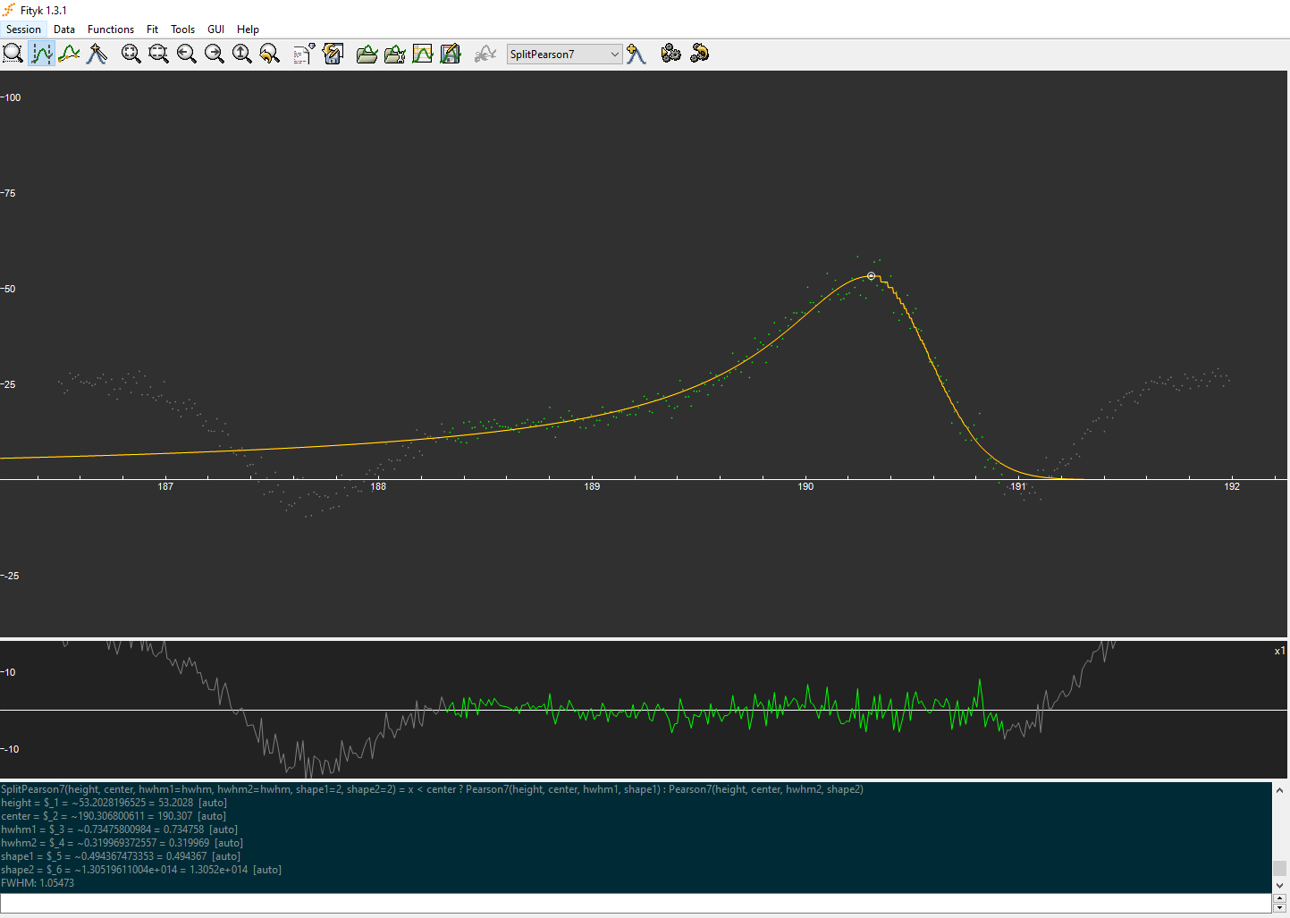

(8.) Fit peak to the maximum difference and identify centroid giving a flank position - it only fits peak to positive values so shift spectra to positive values using edit transformations - add new function Y=y[n]+25 - using data-range mode deselect parts of spectra not relevant to fitting - select split pearson7 - auto-add - start fitting - either write down centre of fitting peak (the flank position) or Functions>Export peak parameters

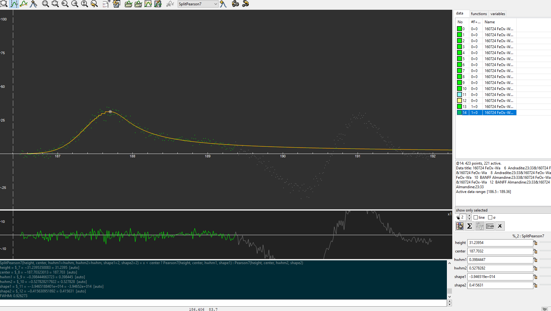

(10) Fit peak to the minimum difference and identify centroid giving a flank position - use Data > Edit Transformations > Invert - to make negative peak a positive peak - select region for fitting - fit and record peak position as before
