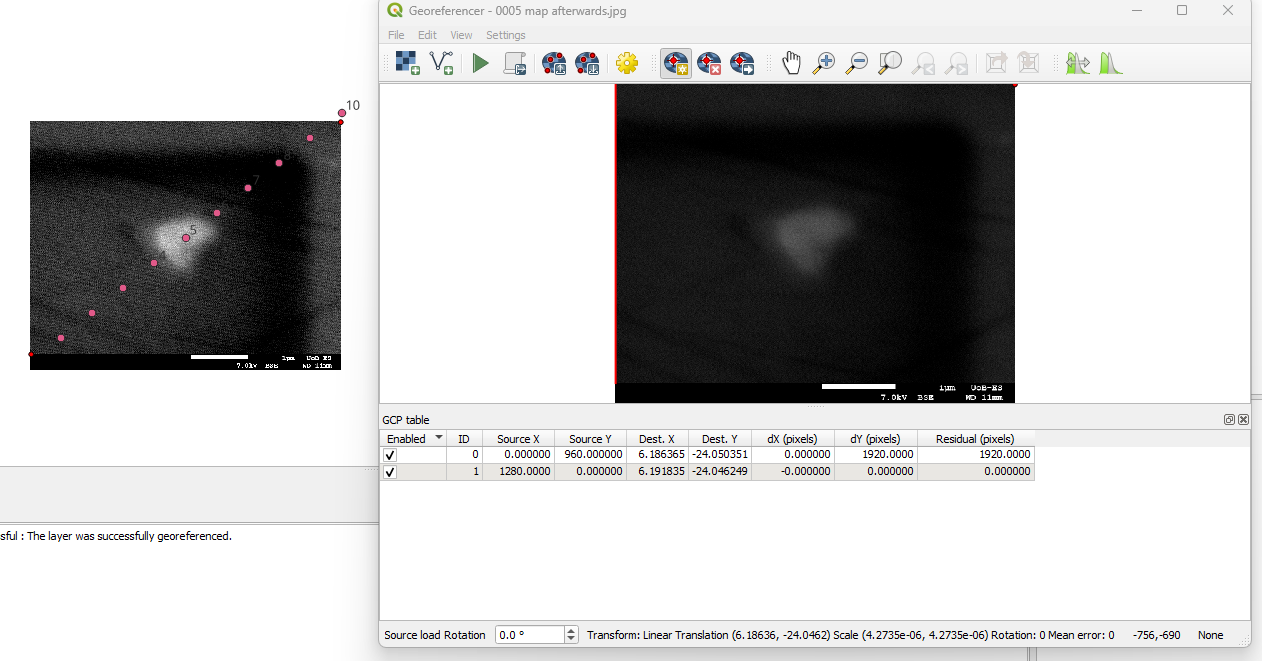

And an image of qgis

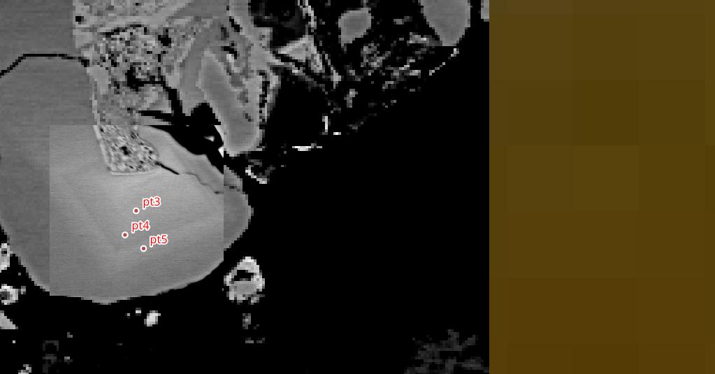

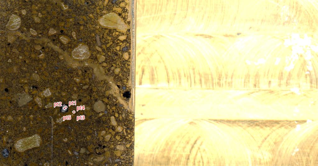

Here's an example of QGIS showing PFE picture snap image, and PFE grd images, and acquired points, as zoom in
overview
zoom in on area of analysis
