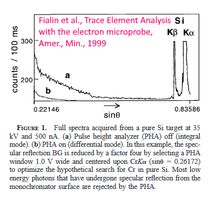

I was recently re-reading a paper by M. Fialin from1999, and he points out something I had not previously considered (or at least possibly forgotten!). And that is that at low sin theta positions, "specular reflection" can dramatically increase the intensity of the background.
Therefore the use of differential mode could be helpful in reducing this "specular reflection" at low sin thetas. This would be important for improving trace element sensitivity, since we know that the peak to background ratio is critical for trace element sensitivity.
Interesting. Could a copy be shared of that paper? (or at least a bit more details picked and shared from the paper). Looking to the year of publication I only can guess the demonstrated wavescans are made with SX50. Why it could be important? I know that on SX100 and SXFive (which electronics I am most familiar with), different to Jeol probes, the diodes are placed in series to incoming signal, which pass to PHA only positive, and only pulses with physical amplitude above ~0.6V relative to electric GND plane (the value depends from temperature, type of diode and etc.). From low energy side there is then not much to block with differential PHA as it is blocked physically already with diodes. As far I had tested PHA diff mode on SX100 and SXFive additionally to reducing background I had also seen significant (if not more pronounced) reduction of peaks on most of Xtals (be it Johhan, or Johhansson type). Reducing background 4 fold, and reducing peak 4 fold gives similar Pk/Bkgd thus no real gain with unnecessary complications of PHA introduced.
Yes, it was an SX50. But I suspect from the discussion that the "specular reflection" x-rays are a much higher energy and not of similar energy to Cr Ka.  Hence the claimed benefit for using differential mode for trace element analysis...
Here's the Fialin paper (attached).
It would be easy to test trace element sensitivity for Cr Ka in Si using integral vs. differential mode on an SX100/SXFive (or JEOL for that matter).

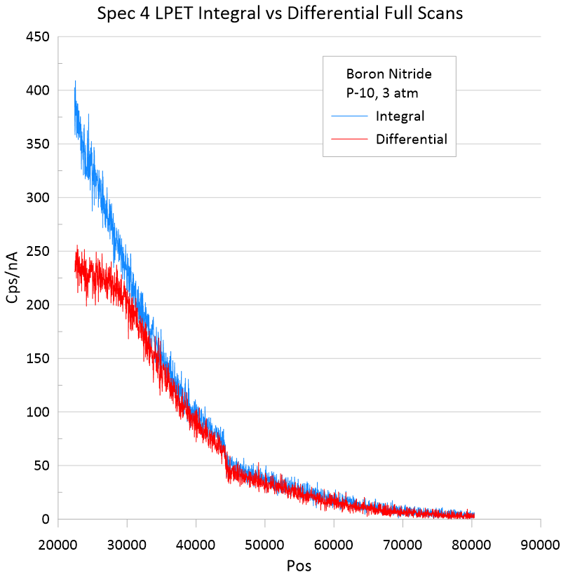

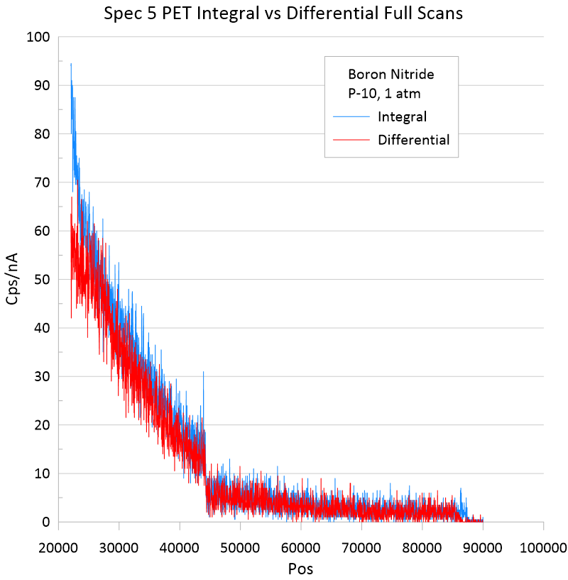

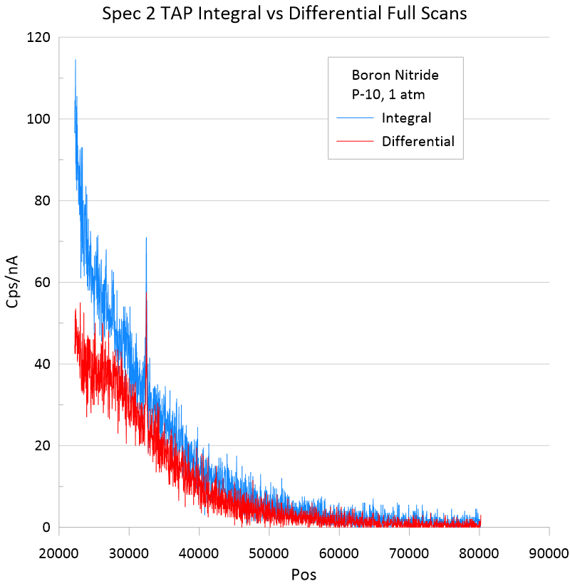

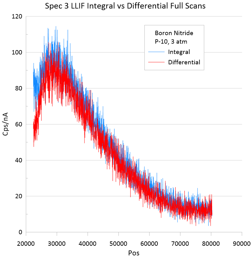

A colleague of ours (who wishes to remain anonymous), was intrigued by the Fialin full range PHA scans in the above post:
https://smf.probesoftware.com/index.php?topic=1526.msg13242#msg13242
and decided to reproduce them on his own Cameca instrument.
Here they are:
These scans were performed on boron nitride and on the TAP spectrometers one can see a small Al peak due to the polishing compound. Also note the Argon absorption edge visible on the PET spectrometers.
But compared to the TAP scan that Fialin published, our colleague's LIF scan shows little to no difference, the PET scans a slight difference, and only the TAP scans show even a minor difference in the Integral vs. Differential mode scans.
These scan were performed at 25 keV and 50 nA. But Fialin was running at 30 keV and 500 nA! I can understand the 5 keV increase could contribute to the greater difference in the Fialin data, but the higher beam current should only improve the statistics as far as I can see.
It would be interesting to see some integral vs. differential scans from a few JEOL instruments...

Our anonymous colleague responds:
QuoteI kept the window wide and looked at the PHA distributions on each crystal using the following lines to make sure the pulses remained above the baseline and below the window for what should at least be close to the full range of energies each crystal measures. I used the following lines to test this:
    (L)TAP: Si Ka, F Ka
    (L)PET: Cr Ka, Si Ka
    LLiF: Ge Ka, Sc Ka
