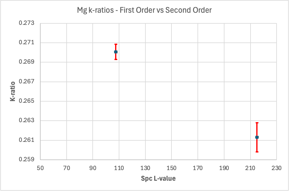

Anyway to continue... so during a discussion with Pete McSwiggen and Joe Boesenberg about what might be going on with these low Mg Ka k-ratios, Pete suggested we try and measure Mg Ka k-ratios using both 1st order and 2nd order Bragg reflections.  Because the k-ratios should be the same for both 1st and 2nd orders, if the spectrometer is properly aligned. Here are these nominal spectrometer positions as calculated by CalcZAF:
Spectro position for mg ka on TAP (140 mm), is 107.798 (with refractive index correction, k= 0.00218)
Spectro position for mg ka (II) on TAP (140 mm), is 215.2433 (with refractive index correction, k= 0.00218)
What a brilliant idea by Pete! I suggest we call this the Bragg order k-ratio test and include these in our instrument acceptance testing from now on:

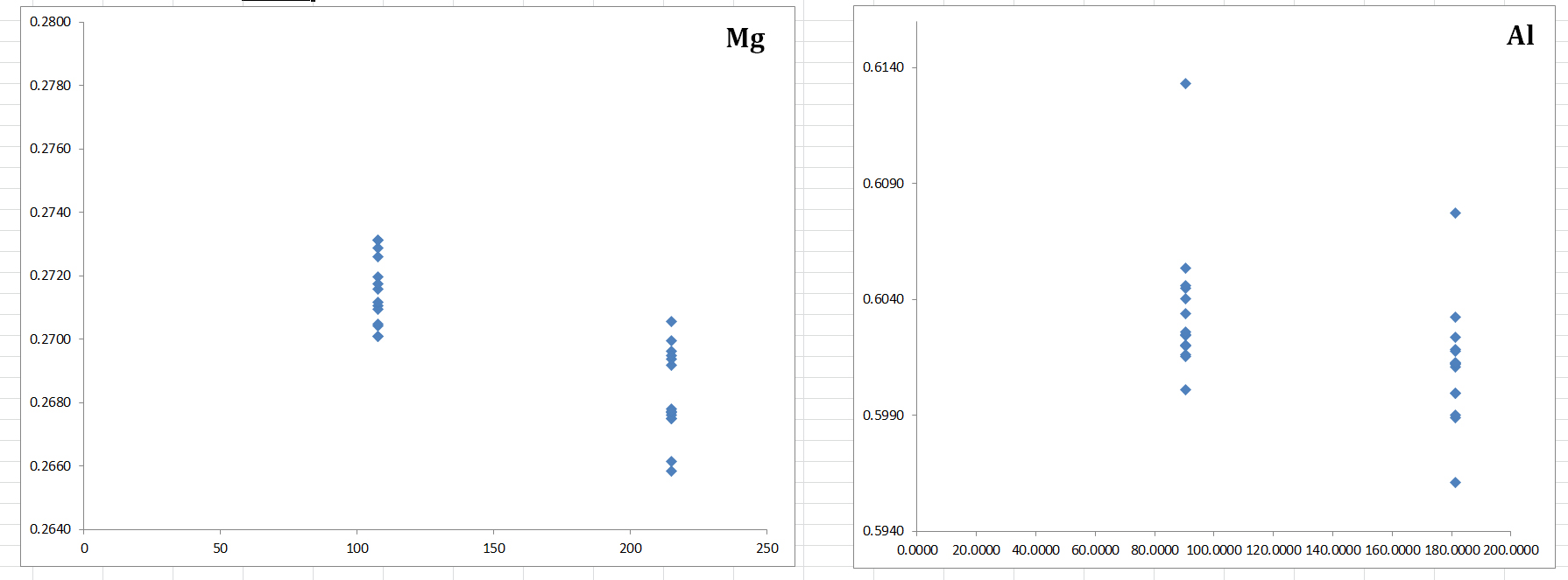

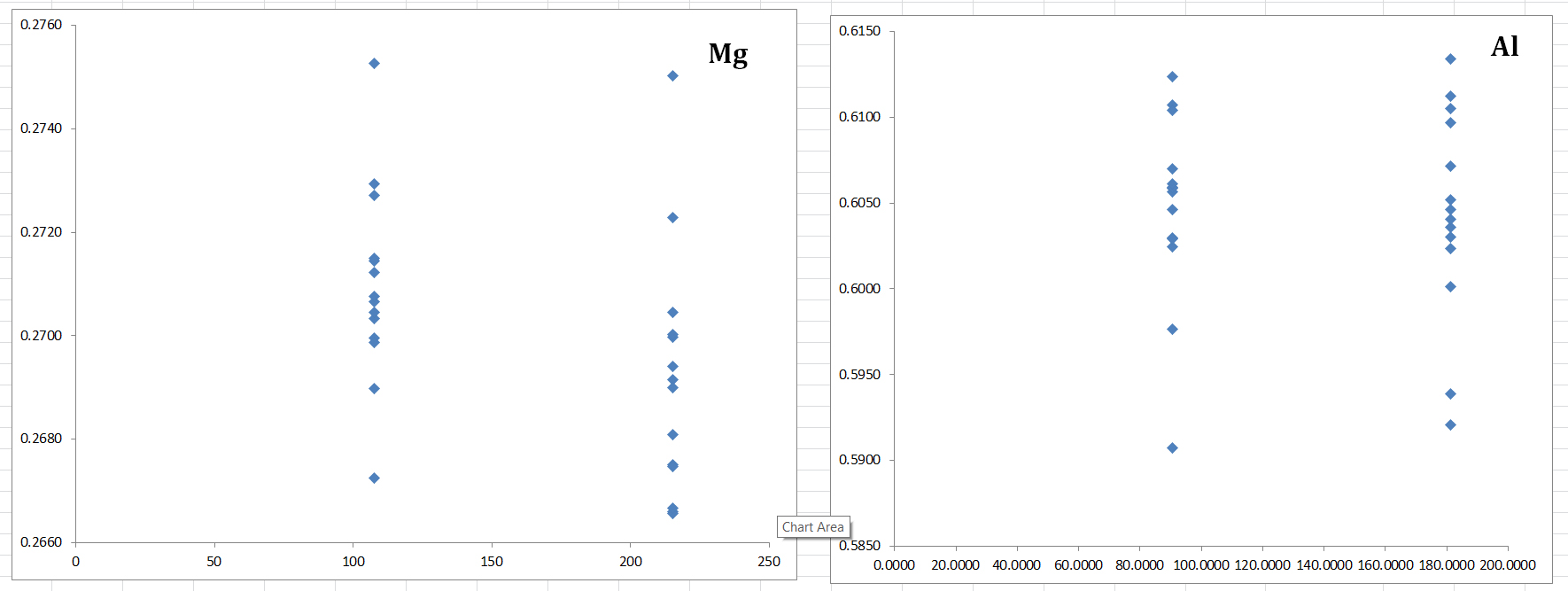

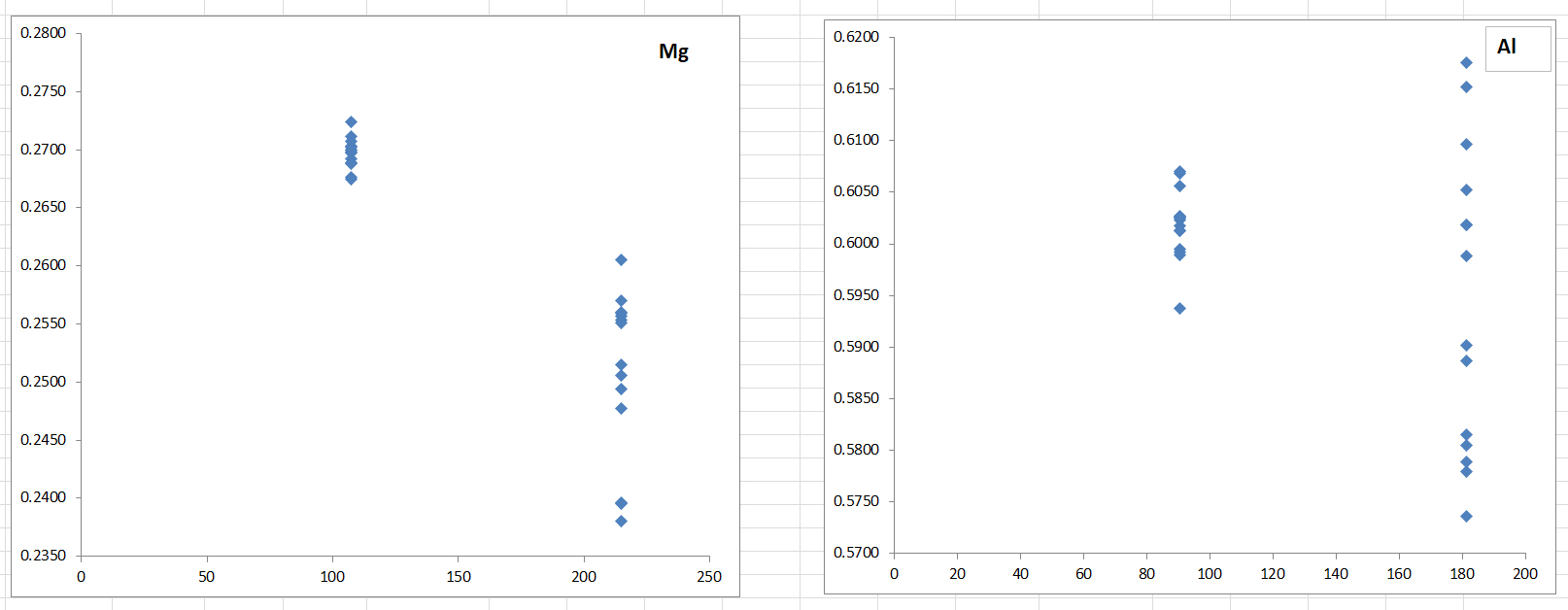

So then Joe tuned up Al and Mg Ka (I) and Al and Mg Ka (II) and here is what he obtained for Al Ka extrapolating from Al2O3 to MgAl2O4:
So pretty reproducible!  Next for Mg Ka:
Ok, I'd say there's a spectrometer/crystal alignment problem that gets worse at higher sin thetas!
The point being that whatever the two material compositions actually are, the k-ratios for these two different Bragg orders should be the same within statistics.

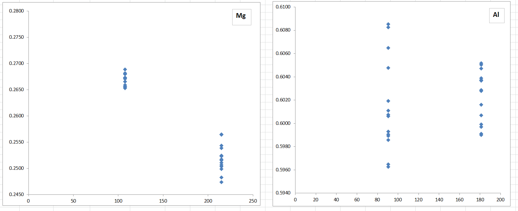

At this point we started doing a test designed by Pete and discussed by John in this forum, the so called Bragg k-ratio test, which involves looking at both the first and second order peaks for both Mg and Al on the TAP crystals. In March, this is what my TAPL looked like using those standards.
Edit by John: The Bragg order k-ratio test that Joe is referring to is discussed here in more detail:
https://smf.probesoftware.com/index.php?topic=1739.0
The k-ratio value that most labs got for the first order Mg, when they did the round robin with this standard block, was 0.272. The ideal Al value should be 0.605. As you can see the first order Mg is a bit low, but the second order Mg ratio is quite a bit off (and should be theoretically be giving the same ratio value as the first order), while Al appears nearly perfect.

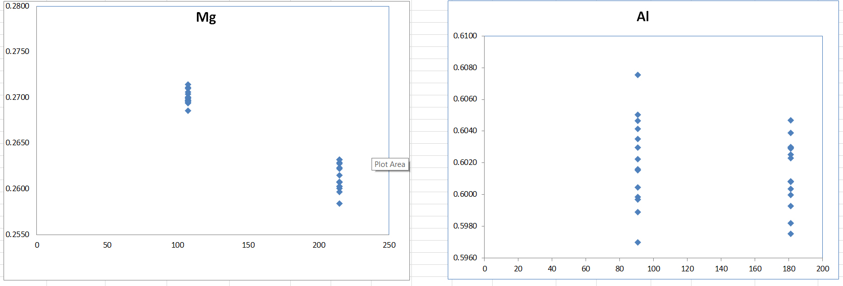

Given the shift on the Bragg test, Pete talked to the JEOL engineers, and they came back in late April to my lab to re-align the two TAP crystals. After they left, I re-ran the Bragg k-ratio tests only to discover that both crystals were still misaligned, and were now slightly worse than before.
Now in May, John and I had a meeting with about 7 people from JEOL via Zoom. The conclusion of the meeting was Pete, as the JEOL microprobe expert, needed to do extensive testing on the instrument to determine the problem. Meanwhile, all of the data from the tests I had run were sent to the engineers main JEOL office in Japan.
So Pete basically started from scratch and documented all of the tests and parameters on the probe. He analyzed a bunch of olivines and re-did the Bragg tests. One of the issues Pete found with the Bragg test was that there was a peak shift in Mg on the MgO versus the spinel. The effect is not drastic, but certainly was making the problem look mildly worse than what it was.
Meanwhile, both John and myself had heard many good things about one of the JEOL engineers, John Glass. I had mentioned John G. to the JEOL service manager, Keith, at some point, and by sheer dumb luck, John G. was sent to my lab in June to attempt to re-align the two TAP crystals for a third time. After re-aligning the TAPL, we initially didn't think much had changed. We ran the Bragg test while John G. was there. The shift difference between the first and second order had certainly gotten better, but the second order was still about 1% low.
Part of the improvement was we were now correcting for the Mg peak shift. John G. left thinking nothing had improved substantially. Before he left, however he mentioned to me that he had done a minor manual re-alignment of the electron column. The next day, almost on a lark, I did a simple three element olivine analysis, wondering how far off MgO still was. To my surprise, the totals were now all clustering around 100%, and the MgO values for the olivines were realistic. John G. came back the following week and re-aligned the TAPJ, and after testing, showed it is nearly perfectly align with respect to both the first and second order peaks of Mg.

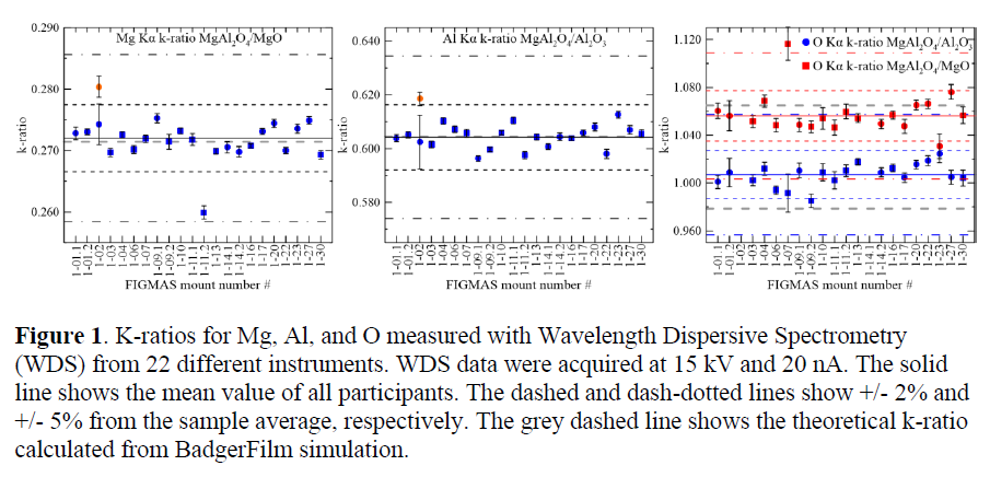

Quote from: Joe Boesenberg on June 25, 2025, 08:33:14 AM3) The theoretical value based on CalcZAF, looking at Mg and using MgO and spinel at 15kv should give a k-ratio value of 0.279, not 0.272, which is the avg for all of the FIGMAS labs. A ratio of 0.272 actually correlates with a takeoff angle of around 15 degrees, not 40. Why the difference?
Joe is referring to the FIGMAS round robin k-ratio measurements that were performed on these materials a couple of years ago by a number of labs globally:
https://academic.oup.com/mam/article/29/Supplement_1/225/7228643
The theoretical value from CalcZAF very much depends on the matrix correction utilized. Badgerfilm (using XPHI?), predicts a value of around 0.272 which is pretty darn close the average of the experimental measurements. The value of 0.279 from CalcZAF is only about 2.5% different from 0.272 but it very much depends on what specific matrix correction (and MACS) are selected in CalcZAF (which ones did you select?).

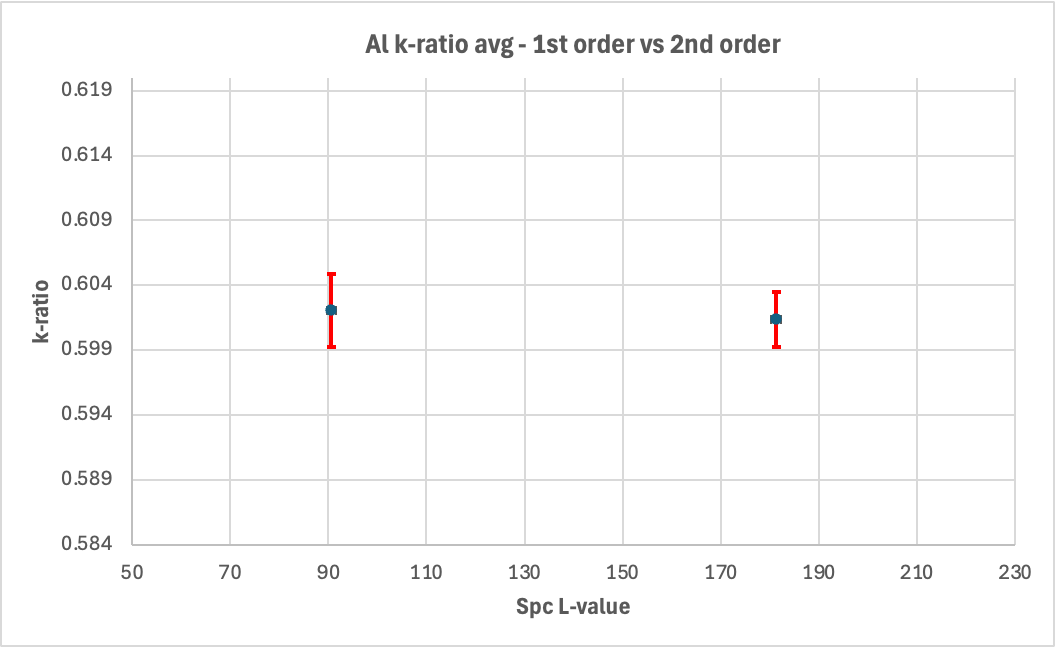

Quote from: Joe Boesenberg on June 25, 2025, 08:33:14 AM4) Why were the Al ratios always correct, while Mg varied with every new re-alignment attempt?
It's another good question. When I performed my own Bragg order k-ratio measurements, I saw both Mg and Al Bragg orders k-ratios looking consistent on two of my TAP spectrometers, but inconsistent only for Mg on one of them:
https://smf.probesoftware.com/index.php?topic=1739.msg13407#msg13407
Why would Mg Ka k-ratio be so much more sensitive to the spectrometer alignment? It's at a higher sin theta than Al Ka and the absorption correction is smaller than for Al Ka...
