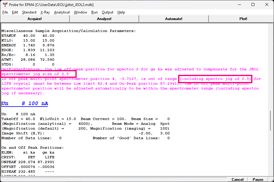

Finally, we should note that although we had been checking the low off-peak, ROM scanning and peaking lower limits, we were not checking the multi-point background (MPB) limits for this JEOL backlash going beyond the lower spectrometer limit.  New code to check the lower MPB positions  has now been added in the latest version of Probe for EPMA (v. 13.6.9).
So now, in this latest version of PFE, if these spectrometer positions need to be adjusted, the software will provide a warning to the main log window that this adjustment was performed as seen here:
