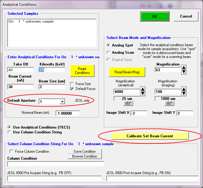

8/10/2013 9:07:51 PM, Program: Probewin, Error: Calculated CC 4 is too low for beam current of 25. Setting to default low value and continuing coarse iteration, Procedure: JEOLSetBeamCurrentMDA
it probably means that the aperture is in the wrong position, the column alignment has changed or the aperture has gotten dirty. In any case, simply make sure the correct aperture position is specified in the Analytical Conditions dialog and click the Calibrate Set Beam Current button as seen here:
The calibration will run and be automatically saved and this calibration should be good for at least a few months.

In my hearsay experience of JEOL instruments, that usually indicates that there is a aperture or column misalignment issue. The aperture is easy to adjust by us, but a column misalignment should be a service call.
Here is a another typical error message which indicates that you might want to run a beam current calibration using the Calibrate Set Beam Current button under Analytical Conditions.
This calibration can be performed for each aperture in your instrument, though most use only one or two apertures for quant work.
