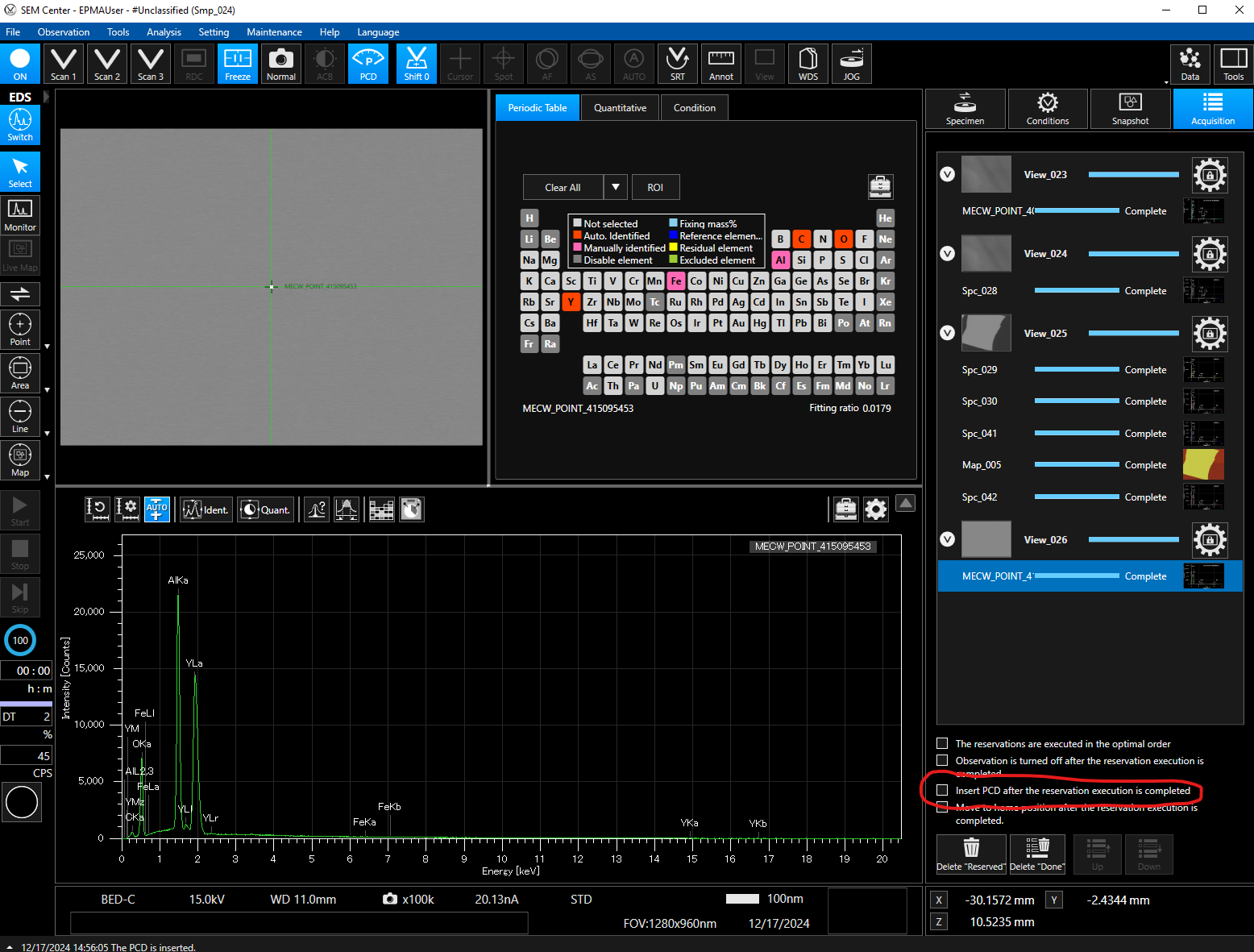

Here's an interesting development regarding JEOL iSP100/iHP200F Faraday cup measurements as discussed here:
https://smf.probesoftware.com/index.php?topic=1702.msg13075#msg13075
We're posting it here in the JEOL board because it only affects JEOL ISP100/iHP200F instruments, but it doesn't affect JEOL instruments using a non JEOL EDS system. We were perplexed at first because on Anette's iHP200F instrument using a Bruker EDS, we did not see this beam current measurement issue for the 2nd Faraday cup measurement after the analysis is finished.
Also we did not see this 2nd beam current measurement issue when only running WDS elements on the JEOL iSP100/iHP200F instruments.  It turns out, that when using the JEOL MEC EDS (which comes by default with these new JEOL instruments), we were consistently seeing the 2nd Faraday cup beam currents a little low, but only when measuring an EDS spectra. Upon further investigation we discovered (thanks to Ryan McAleer), that the FaradayWaitInTime was not being applied before the 2nd beam current measurement.
In fact, when Probe for EPMA goes to measure the 2nd beam current, it found the Faraday cup already inserted, so it skipped applying the FaradayWaitInTime as defined in the Probewin.ini file!
It turns out that this Faraday insertion is caused by the JEOL SEM Center software which assumes that when the EDS acquisition is complete, it decided (all on it;s own) that it should insert the Faraday cup.  Even though there may be some WDS elements still being measured!
Here is the culprit circled in red:
We've asked JEOL if there is a way to turn this off through their MEC interface, but haven't heard back yet.  In the meantime it would be a good idea to manually uncheck this box when acquiring EDS spectra in Probe for EPMA!
