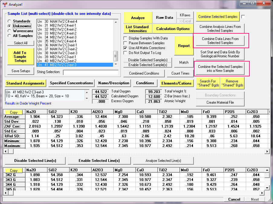

Remember you can also combine points from multiple samples in PFE (up to 500 points) using these buttons:

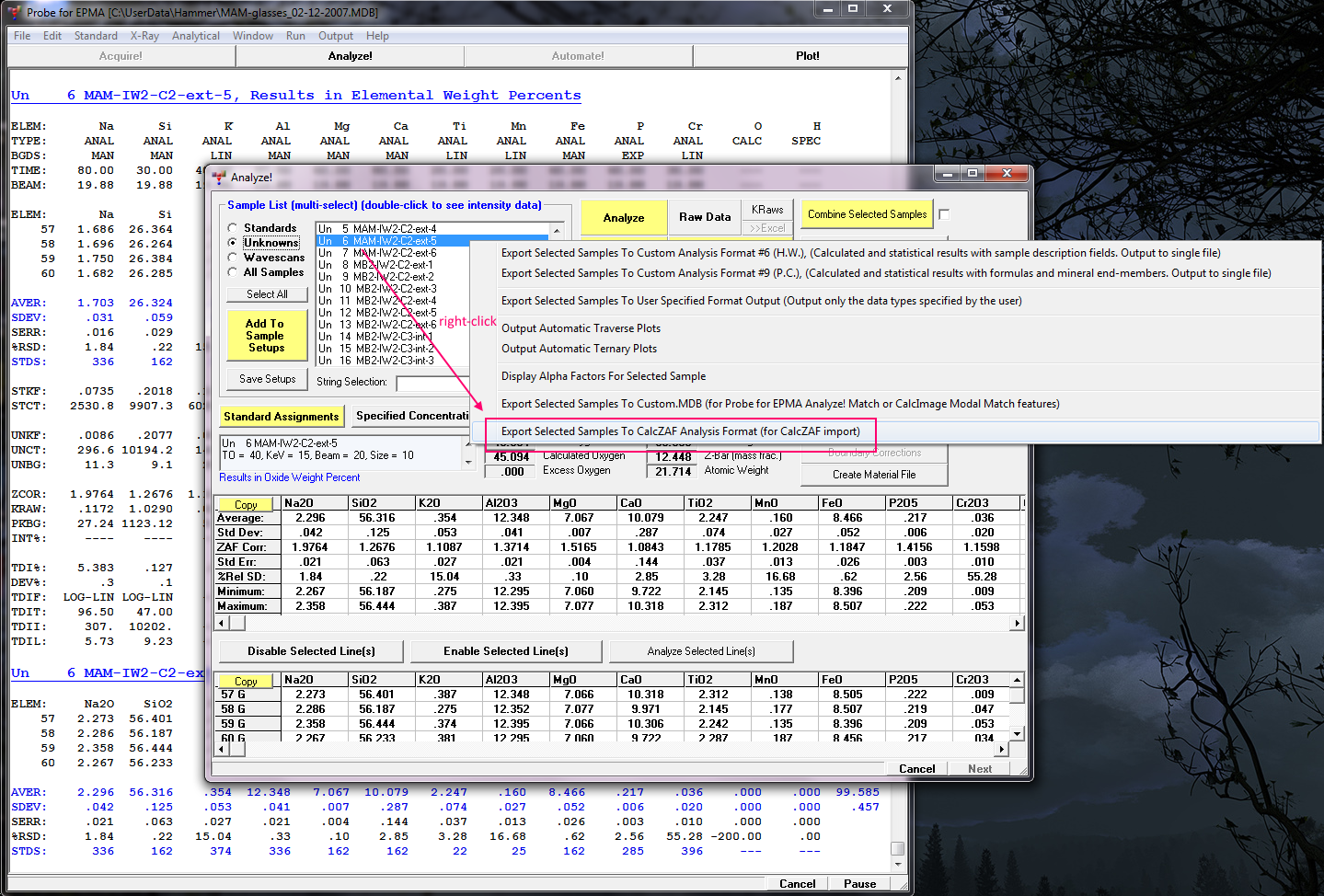

As for CalcZAF, if you really want to re-process your PFE data in CalcZAF (why?), you can certainly export all the data using a right click in the Analyze! window or from the Output menu, but after importing your data into CalcZAF, it only displays one point at a time. Then use the Load Next Dataset From Input File, to see the next point.

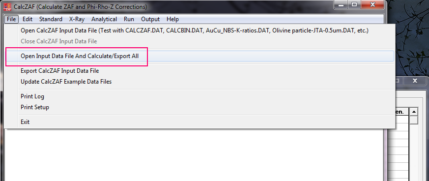

To have CalcZAF re-calculate all the points in the imported DAT file, simply use this menu to open the .DAT file:
But I think you're better off just using Probe for EPMA.

To have CalcZAF re-calculate *all* the points in the imported DAT file, simply use this menu to open the .DAT file:

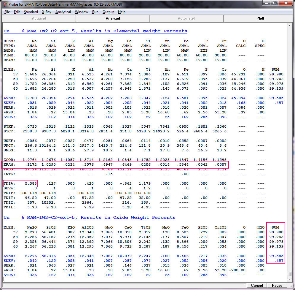

For example, here is a glass analysis with a relatively small TDI effect of around 5% relative on Na Ka:
When analyzed in PFE one gets a reasonable analysis and the TDI effects are corrected for as highlighted here:

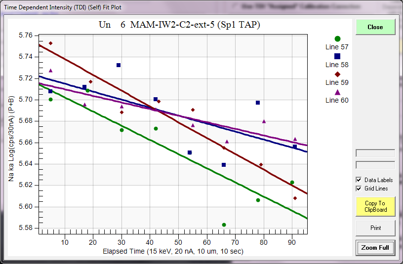

The calculated results from CalcZAF are essentially the same because the raw k-ratios were already corrected for these TDI effects as seen here:
The slight differences in the 4th decimal place are due to the different starting k-ratio values in the iteration convergence.

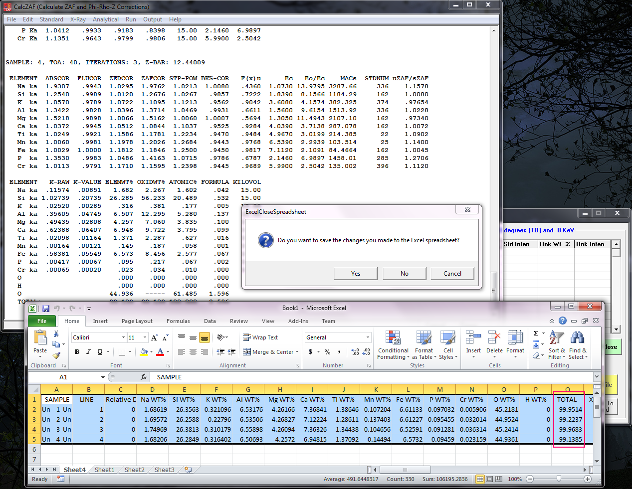

3. Appears "results" without results - attach file scr3. There is no notice about save something in Excel.
Where I made a mistake?

1. I opened the file which created as John said (right click on sample in Analyse of PFE) - attach file scr1.
You used the CalcZAF File | Open Input File and Calculate/Export All menu to open the output file from Probe for EPMA?
