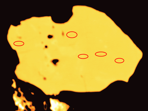

I occasionally notice random pixels in the BSE image on my SX100 that seem to cause horizontal "streaks" as seen here:
Does anyone know what causes this and how to prevent this from happening?
It does *not* seem to be a function of contrast or brightness and might be worse at higher beam voltages (i.e., 20 keV rather than 10 keV), but I haven't done any real testing.

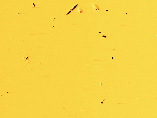

Ok, here's more data. It does appear to be related to the electron beam energy. Here's a BSE image at 20 keV:

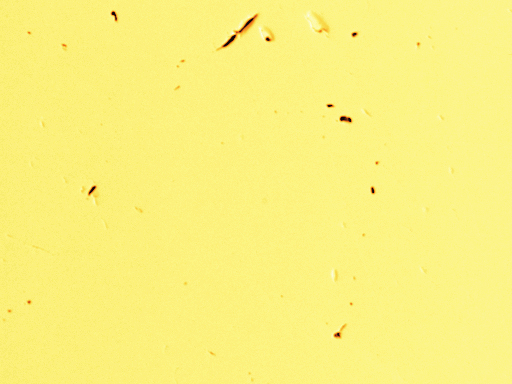

Now here's one at 16 keV:

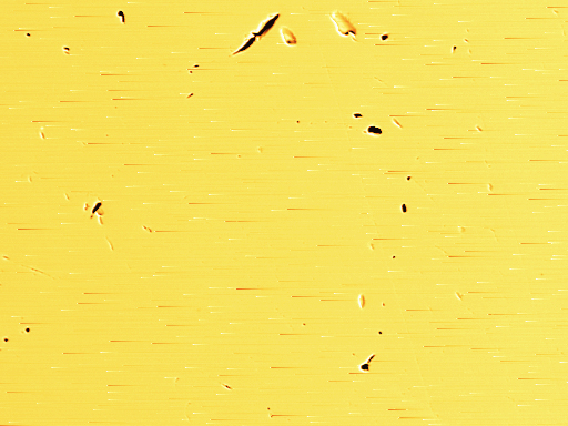

And here's one at 10 keV:
All at the same beam current (50 nA).
Any suggestions on what we can do to fix this?

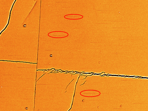

Update on the BSE streaking in the above images.
We see these single pixel streaks in both BSE and SE images and we see them in the BSE image even if the SE detector is off.
We're cleaning the whenelt in case that is somehow causing this at higher gun voltages.
Cleaning the Whenelt *did* help quite a bit.  This is after cleaning and with the gain turned up to 800 or so.
We'll try replacing the filament.
