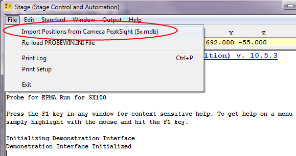

Hi Ravi,
Perhaps I should have asked this from the beginning!
If you are simply trying to import PeakSight stage positions for your standards, you should just use the menu in the Stage.exe application as seen here:
Ravi
No, standards.mdb was already imported and has been around a long time. Its just I needed to import unknown sample positions.
Quote from: Ravi on November 27, 2014, 07:26:47 AM
Ok. But remember, use Standard.exe to to import standard compositions from sx.mdb and Stage.exe to import standard positions from sx.mdb. I separate the standard compositions from the standard positions for specific reasons in Probe for EPMA.
