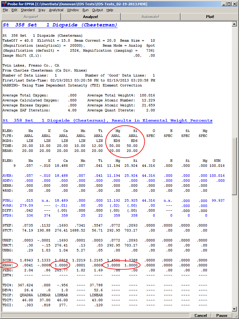

I fixed a minor rounding error in the calculation of net intensities from the Thermo EDS spectra which caused the k-raws for the assigned standard to not be exactly 1.000.  This was pointed out by Ken Severin, thanks!
All fixed in v. 10.2.2 of PFE.

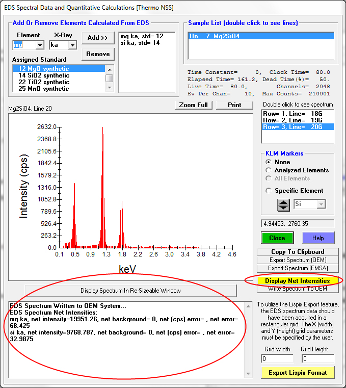

Just discovered a subtle and hard to find problem that can occur if one is using the RealVNC server for remote access. Typically when VNC installs as a server or even when using the VNC Viewer client, port 5800 is utilized for the communication.
However, as you probably all know, the TE Portal interface that Thermo provides for integrated EDS/WDS also uses port 5800, so when one tries to use the Thermo API, it fails with an
Error 5: Socket Time Out Error
So, finally I realized this and changed the port that VNC uses from 5800 to 5900 (note there are two fields that must be changed, one for VNC communication and the other for Java communication), it all started working fine.
This was on an off-line computer used for re-processing data, but Probe for EPMA still needs to communicate with the Thermo NSS software for obtaining the net intensities.
When this is all working one now gets the proper net intensities as expected:

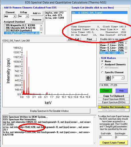

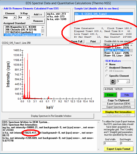

Here is a Net Intensity issue that I do not understand. I'm using a Thermo NSS system.
To make for a more efficient spectrometer configuration, I thought I would use EDS for some majors in an analysis setup.
When I looked at the calculated compositions for some unknowns, I was surprised by some erratic totals, so I thought I'd look at the EDS elements.
Here are two EDS spectra from a line scan:
Note that although the spectra and the acquisition parameters are very similar, the net intensities for Si are very different. Mg and Fe look OK.

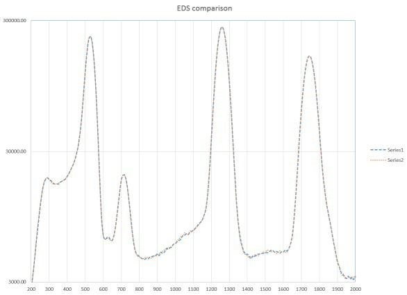

To confirm the similarity of the spectra I exported the spectra and plotted the area around the Si peak (log intensity vs eV). I'd say they look pretty similar:
I have to admit that the processing of the EDS spectra is something of a 'black box' to me. So, any suggestion about what I could be doing wrong?

Indeed, I discovered that in this case the variation in Si ka Net Intensity was due to the misidentification of Ta M-lines. After applying a mask for all but the elements that were present, the Net Intensity returned for Si for the two spectra mentioned in the original post were more reasonable:
Line = 258
EDS Spectrum Net Intensities:
mg ka, net intensity=10858.76, net background= 0, net (cps) error= , net error= 37.12778
si ka, net intensity=7633.333, net background= 0, net (cps) error= , net error= 25.07222
fe ka, net intensity=1213.2, net background= 0, net (cps) error= , net error= 5.661111
Line= 260
EDS Spectrum Written to OEM System...
mg ka, net intensity=10861.81, net background= 0, net (cps) error= , net error= 37.13889
si ka, net intensity=7642.511, net background= 0, net (cps) error= , net error= 25.1
fe ka, net intensity=1216.611, net background= 0, net (cps) error= , net error= 5.666667
That's 5623cps with Ta, 7633cps without. I am a little surprised by the magnitude of the error created by an apparent 0.5wt% Ta?
