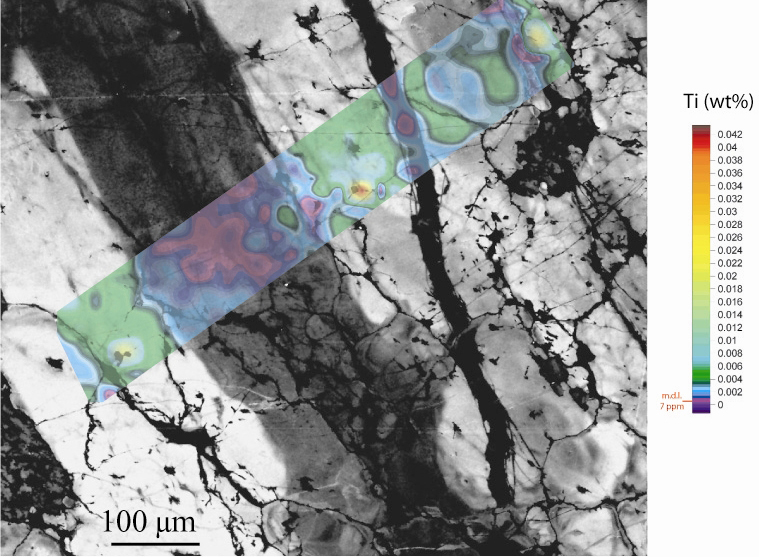

Generally these "point maps" are of fairly low spatial resolution (a limited number of total pixels) due to the time consuming nature of the method with its attendant stage and spectrometer overhead, but the sensitivity is only limited by one's time and/or money!  Seen here is a Ti map in quartz where two spectrometer were tuned to Ti and counted with on-peak backgrounds for 300 sec and 150 sec on each off-peak (15 keV, 200 nA, 20 um):
Because of they are spatially sparse, the 395 data points were fitted and smoothed using Golden Software's Surfer software which most users of Probe Software already have for presentation. The fact that detection limits of 6 - 7 PPm were obtained is testimony to the efficacy of the technique though the data acquisition took the better part of a several days.
This data was presented in the Am. Min. paper attached at the end of this post.

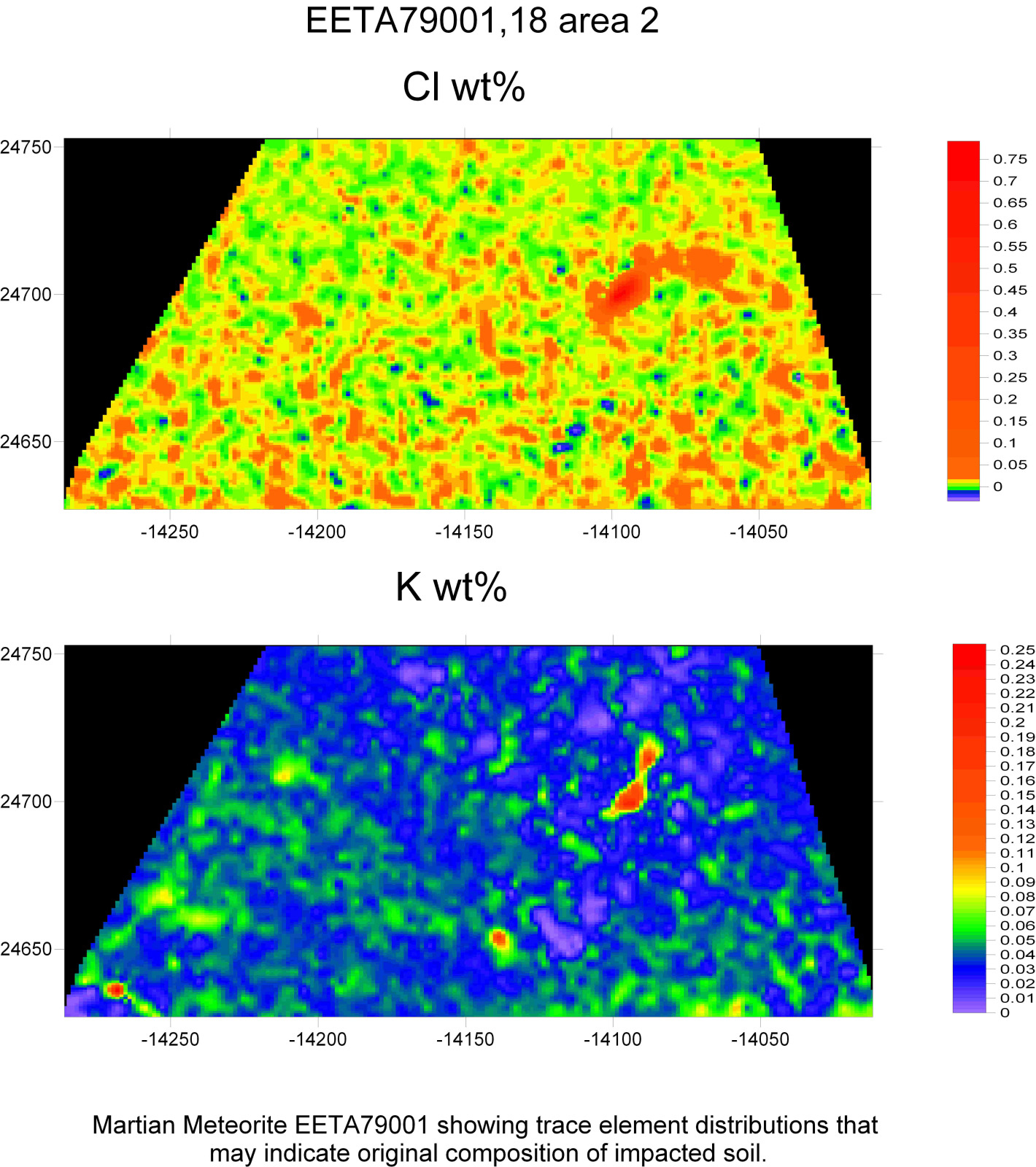

Higher spatial resolution can also be achieved with this technique by increasing the number of points and reducing the counting time to a minimum, though still around 1 sec per pixel as shown here in these scans of glass in a Martian meteorite from NASA provided by Christian Schrader:

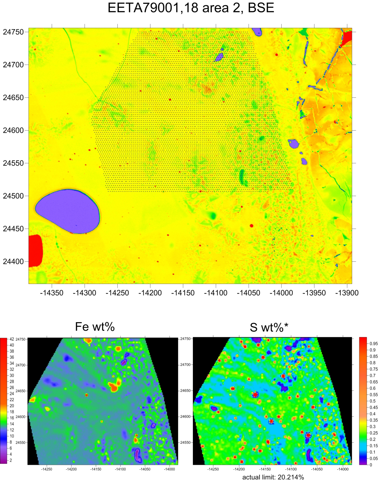

And these point analysis maps can be overlain on BSE images for reference as seen here:

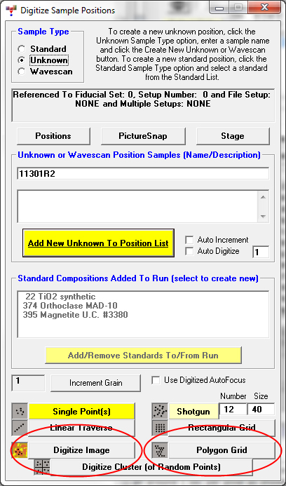

Note that one can specify the digitized points to acquire using either the Digitize Image dialog or the Polygon grid dialog as shown here:
Generally the Digitize Image feature works best with small areas that can be captured in a single BSE image, while the Polygon Grid feature works best with larger areas that may require a Z tilt correction.
