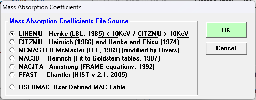

The MAC tables in Probe for EPMA (and CalcZAF) are shown here:
The MAC30 tables are the values from Pouchou so far as I know, but there are updated values I obtained some time ago for boron through fluorine emitters which are attached. I can't remember who gave me this file, it could have been Philip Poeml.
These values appear to be somewhat different from the MAC30 values, so you can edit the MAC30 table (MAC30.DAT) using CalcZAF if you want from the X-Ray | Edit MAC Table menu.
But the PAP_MAC.txt file only goes up to F, not Mg.
See attached.
