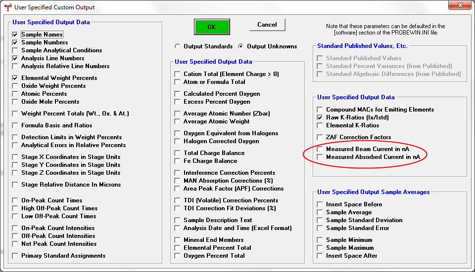

Good idea. I will add absorbed current to the TDI output.
The latest beta version of PFE (v. 10.6.8) now includes the output option for absorbed current as seen here:

The beam and absorbed current are now in the TDI output in the latest 10.6.8 beta which you can download in the morning.
