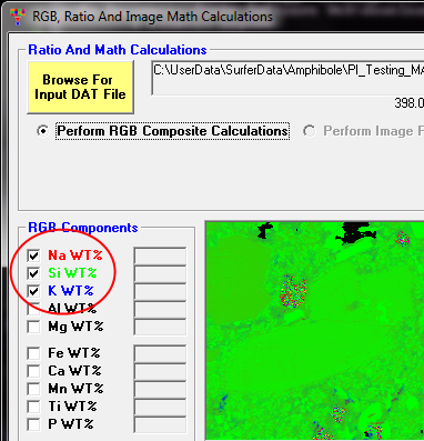

I've just uploaded a first cut of the new RGB processing window in CalcImage. Calculations can be performed on any of the output data types (elemental quant, atomic, oxide, etc etc.).
One can rotate through the elements or rotate the RGB colors for the selected elements as seen here:

So, what does that do in RGB space...?  Well here's normal elemental quant wt% for an amphibole bearing basalt:
We can see that because Si is a high concentration in many pixels, and because it is assigned green in RGB space, most of the image shows as green without a lot of differentiation. Now, here is the *same* data but expressed as Log wt%:
