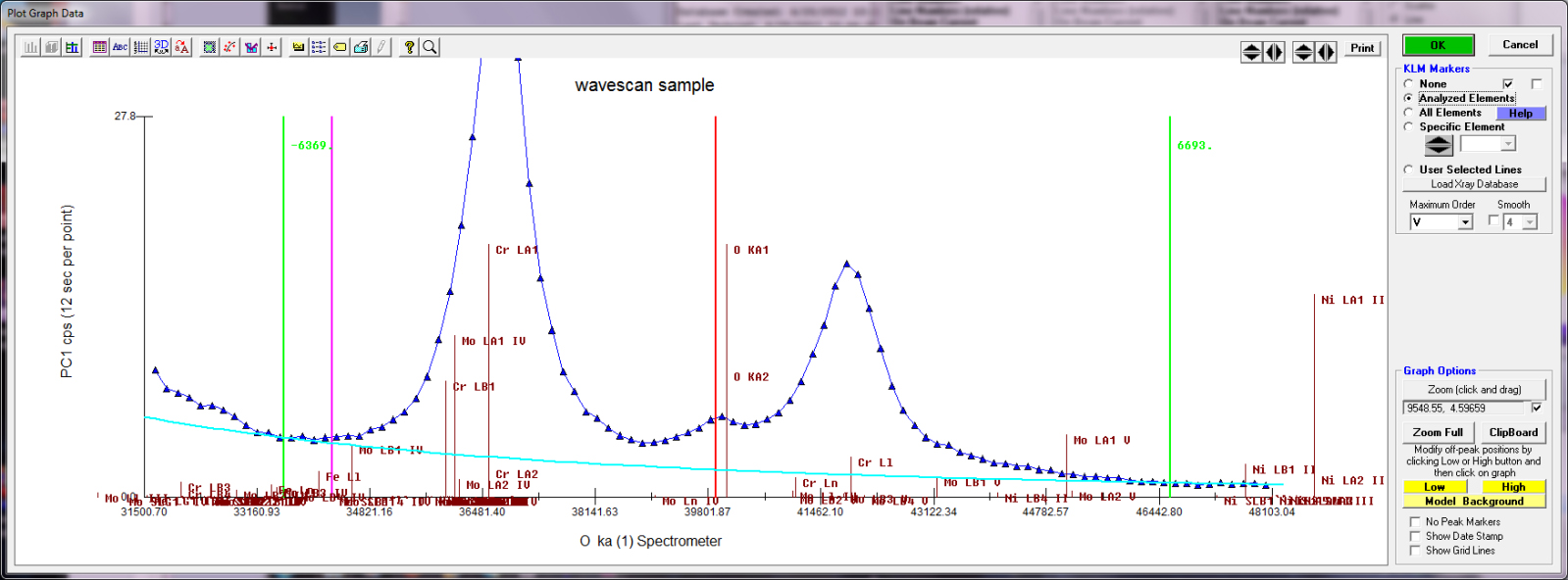

Hi everyone,
Thank you for the feedback. I've ran a wavescan on Ti on an unknown (attached).
I did not expect any off-peak interferences, but I wanted to find out what the backgrounds looked like.
As you can see from your very nice plots, the exponential background fit works significantly better. Don't forget, your wavescan is much lower precision than your point analyses, so if you're seeing problem with a linear fit in the wavescan, it's definitely going to be a problem with your point analyses!
Did using an exponential fit help? Remember you can "adjust" the exponent of the exponential fit here for a better fit to the wavescan- when you only have two points to fit, what else can you do?   :(
Of course, that is exactly why we developed the "multi-point" off-peak background method. The cool thing about the multi-point background (developed by Mike Jercinovic, Mike Williams, Julien Allaz and I), is that it not only will provide the most rigorous fit for the actual background shape (because it uses more than two points, usually 4 on each side of the peak, so curvature is measured rather than assumed), but with the same precision as your unknown!
In other words, the multi-point background is sorta of like combining your wavescan *and* analysis acquisitions together!  Here is more info on the multi-point background method:
http://smf.probesoftware.com/index.php?topic=56.msg218#msg218
mderrico
Yes, I have concluded that for spinels, which have such low Ti, that I should use the exponential fit. For all else, I will still use linear background fits because the peaks are higher and the backgrounds are obvious.
Thank you for the tip on using the exponent of the exponential fit to see what happens to the final values.
