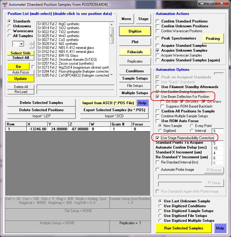

The latest version of PFE (11.2.2) now contains a stage reproducibility correction feature when combined with the Use Beam Deflection For Position option as seen here:
The idea being that when one has utilized the Digitize Image feature from the Automate! | Digitize window to digitize point acquisitions in more than one field of view, the stage needs to drive to each field of view before applying the beam deflection. Since no EPMA stage is perfectly reproducible, this feature drives the stage to each image center, retrieves the reference image utilized for the point digitization, acquires a new image based on the same imaging parameters as before, calculates the apparent image shift relative to the reference image and applies a correction using the image shift method. Then it utilizes beam deflection for each point digitized in that field of view.

Attached below are two images from my SX100 on an MgO standard so I could see where the beam was deflected to.  And indeed the stage reproducibility correction feature worked excellently, placing the beam spot exactly where it was digitized on the reference image.
