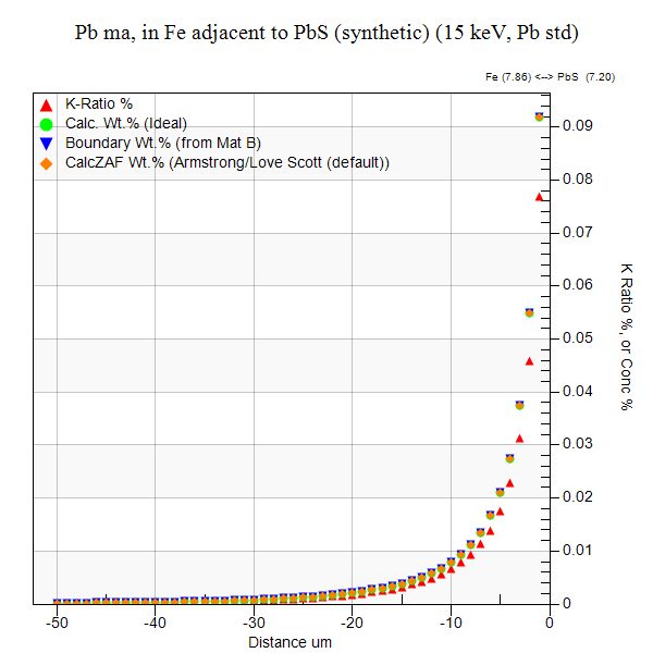

For example, I don't think you mentioned the composition of the inclusions, but if you are, for example, looking for Pb and some of the inclusion grains are a PbS phase, then secondary fluorescence effects should be considered (see attachment below).

Well since the blebs contain significant concentrations of the trace elements you are looking for, I would be very concerned about secondary fluorescence effects!  You might want to try the Penepma GUI in Standard. There are two GUIs.  The first assumes a vertical boundary and can provide results in seconds using previously calculated PAR files. It is described here:
http://smf.probesoftware.com/index.php?topic=58.0
The 2nd GUI calculates everything from scratch using any geometry but takes many hours, and is described here:
http://smf.probesoftware.com/index.php?topic=59.0
Since I forgot to attach the SF calculation image in the above post, here it is now:
This was calculated in the Standard app which comes with CalcZAF in just a few seconds.
