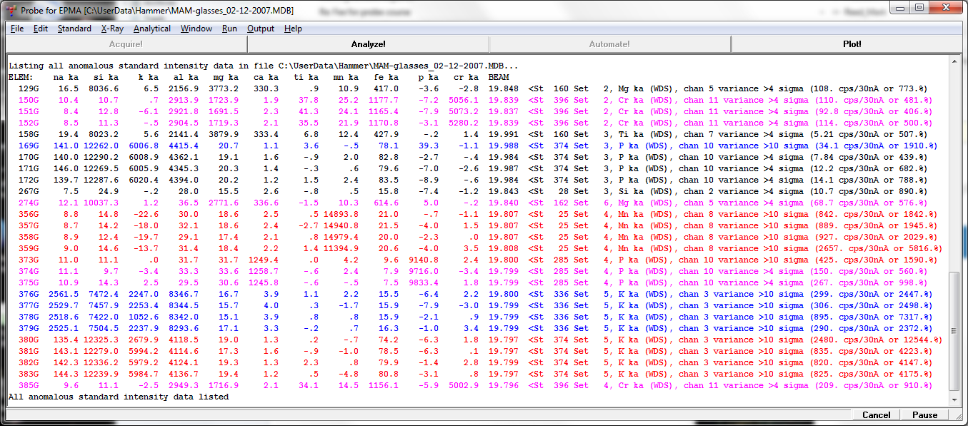

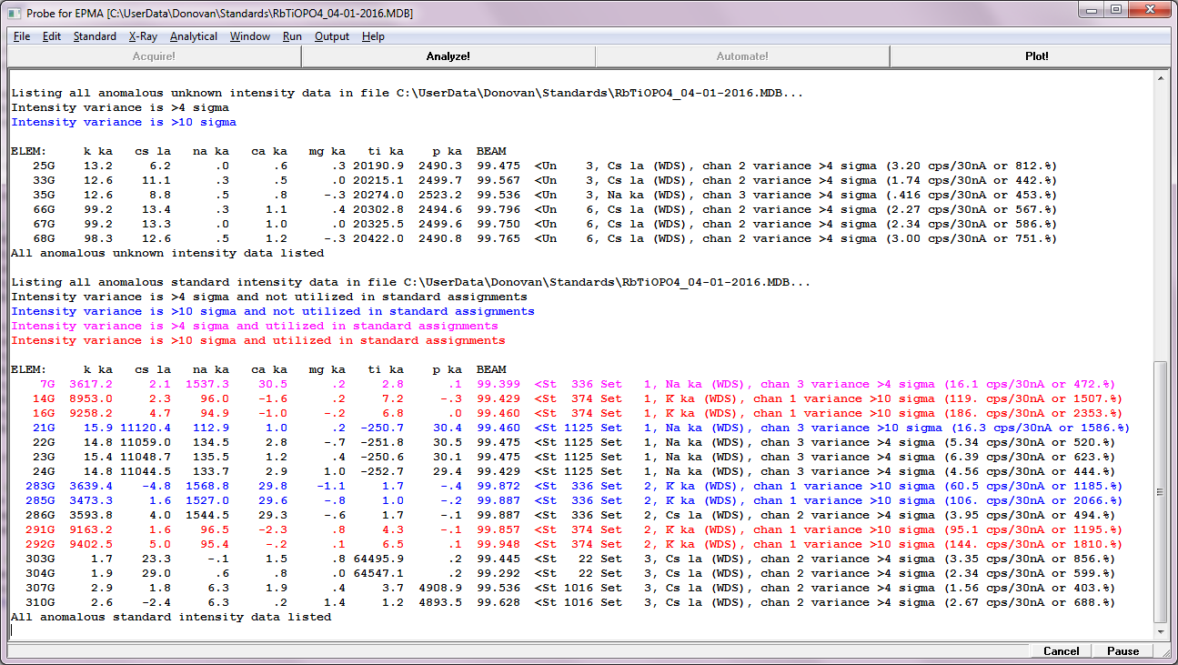

Here is an example of the output for anomalous standard intensities:
We decided to display the color coding key in the log window when listing anomalous intensities from the Run | List Anomalous Intensity Data for Standards and Unknowns menu as seen here:
Note the unknown intensities listed at the top, and the standard intensities listed below. The idea is that when listing anomalous standard intensities, one would want to be alerted to anomalous intensities which are being utilized as ones primary standard (text in magenta or red).
