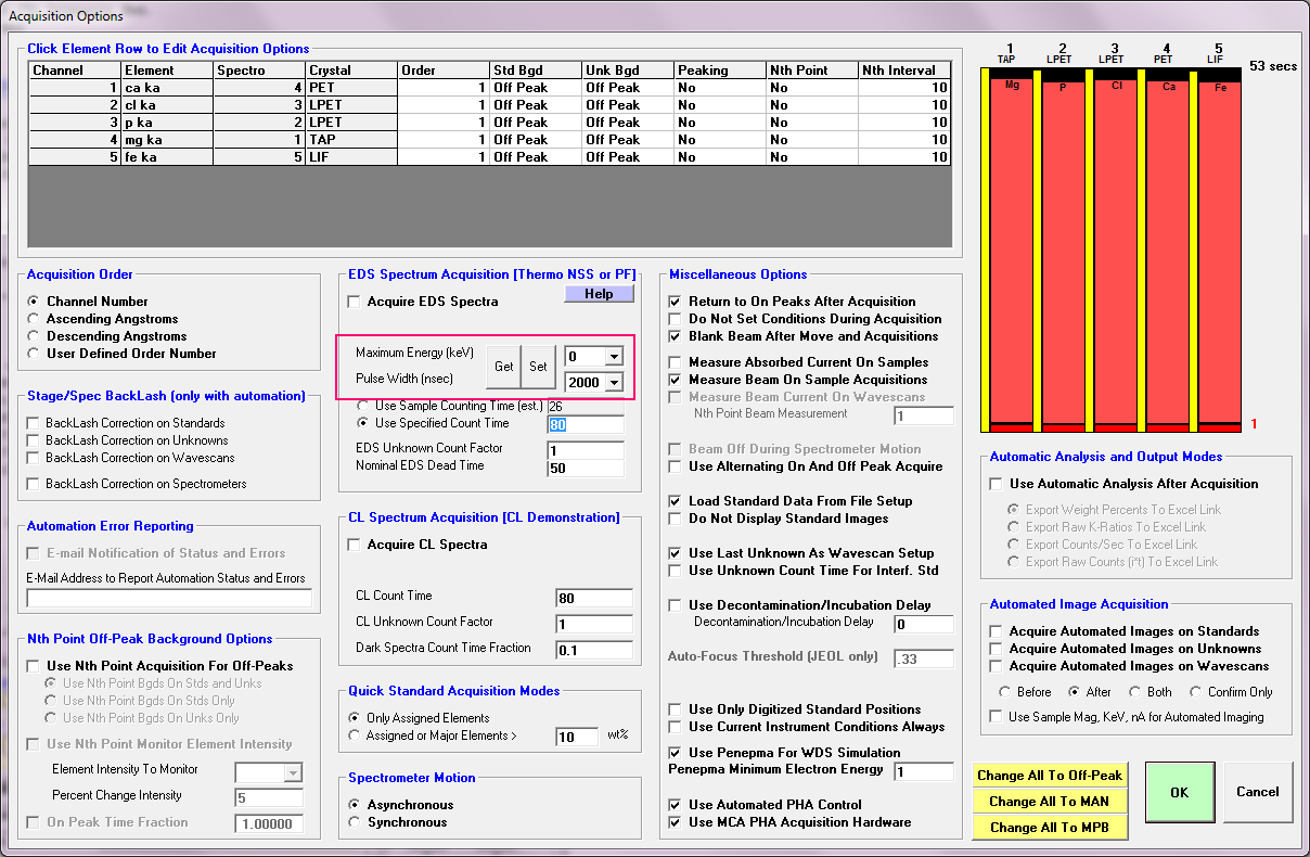

Probe for EPMA now supports the Thermo maximum energy (x-axis) and pulse processing width (in nano-seconds) interface from the Acquire! | Acquisition Options dialog as seen here:
To enable, simply change the following keyword in the [hardware] section of your Probewin.ini file as seen here:
[hardware]
EDSMaxEnergyThroughputPresent=1

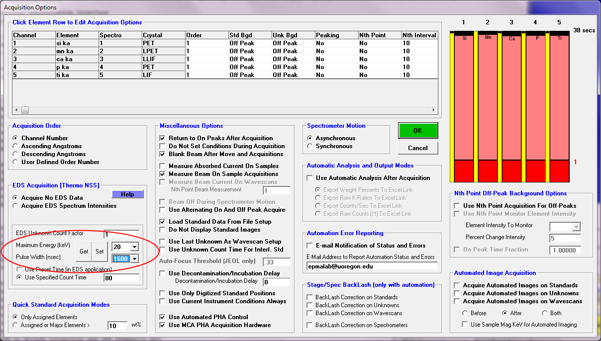

Just an update to the Thermo Max Energy and Process Time parameters that are found in the Probe for EPMA Acquisition Options dialog here:
First it should be noted that the max energy selections are 5 to 80 keV (5, 10, 20, 40, and 80 keV) in Thermo NSS, but the new Thermo Pathfinder software allows a value of zero, which indicates automatic selection of the appropriate maximum energy scale in the X axis.
If you started with Thermo NSS and then upgraded to Pathfinder, you might not see the zero value selection for max energy in the acquisition options. In this case open your Probewin.ini file in any text editor (e.g., NotePad) and find these keywords in the [hardware] section and edit them as required:
