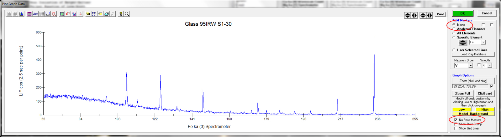

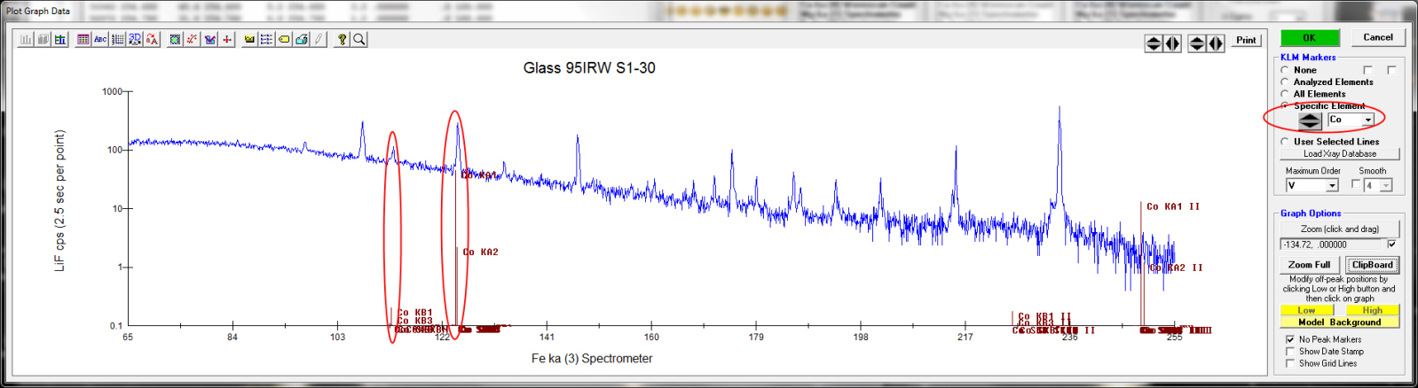

Note that no KLM markers are displayed and that the on/hi/lo off-peak positions (for Fe) are turned off in the display. We then start by attempting to find the identify of the highest intensity peaks in the spectrum by selecting the single element option and scrolling through the periodic table looking for matches to our unknown spectra as seen here:

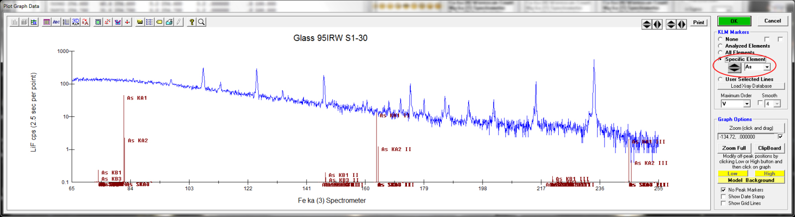

I generally use the log-linear option from the Plot! window and start with the highest energy element that is possible for this energy range, such as As or Se.

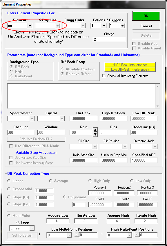

Scrolling downwards in atomic number we see a possible match for Cu and after exiting the graph window we can add the element to our element list in the Elements/Cations dialog.

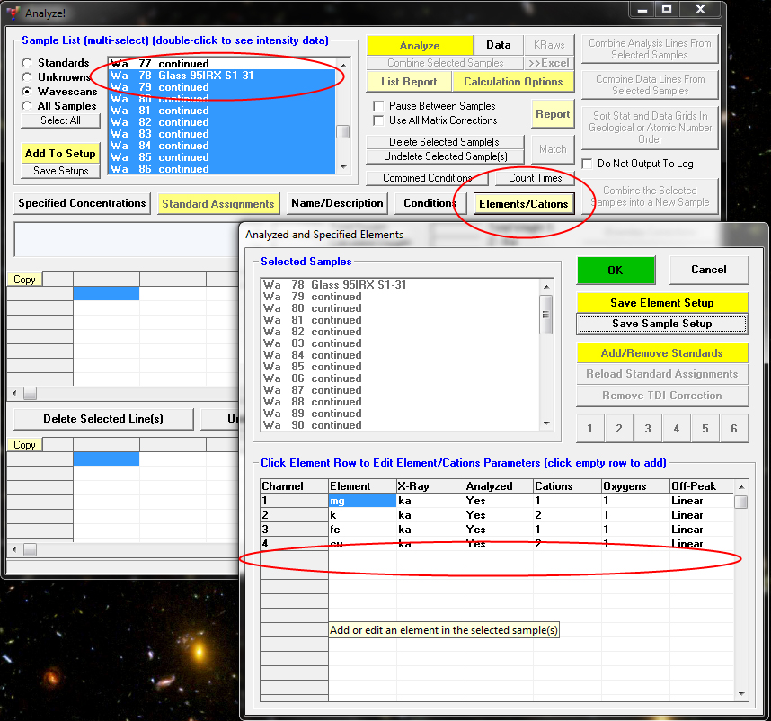

Be sure to select the wavescan sample when adding unanalyzed elements (with no x-ray line specified) so the program automatically displays the analyzed *and* unanalyzed KLM markers in the graph.
However, since Cu is already one of the elements we used to tune our spectrometers, we can skip this step, though since Co is the next element we get a possible identification for (see below), we add it as an UNanalyzed element in the Elements/Cations dialog.

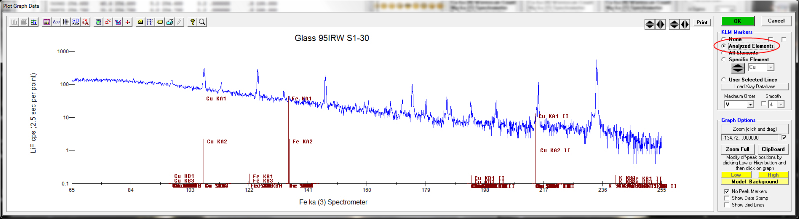

The point is that by alternately selecting the Specific Element and Analyzed Elements options we can see if the peak(s) in question have already been identified as seen here:
Though it would appear that Fe is not present at this precision level, we continue scrolling through the atomic numbers as we make a possible identification of Co, since both the alpha and beta lines appear to be present and they do not match peaks already tentatively identified:

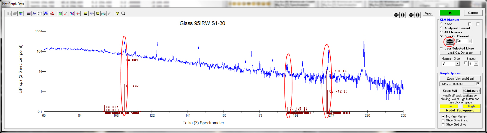

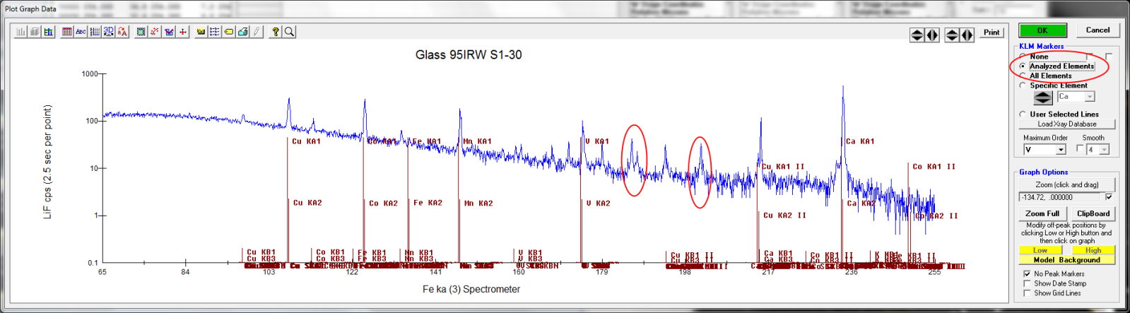

After further scrolling we note the possible presence of Mn, V and Ca and when we click the Analyzed Elements KLM option (which automatically includes the UNanalyzed elements also), we see that most of the lines are identified by two or more KL markers.
Except the two circled above!   So what would be your next step?   :P
