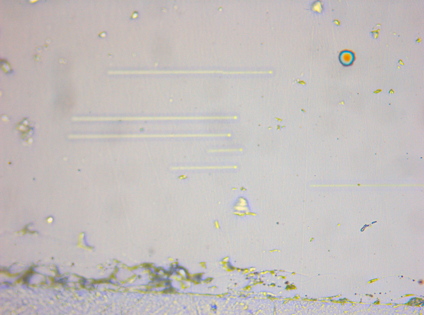

In fact, one advantage of using SiO2 glass is that it is actually *less* sensitive to the electron beam than SiO2 crystal. Here is a reflected light image of a scanned electron beam on SiO2 crystal:
and here is SiO2 glass under the same scan conditions:
But maybe this is not a good thing in that the SiO2 glass might no longer be a similar enough matrix for calibration of the "blank" concentration?
I suppose we'll need to do some high precision measurements and compare traces in SiO2 glass and SiO2 crystal...

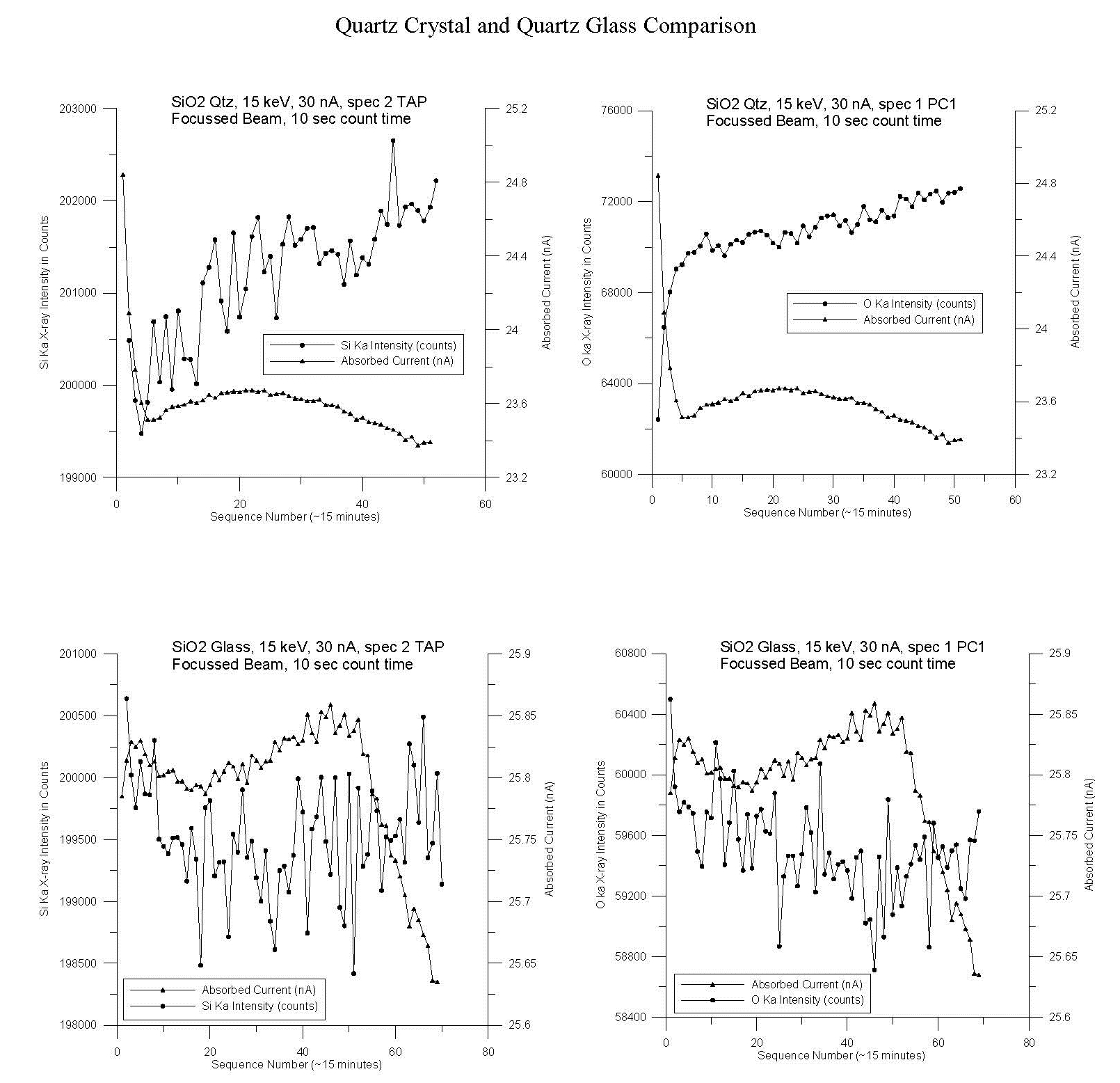

Here's a plot I made a while ago comparing quartz glass and crystal for Si Ka and O ka.  Note the absorbed current changes.
Note that over time the oxygen intensity goes up in the crystal, while it goes down in the glass, though more slowly. I have no idea what this means... but thank goodness for the TDI correction.
