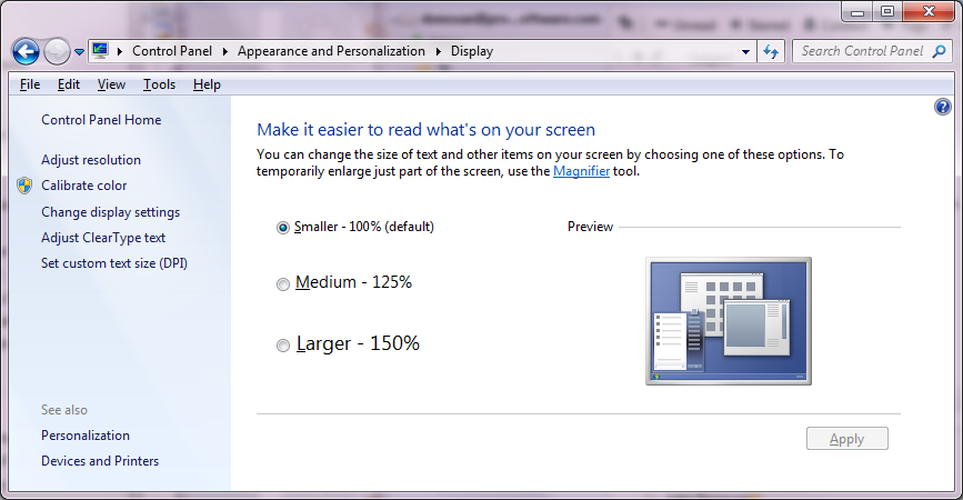

My colleague Julie Chouinard is teaching the EPMA course this fall and some students found they cannot see the full extent of certain windows in our EPMA apps on their laptop computers.
We found that some students had set the screen DPI on their laptops to 125% or even 150% (I don't know why, as their eyes are a lot younger than mine!).
Anyway, we found that if they set the screen DPI back to 100% (right click the desktop) the windows all fit fine:

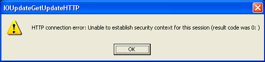

On a related note, I've recently noticed that the default update link from the Help menu in CalcZAF, Probe for EPMA (and PictureSnapApp), will no longer work under Windows XP.  Instead one gets this message:
This is because the server is now rejecting secure connections from computers running Windows XP (or older).  So what can a user do?  Well in Probe for EPMA there are two other download update options, and I find that the last one (third) still works under Windows XP.
The other solution for those still running Windows XP is to manually download the latest ProbeforEPMA.msi file here:
https://www.probesoftware.com/download/ProbeForEPMA.msi
Contact Probe Software if you need the user login and password for Probe for EPMA update downloads. Note that if you update Probe for EPMA, it will also update CalcZAF (and Standard) automatically).
If you want to update CalcZAF only, no download login or password is necessary using this link:
https://www.probesoftware.com/download/CalcZAF.msi
To manually download the PictureSnapApp update under Windows XP, use this link:
http://probesoftware.com/download/PictureSnapApp.msi
Those running Windows 7, 8 or 10 should have no problems just using the Help | Update menus in CalcZAF, Probe for EPMA or PictureSnapApp.

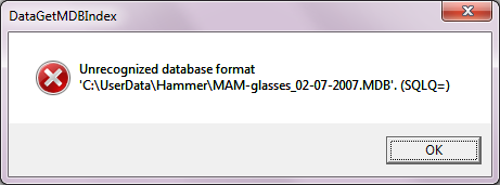

Late last year we happened to open an older MDB Access database which was created using v. 7 of Probe for EPMA (the MDB file was created in 2007). Back in 2007 we were using the Access 97 database format. When the current version of PFE tried to open the database we got the following error:
Even trying to open the database with old versions of PFE didn't help.  When we first saw this, we assumed that we had somehow broken something, but we were wrong!  It was Microsoft!  Here is an explanation:
https://www.devhut.net/2019/01/12/access-97-bug-unrecognized-database-format/
The really weird thing was that these older MDB files could be opened just fine on some computers, but on other computers (same MDB file, same EXE, same OS), we'd get the "unrecognized database format" error. Anyway, after thrashing around a bit, we tried to modify the msi installer script to add back in some older DAO controls that we had removed when we migrated to Access 2000 a few years later (which did not help).  Then all of a sudden these old databases from 2007 starting working again with Probe for EPMA!
So what happened?  What happened was that on one of the computers with the "unrecognized database format" issue, we got a message that Windows had some updates that needed to be installed.  So we allowed the updates to install, and lo and behold, we could open these old Access 97 MDB files again no problem.   ???
When we looked at the installed updates from Microsoft, there was about 50 different Microsoft Office updates. Apparently one of them fixed this Access database problem which Microsoft had created earlier in a previous update.  As to why some computers never saw the issue, but others did- we have no idea.  I guess we live (and die) by Microsoft...
Anyway, now that that particular drama is done with, we wanted to let you all know that we did find a work around that fixed the issue, and although it is no longer necessary, we thought we would mention it. We found that one can open these Access 97 format MDB files in Microsoft Access and convert them to the Access 2000 format. After the conversion, the databases can again be opened with Probe for EPMA even before the Microsoft Office fix had been applied!
The basic procedure is to open the file in Microsoft Access (our version was Office 2010), and when prompted to convert the database, say No (though this may be unnecessary because it seems to convert the file anyway!), then click the File | Save & Publish menu, then select the Microsoft 2000 Database option, then click save As and enter a different file name. That should save the Access 97 database to the Access 2000 format. After this, Probe for EPMA can open the MDB file with no problems.
Anyway, it appears that Microsoft has now fixed their own bug, so we should all be OK for now, though please let us know if you run across anything strange or have other information on this issue.
