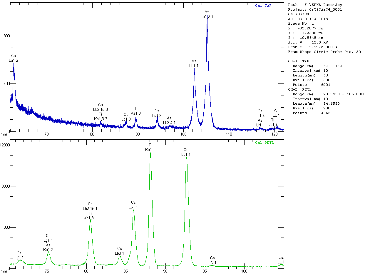

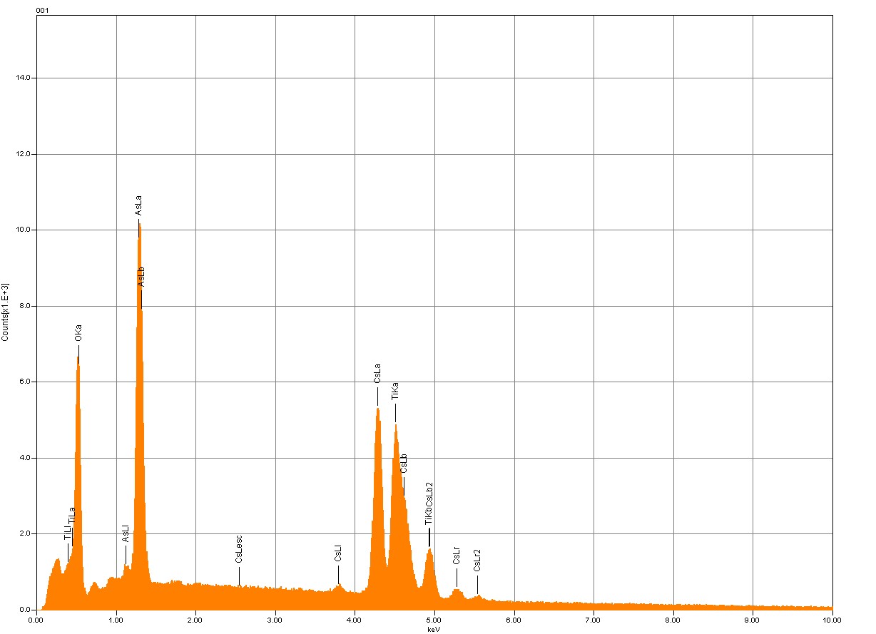

And here are WD and ED spectra.  The tiny peak at ~67 mm on TAP is P Kα.

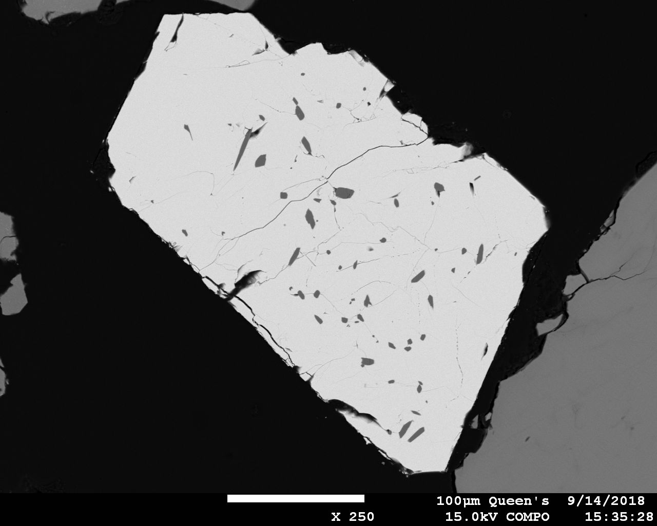

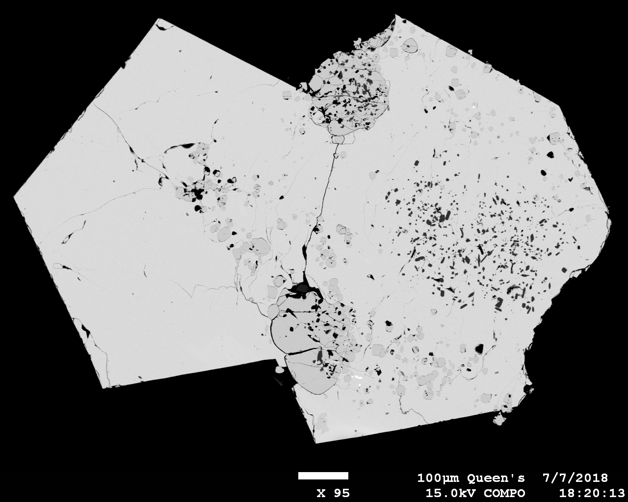

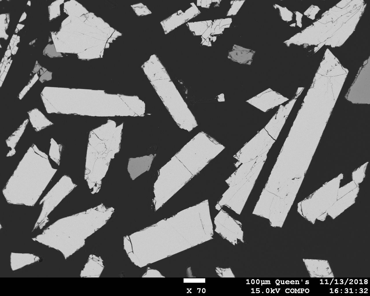

I made a second mount of some of the products from my recent CsTiOAsO4 ("CTA") run after realizing that the CTA was actually quite coarse and not mixed in with the fine-grained fraction.  In fact it was coarse enough (up to ~2 mm) that I was able to pick out individual grains for mounting.  The BSE image below shows two intergrown grains that contain regions rich in inclusions and also regions that are relatively inclusion-free.  The very dark inclusions are TiO2, and the very bright, tiny ones are Pt metal.  The larger, roughly equant inclusions that are just a little darker than the main phase are a Cs-deficient, nonstoichiometric, likely isometric polymorph that probably nucleated during the early 16-hour soak at ~980°C.  These inclusions probably would have been fully resorbed had I been able to control the cooling rate of the furnace a little better.

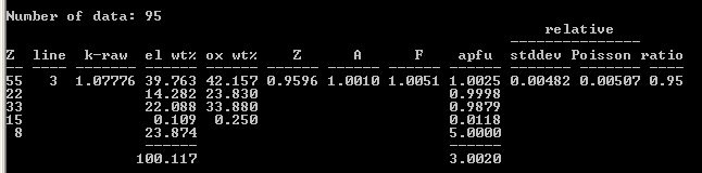

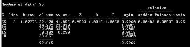

After performing quantitative analyses, I find that most CTA grains in the mount contain ~0.25 wt% P2O5 contributed by Cs phosphate residue that was present in the enclosing alumina crucible; some contain higher concentrations of P2O5, and I've omitted these from the results that I show below.  In order to avoid relatively large matrix corrections for Ti and As using the standards that I have available, I've recalculated the analysis results assuming stoichiometric amounts of TiO2 and As2O5 and assuming substitution of 0.25 wt% P2O5 for As2O5, as is consistent with the original measurements. With this concentration of P2O5, wt% Cs2O should be 42.04 for the stoichiometric compound.  The results are as follows, using my earlier-produced Cs2Co2Al(PO4)3 as a Cs standard:
PAP/MAC30:
Armstrong/FFAST:
Note that the matrix corrections for Cs Lα are small.  In summary, it appears that the material that grew with decreasing temperature does in fact contain a stoichiometric concentration of Cs2O.  In further support of this, it is quite homogeneous in Cs:  the last column ("ratio") in the results above is the Boyd homogeneity index for the 95 measurements that I made.
Note that the CTA crystals should be orthorhombic, but their habit is more suggestive of the isometric system.  The crystals are too thick and contain too many inclusions to get a good sense of whether they are isotropic, and I don't have enough material for powder XRD.
This sure looks like a promising material, and I should be able to grow larger and more inclusion-free crystals once I improve my synthesis setup.

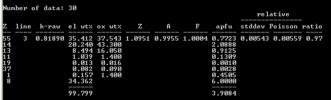

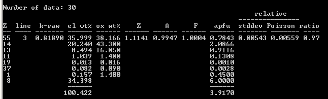

I've analyzed my pollucite standard using my recently synthesized CsTiOAsO4 as a Cs standard and assuming a fixed matrix composition aside from Cs2O.  These are the results of 30 analyses:
PAP/MAC30:
Armstrong/FFAST:

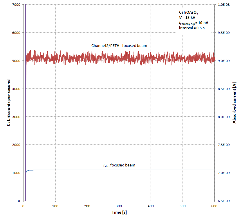

Note that the source of the difference in results between the two models is the atomic number correction.  Use of Cs2Co2Al(PO4)3 instead as the Cs standard results in a smaller atomic number correction.  I found that Cs Lα count rate in this latter material was stable over a period of at least 10 minutes when using a 10 nA beam current and with the beam defocused to 10 microns (but was not stable with a focused beam at 10 nA).  I've just started another run to produce more Cs2Co2Al(PO4)3 (intentionally this time) and hope to report on it within the next 10 days or so.

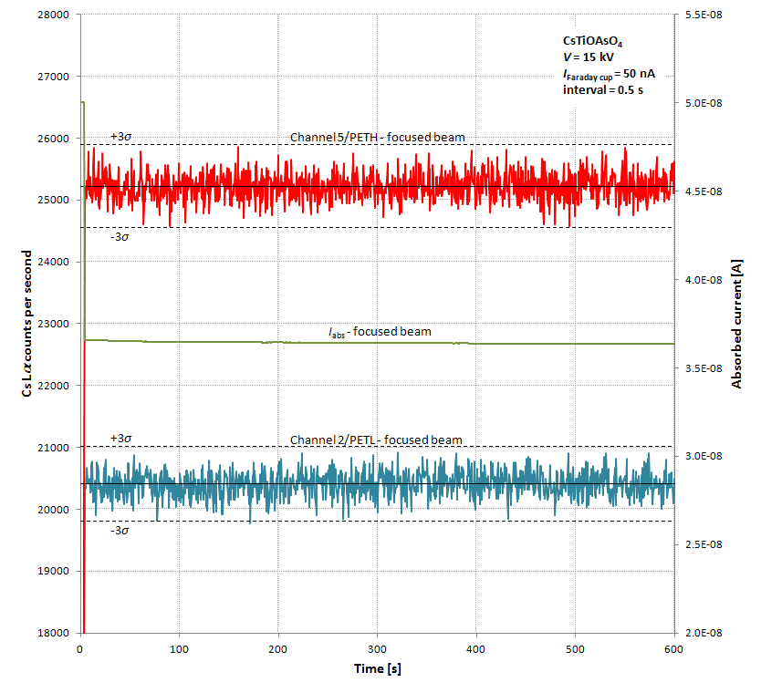

Now this is worth checking out.  Below are the results of a test of exposure of CsTiOAsO4 to a focused 50 nA beam for a period of ten minutes.  I focused the beam as tightly as possible (W filament) and made sure that it was as free of astigmatism as possible.  The absorbed current dropped a little during the test, but Cs Lα count rates remained steady within counting error.  In a secondary electron image collected following the test, I could see only a very faint mark at the point of impact of the beam, and I saw no discoloration or relief at all in reflected light.  This is a pretty robust material!

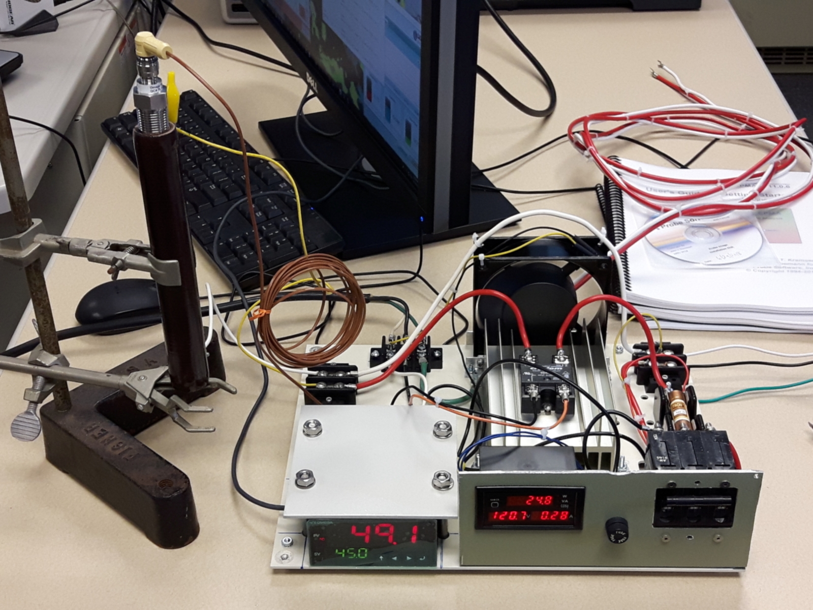

My ramp-and-soak temperature controller assembly using the Omega CN8DPT controller appears to be functioning well in tests using a wirewound power resistor as the "furnace," and so I hope to put it into operation for real at the end of next week.  I'm just waiting for delivery of some wire with teflon and fiberglass ("TGGT") insulation so that I can connect the output directly to the furnace heating elements.  In the photo below, I'm cooling the resistor (attached to the stand on the left) at a controlled rate from 60º to 45ºC.
