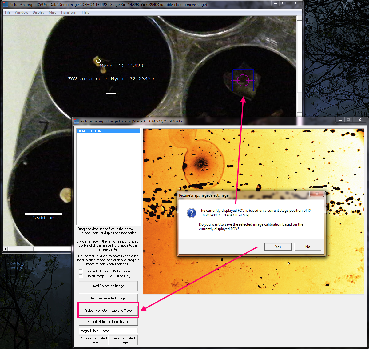

In the Text Input mode the same applies but since in this mode the app doesn't communicate to the hardware, one must double-click the image to set the current position of the sample, and adjust the FOV by using the up/down cursor keys (the blue FOV box is adjusted accordingly and remember to use <shift> up/down to make fine adjustments to the FOV), and then one clicks the Select Remote Image button as seen here:
and then browse to the "remote" image previously acquired using the instrument OEM software.  The software then confirms the stage position and magnification, then when the user clicks Yes, the image is loaded and calibrated based on the current stage position and FOV as seen here:

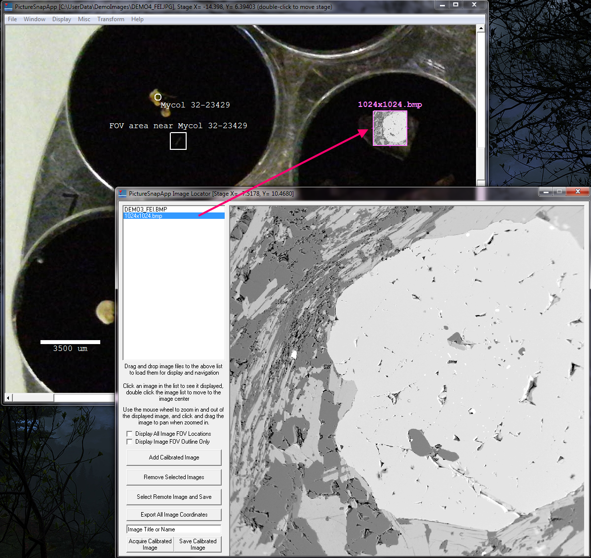

Since PictureSnapApp always knows the instrument stage position and FOV (in the hardware enabled version), it can then simply load the selected image to that position in the "base image" as seen here:

Then simply acquire images using your instrument OEM software and browse to them from PictureSnapApp to create a "visual logbook" of your sample!
