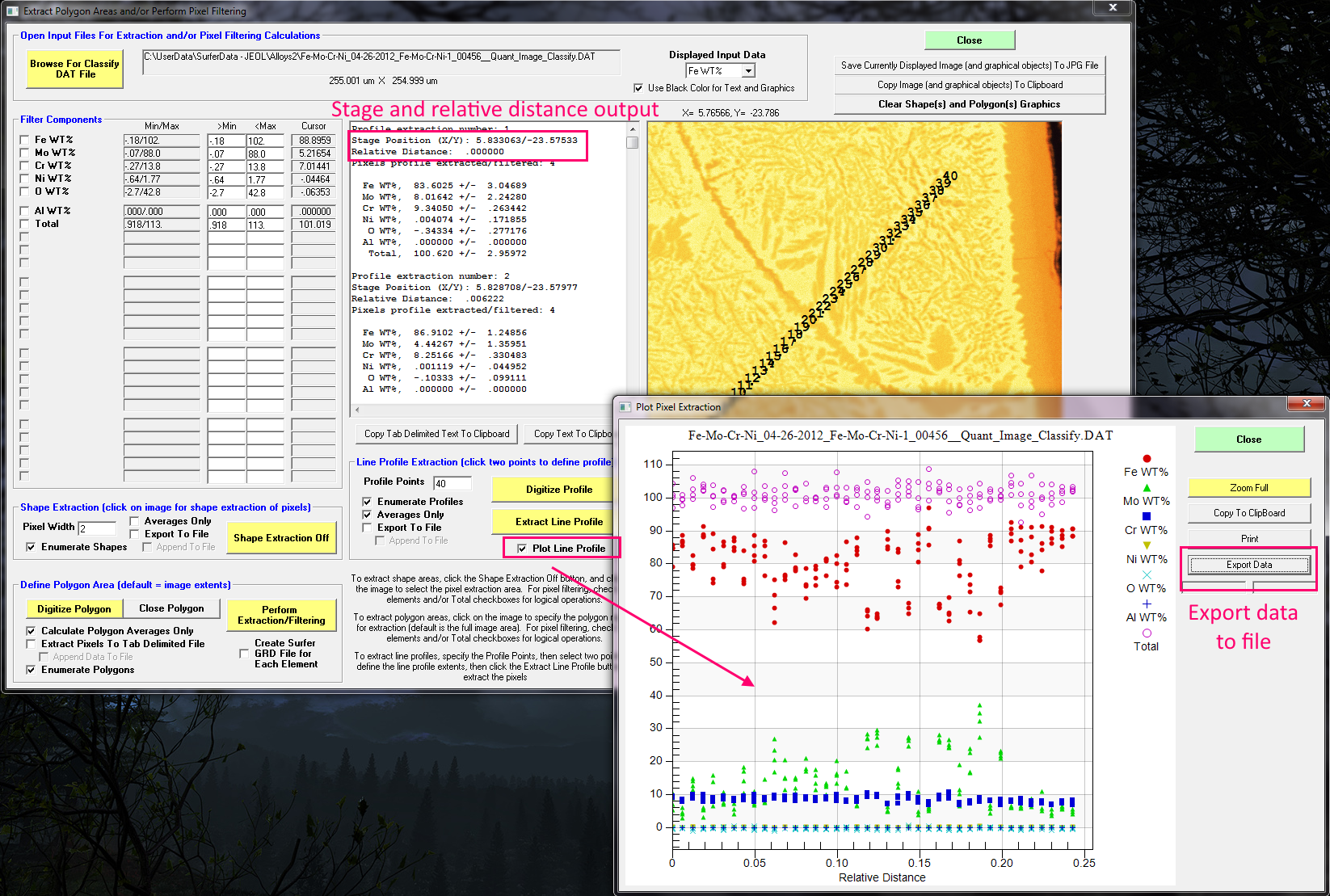

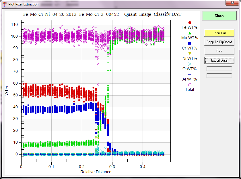

We added code to output the stage positions and relative distance for line profile extractions as seen here:
Here is another plot. Note that one can export the plot data to a file using the Export Data button.
If one looks at the average total (magenta circles), one can see that each pixel has low precision, but the average is quite accurate!
Please update using the Help menu in Probe for EPMA as usual.

I like the graphs you've added in - they are great!
I notice that you don't plot the average of the 10x10 (or whatever) pixel spot but plot each extracted pixel. This gives the large scatter. I think it would be good if you could plot the average value for each extracted spot instead or as an alternative.

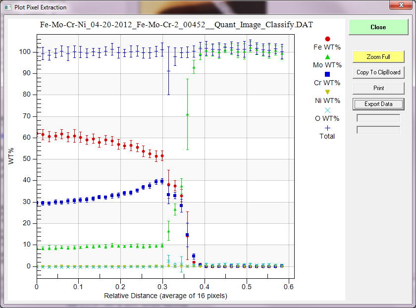

We think we have what you want for extraction of line profile averages from quantitative x-ray maps.
Basically the plot line profile pixel code now checks the "Averages Only" checkbox, and if it is checked, the plot only displays the averages and variances as error bars in the line profile as seen here:

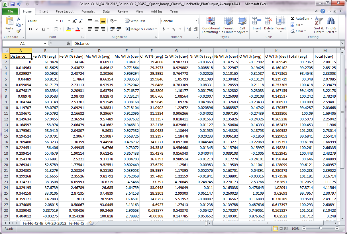

If the checkbox is unchecked you will get all the pixels plotted as before.  Also we modified the Export Data button code to export the averages and variances to a tab delimited ASCII file as seen here when imported into Excel:

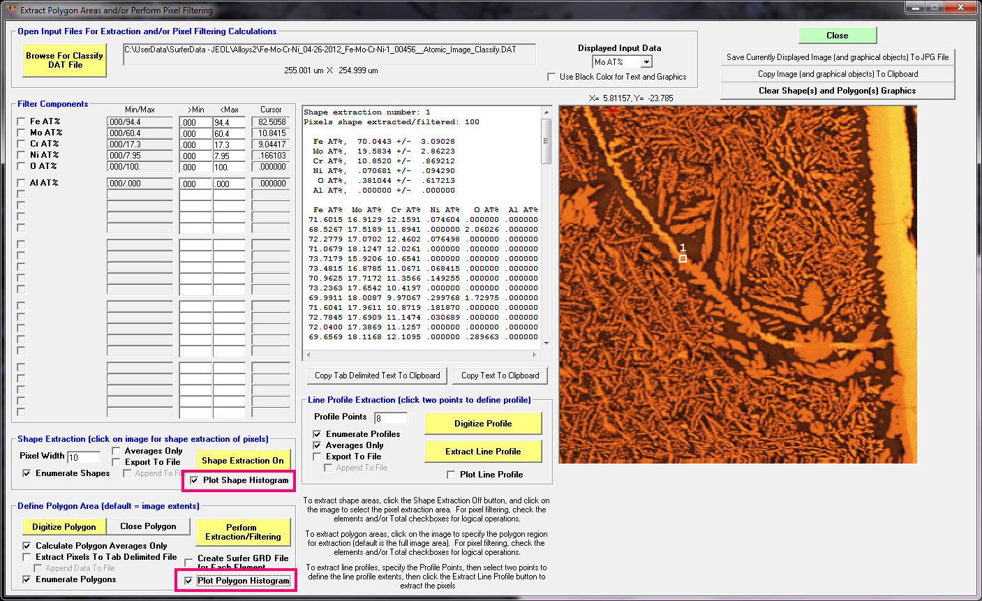

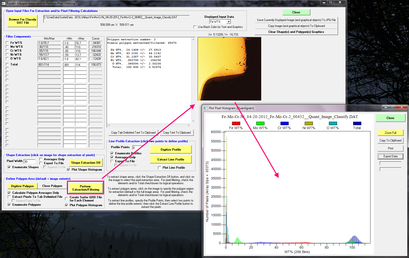

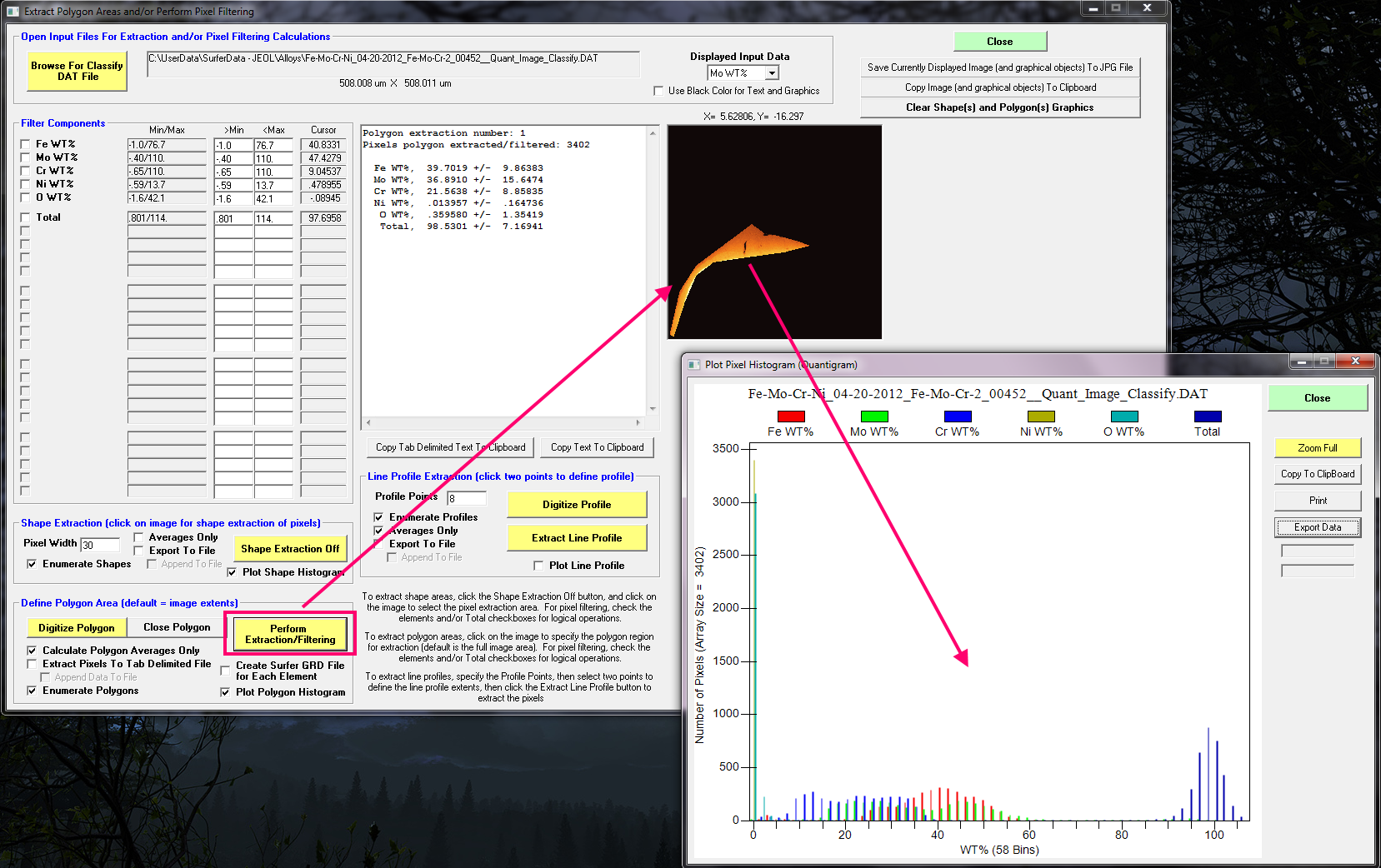

We've released a new pixel extraction plotting feature in v. 12.5.6 of Probe for EPMA in the CalcImage image quantification and analysis application.
This is just an initial effort at this new feature, but we think it could be useful for quantitative image analysis. To utilize this feature simply check one of these two checkboxes for either the shape extraction or polygon extraction methods:
Because the polygon extraction method defaults to the entire image area, simply clicking the Perform Extraction/Filtering button will output the quantitative average and/or pixel results to the text windows or files. And if the Plot Polygon Histogram checkbox is checked, the application will also display a quantitative histogram, or as Ed Vicenzi suggests, a "Quantigram" plot.   We like it.

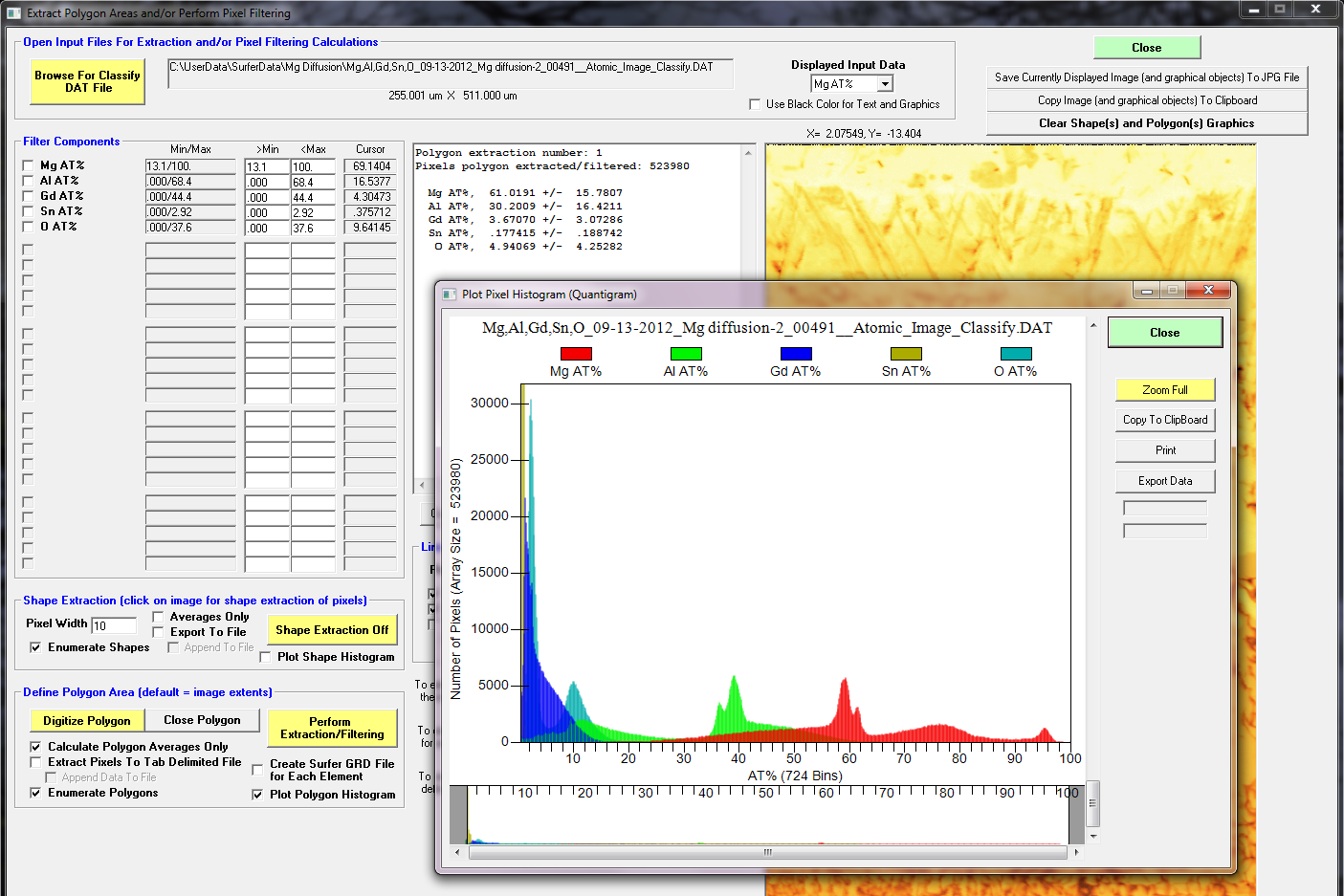

Here is a quantigram of a full quantitative x-ray map of an Fe-Mo-Cr alloy diffusion zone:
And here is a quantigram of a polygon area in this x-ray map:
Finally, here is an example from a multiphase material showing the quantitative distribution of pixels:
Please update your Probe for EPMA and try out this latest pixel extraction plot feature in Calcimage and let us know what you think.

The plotted +/- error bars are one standard deviation, the same as the +/- values printed to the text window.  The exported tab delimited data are also one standard deviation.
So, yes.

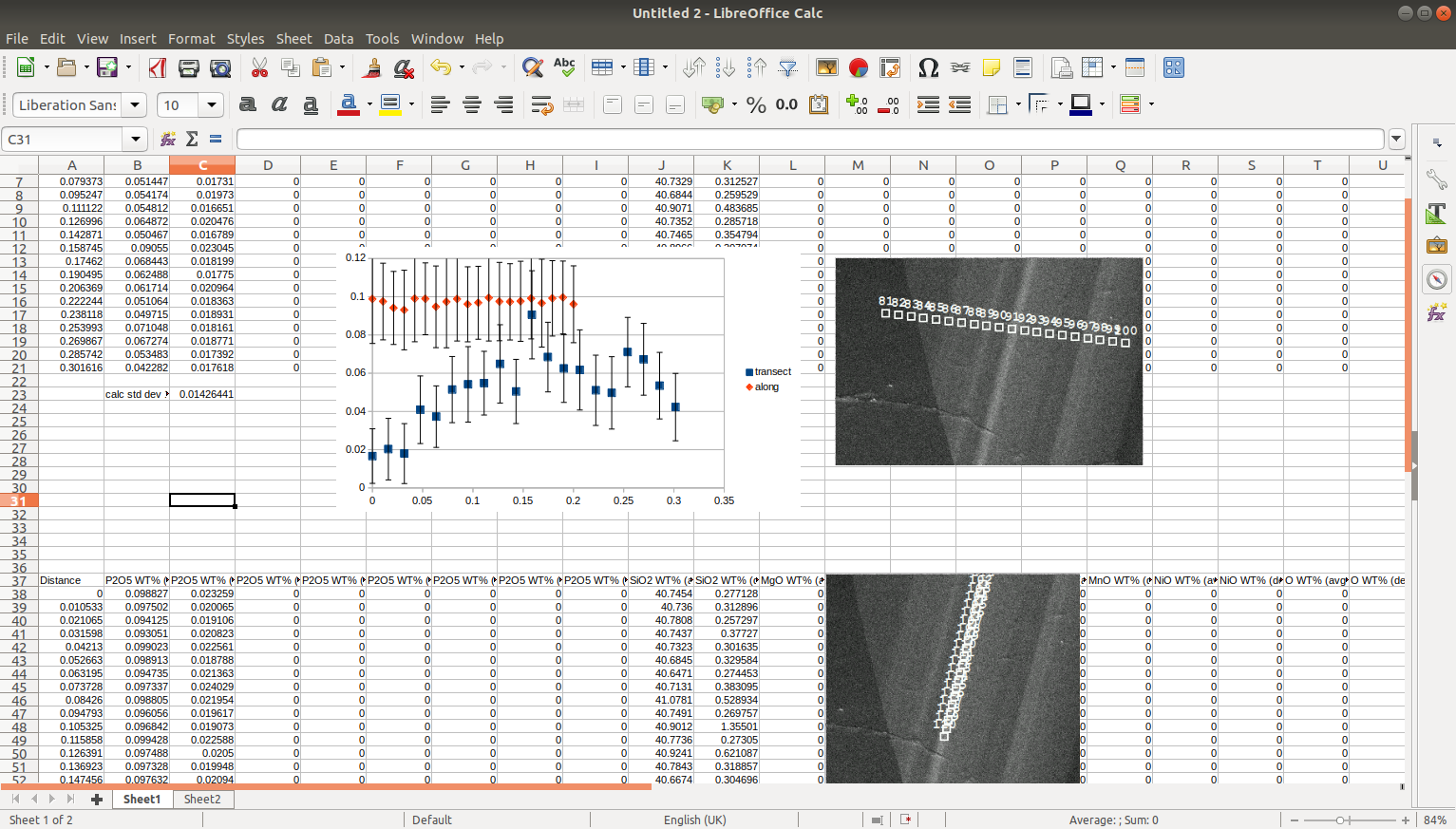

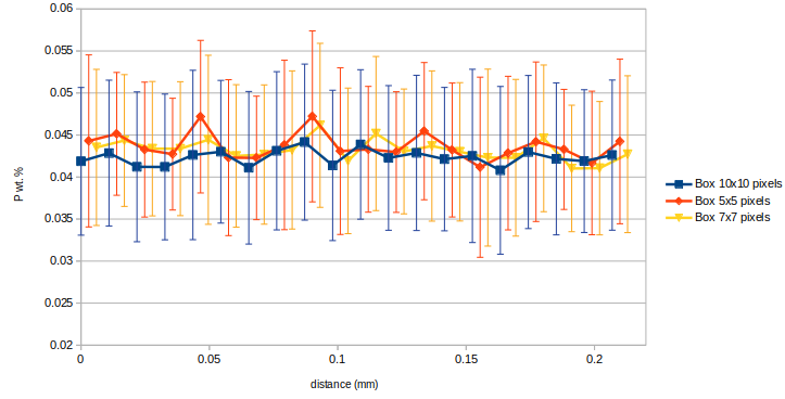

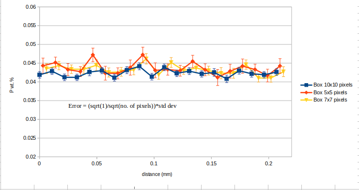

Here's a puzzle, why is standard deviation not a suitable measure of the error when averaging pixels?
Here's two line profiles extracted using calcimage line profile - for P in olivine. The error bars (which are standard deviation of 100 pixels - correctly calculated) are too large for the actual error - this can be seen by comparing the 'traverse' profile and 'along' profile. In the 'along' profile the error is seen to be very small - as given by the variation in average along the homogeneous zone and yet the error bars are large.
I wonder if its because the counts per pixel are very small? Would calculating the error (using the error formula) for the sum of the counts be more realistic?
Here's a way of conceptualizing the issue. Again along the homogeneous zone. I extract boxes of 10x10, 7x7 and 5x5 (without moving the positions). The std dev is the same for each, but the error on the analysis improves as the box size increases (assuming the composition within the box is homogeneous). This can be seen in the straighter line with less noise (points deviating away from the straight line)
#28

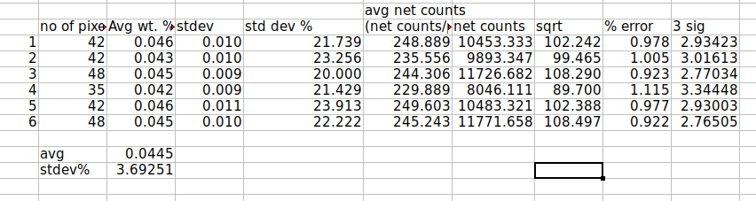

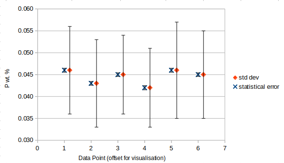

I've just done a quick approximate calculation
Extracting boxes of ca. 40 pixels using imagej, along the homogeneous band - shown above. Extract average and standard deviation for (1) raw counts and (2) quantified weight %). Then using the raw counts subtract the background which is constant (trace element variation in homogeneous olivine). Then using square root of total counts (avg counts*no. of pixels) to calculate the statistical error.
It can be seen that the statistic error based on the number of counts is the right order of magnitude (ca 1%). Whereas the standard deviation is much greater (ca. 20%). The average wt % data varies by 3.7%.
Can we calulate the improvement in std dev as the number of pixels increases. If we increase the number of pixels by 45x. An increase in counts by 45x should reduce the error by 0.149 (sqrt of cts), thus 20% multiplied by 0.149 gives 2.98.
If we apply this to the data in the previous post

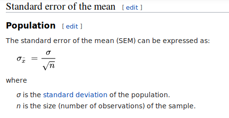

- it seems to work (not sure if its mathematically sound). This is actually the standard error (as John points out in later post) https://smf.probesoftware.com/index.php?topic=1144.msg7973#msg7973. Standard error is given by:
https://en.wikipedia.org/wiki/Standard_error
