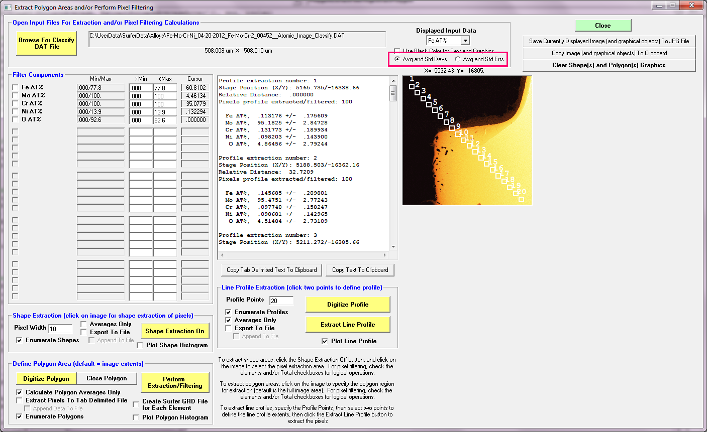

I think we've got what we need.  Check out this new control for average and standard deviations or average and standard errors:

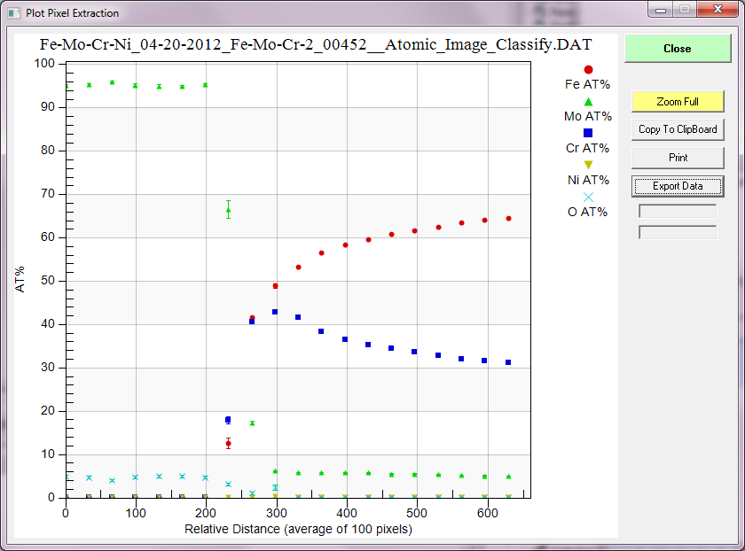

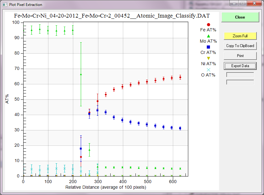

And here is a plot using the standard deviations:
and here is the same data but using the standard errors:
For those wondering what the standard error is, it's the standard deviation divided by the square root of (number of measurements minus one).  That's a big improvement in precision, but it makes sense since there are lots of pixels to average in a 10 x 10 pixel shape!
Remember, the standard deviation describes the variance of each point, while the standard error describes the variance of the average.  Bottom line, making more measurements of points *or* pixels, has its reward!    :D

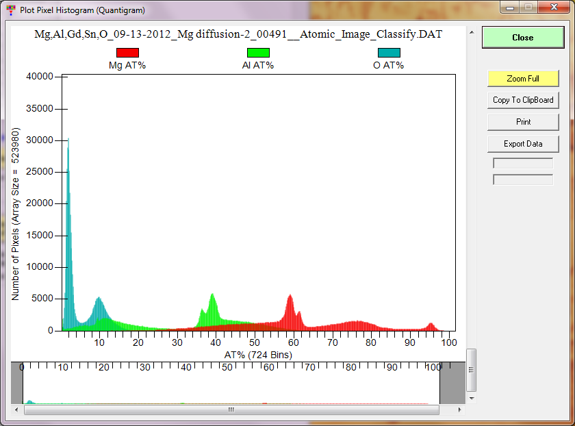

Ben Buse mentions that the quantitative histogram feature, or Quantigram as Ed Vicenzi has termed it, described here:
https://smf.probesoftware.com/index.php?topic=1144.msg7951#msg7951

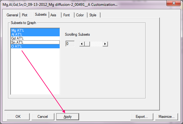

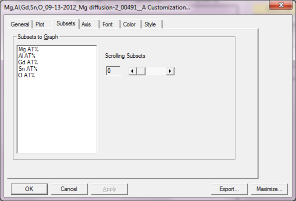

might be confusing when many elements are displayed at once.  We concur and we finally realized that there is a built-in feature of the Pro Essentials graphics library that allows the user to select specifically which data subsets to plot. To access this subset selection feature (and this applies to all plots in Probe for EPMA and CalcImage by the way!), simply right click on the plot and select the Customization Dialog menu as seen here:
You will then see this dialog:
Next, from this dialog select the subsets that you wish to plot and click the OK or Apply button as seen here:
Here we selected only the Mg, Al and O subsets for clarity and the plot (after zooming in) in is much easier to read:

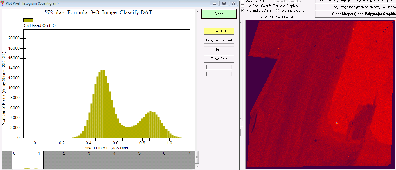

Here's a plagioclase map
You can see the Bytownite/Anorthite core and Andesine/Labradorite rim. It also shows the large error (as each pixel short time etc), which masks any further distinctions in the histogram
What a pretty sample. It's almost "art"!
Did you try seeing if you can "pull out" these zoned compositions using the Classify window in CalcImage:
https://smf.probesoftware.com/index.php?topic=1071.0
You might need to set the precision to a small number, maybe even zero, and try specifying 2, 3 or 4 phases.
