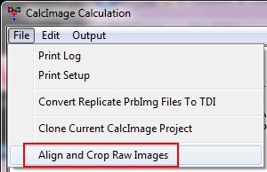

To perform this alignment and crop method open the Log Window from the Window menu in the main CalcImage window and select the new Align and Crop Raw Images menu as seen here:

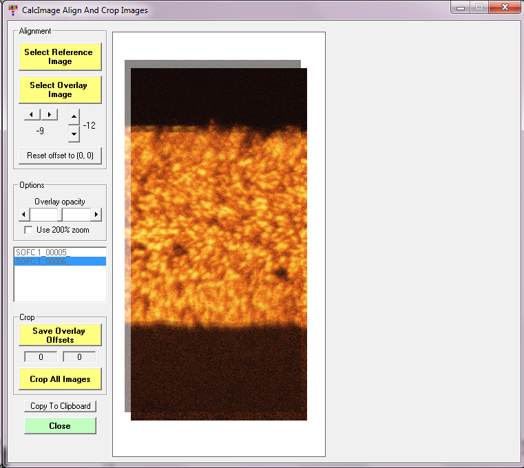

Then open a reference image (typically a BSE image from the first spectrometer pass) using the Select Reference Image button, and then open a similar image from the 2nd spectrometer pass (again typically a BSE image from the second spectrometer pass), this time using the Select Overlay Image button.
I created an artificial (very large) offset on some test images, so the idea is clear for everyone, though normally I would expect only a few pixels of drift in x or y.  Right now the code is limited to 10% drift, but we could allow for larger offsets if necessary...
Then using the mouse drag or the offset updown controls, we adjust the overlay image until it is perfectly aligned with the reference image as seen here:
Then we click the Save Overlay Offsets button to store the overlay for the alignment of this spectrometer pass (the second spectrometer pass).  If there is a third or fourth spectrometer pass again we select an overlay image from that spectrometer pass (you must keep the original reference image!), and again align it to the reference image and again, click the save Overlay Offsets button to save the alignment for this next spectrometer pass. The app remembers the alignments of each overlay for you automatically...

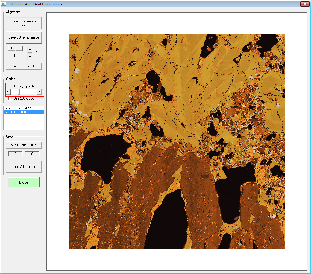

Not sure if this is useful but I loaded a BSE image as the reference image and an x-ray map as the overlay image in the Align and Crop window and you get a sort of "composite" image like this:
Adjusting the opacity slider one can obtain this:
If this "composite" image might be worth capturing I could add a "copy to clipboard" button... what do you all think?

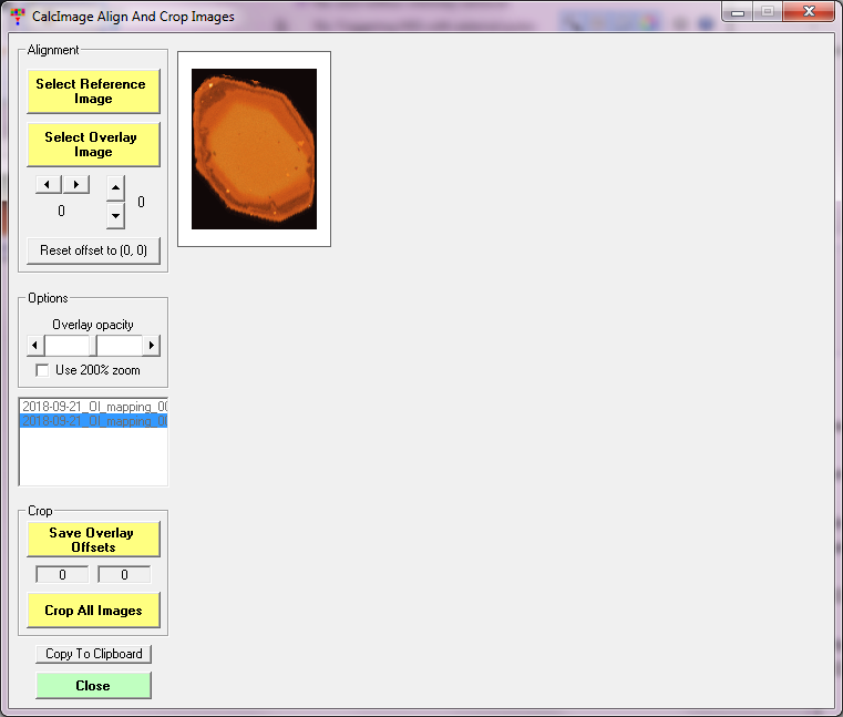

Hi Aurélien,
There's nothing special about cropping rectangular or even polygon scans.  Here is an example of aligning and cropping a rectangular polygon scan:

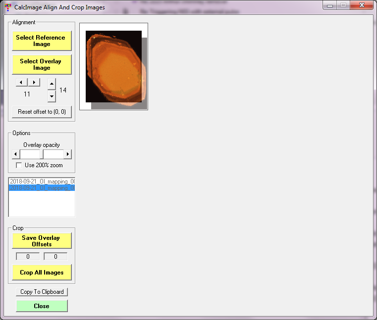

and here it is aligned:
If you have need for alignments greater than this, you have bigger problems than I can help with. For example, if the instrument is drifting at this rate, straight lines will appear as as diagonal lines!
I think you need to get your instrument fixed!     :'(
If I am not understanding something please let me know what I am missing.

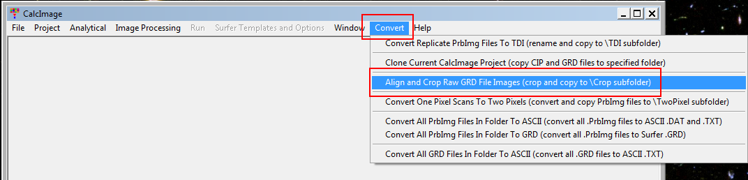

As you may know, we recently moved the Align and Crop menu to a new Convert menu in the main CalcImage window as seen here:
This Align and Crop window is useful when your x-ray map acquisitions require more elements than you have WDS spectrometers, e.g., 10 elements on a 5 spectrometer instrument, therefore 2 map acquisitions are required, and your instrument is experiencing significant stage or beam drift over time.

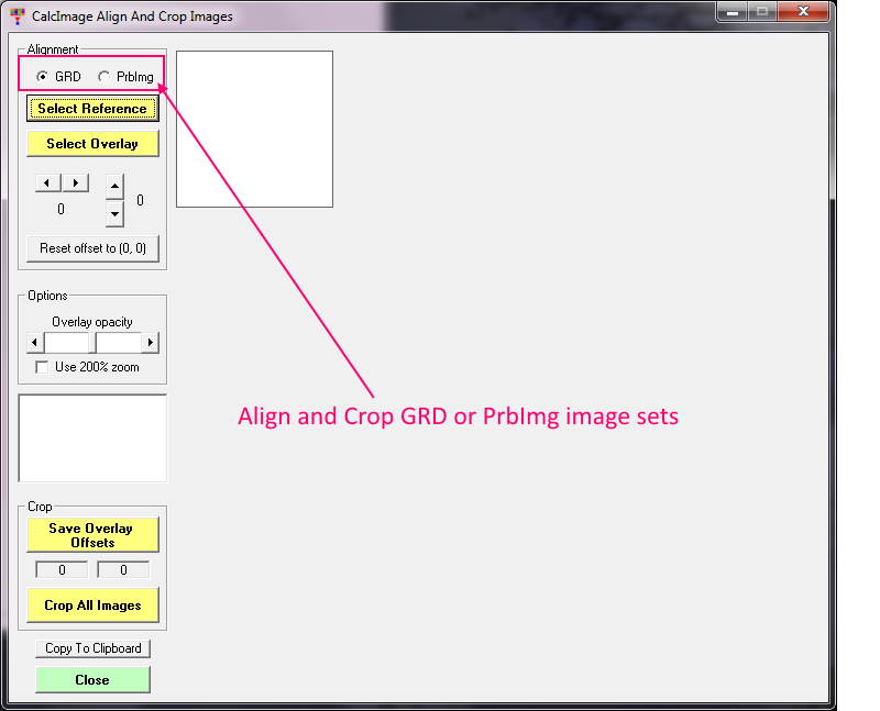

We recently added the ability to align and crop PrbImg images sets (in addition to GRD files).
This could be useful when performing replicate TDI acquisitions and there is sample drift from one TDI replicate to the other.
Once this is done, one can import the cropped PrbImg files into a new CalcImage project, and optionally perform an additional align and crop procedure on the GRD files for projects with multiple elements per spectrometer.
