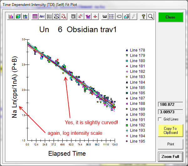

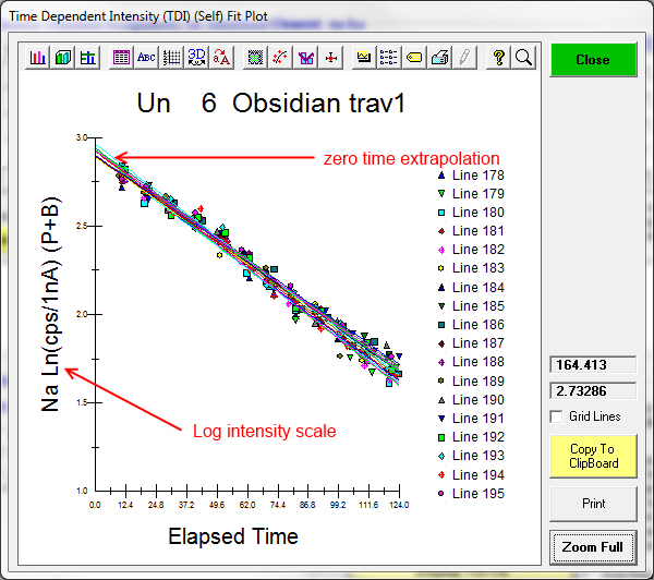

Here we see a large but otherwise typical TDI correction (note most of the examples we will discuss will be from Na intensities, but the PFE TDI correction applies equally well to all elements that undergo changes in intensity as a function of beam exposure, e.g., K, Si, Al, F, P, etc.):
The above example has a Na TDI correction percent of almost 80%. Not too bad for losing almost half one's Na intensity as seen here:

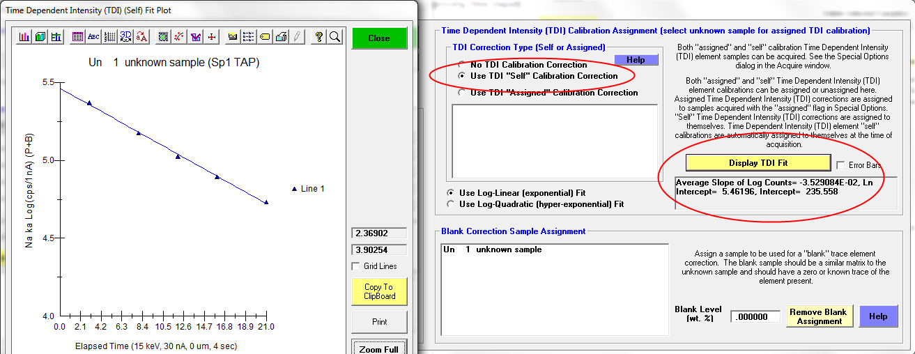

Potassium is much less affected at 0.454 % (not even statistically significant) and silicon and oxygen are minor corrections (-0.87 and -3.03 % respectively, though both statistically significant).
By the way, the above calculation is for water by stoichiometry to measured excess oxygen as first described by Barbara Nash, http://www.geology.wisc.edu/courses/g777/AmMin/Nash.pdf.

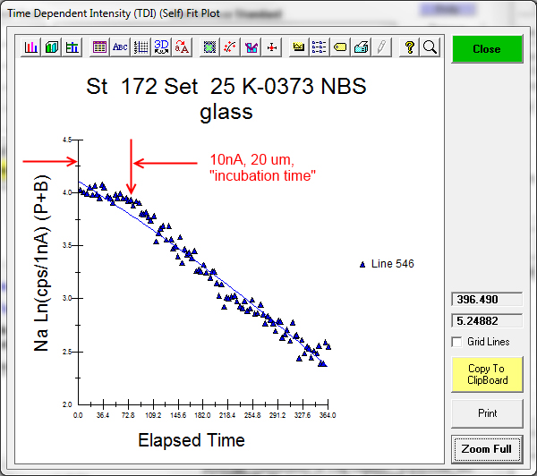

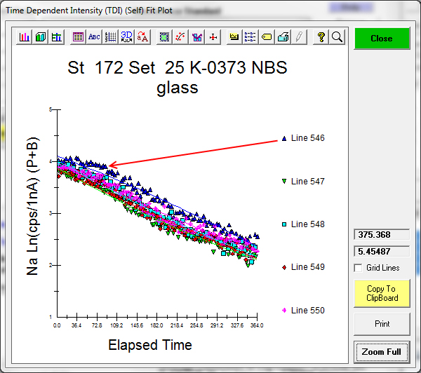

Well as mentioned previously, sometimes we have to focus the beam and/or increase the beam current and this can cause a number of additional artifacts. The first I will focus on is the so called "incubation time" described by Stuart Kearns which can be seen in a number of compositions, but the high Na glasses prepared for NIST provides extremely beam sensitive materials that can be useful in these investigations, as we can see here in the low time resolution TDI acquisition on K-0373 NIST glass (10 nA, 10 um):

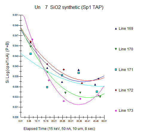

A higher time resolution TDI acquisition will make this artifact even more obvious:
I suspect that what we are seeing here with this "incubation time" is the warming of the sample by the electron beam. That is to say, ion migration of alkali elements towards the sub surface charge implanted by the electron probe does not start, until the sample spot is heated sufficiently. This hypothesis is further supported by a number of acquisitions where it is observed that it is the first point that almost always shows this "incubation time" effect most strongly. In the previous 10 nA, 20 um beam TDI acquisition it can be seen by displaying all the data points for the sample as seen here:

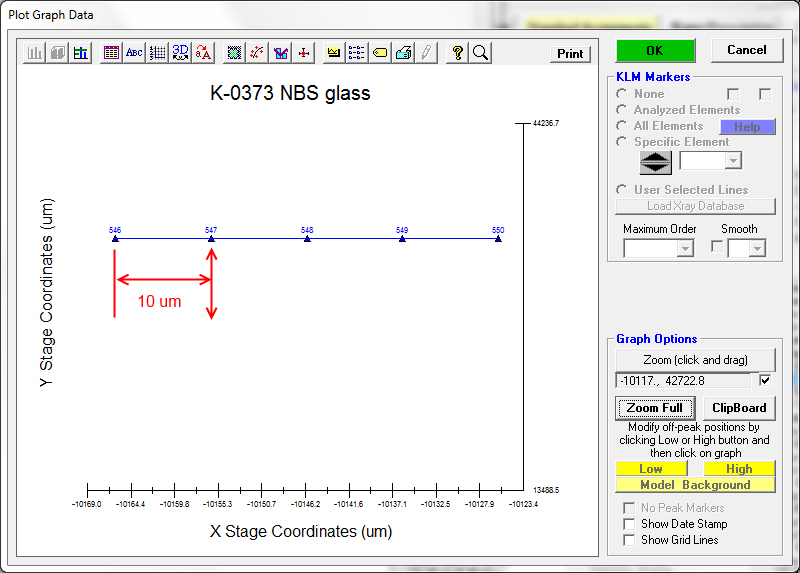

This can also be confirmed by displaying the x and y stage positions of these analyses as seen here:
Note that with a 10 um beam, the 10 um spaced points are essentially adjacent, and therefore the previous point provides a heating time to eliminate sufficient to reduce the "incubation time".  Which brings me to a partial solution for this issue.
Clearly if the "incubation time" is variable due to the proximity of previous TDI acquisitions we will have to be more careful about our selection of points for analysis. But if the "incubation time" is fairly reproducible we could utilize a delay in acquisition after the faraday cup is removed, but before the intensity acquisition begins. Interestingly enough, this feature is already built into Probe for EPMA but intended for another application. Called the "Decontamination Time" it was intended to be used for carbon analysis (Pinard and Richter) to allow time for the native hydrocarbon layer on the sample to be removed prior to the count integration as seen here:

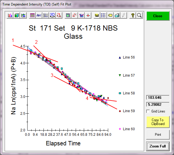

So what's next?  Let's examine some other TDI acquisition log slopes more carefully, starting with this acquisition on yet another high Na NIST glass (K-1718) at 10 nA and 10 um, which shows several slopes in exponential space as seen here:
What's a micro analyst to do?
qEd

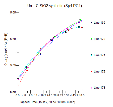

Oh so back to the problematic issue of slope dermination. The first order approach any salt of the earth spectroscopist would use involves displaying the 1st derivative followed by user interaction by defining the range of time over which the slope is determined.
qEd
Breaking out the slope of the earliest/first time dependency mechanism is the most (or only) critical measurement to make as it directly impacts the magnitide of the signal at t=0 unless you are studying the ongoing physics of e- beam-matter interaction itself.
For the materials I have examined such changes take place over relatively short periods of time secs. Hence the challenge is to collect data at short intervals, at the expense of statistics. Once too much time has passed you are potentially either 1)within another of damage regime, or 2) have integrated over an interval so large the slope of the natural log curve is less accurate.

So let's look at where we are on the most beam sensitive material that I have found, the K-1781 NIST glass. Here is an analysis, 10 nA, 10 um *without* any TDI correction:
St  171 Set   9 K-1718 NBS Glass, Results in Elemental Weight Percents
SPEC:        O
TYPE:     SPEC
AVER:   43.050
SDEV:     .000
ELEM:       Na      Si      Ca      Fe       P
BGDS:      LIN     EXP     LIN     LIN     EXP
TIME:    40.00   40.00   40.00   40.00   40.00
BEAM:    10.58   10.58   10.58   10.58   10.58
ELEM:       Na      Si      Ca      Fe       P   SUM
    56   7.849  29.765   4.000  11.140    .008  95.813
    57   7.696  30.010   3.958  11.078   -.017  95.775
    58   8.004  29.527   3.969  11.224   -.029  95.746
    59   7.703  29.477   3.985  11.022    .040  95.277
    60   7.822  29.776   3.952  11.185    .044  95.829
AVER:    7.815  29.711   3.973  11.130    .009  95.688
SDEV:     .126    .215    .020    .081    .033    .232
SERR:     .056    .096    .009    .036    .015
%RSD:     1.61     .72     .50     .73  349.44
PUBL:   14.837  28.048   3.574  10.491    n.a. 100.000
%VAR:   -47.33    5.93   11.17    6.09     ---
DIFF:   -7.022   1.663    .399    .639     ---
STDS:      336      14     285     162     285
STKF:    .0735   .4101   .3596   .0950   .1599
STCT:    76.73   79.39  602.77   66.49   40.15
UNKF:    .0382   .2422   .0367   .0945   .0001
UNCT:    39.89   46.89   61.54   66.11     .02
UNBG:      .31     .13    1.04     .98     .06
ZCOR:   2.0450  1.2267  1.0819  1.1776  1.4231
KRAW:    .5199   .5906   .1021   .9944   .0004
PKBG:   143.98  389.44   60.42   69.66     .50
Only a -50% error! Now the same measurements with the linear (exponential) TDI fit:

Now only a +15% error. Next we use the quadratic (hyper-exponential) fit:

Now we have "only" a +5% relative error on Na and this is with a 110% correction to the intensity. Is it perfect? No. Is it better than a poke in the eye with a sharp stick? Yes, and then some.

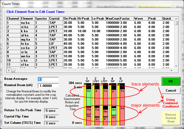

Combined Analytical Condition Arrays:
ELEM:       Na      Si       K      Al      Mg      Fe      Ca      Sr      Mn       S      Cl      Ti       P      Zr
TAKE:     40.0    40.0    40.0    40.0    40.0    40.0    40.0    40.0    40.0    40.0    40.0    40.0    40.0    40.0
KILO:     15.0    15.0    15.0    15.0    15.0    15.0    15.0    15.0    15.0    15.0    15.0    15.0    15.0    15.0
CURR:     10.0    10.0    10.0    10.0    10.0    10.0    10.0    10.0    10.0    50.0    50.0    50.0    50.0    50.0
SIZE:     10.0    10.0    10.0    10.0    10.0    10.0    10.0    10.0    10.0    10.0    10.0    10.0    10.0    10.0

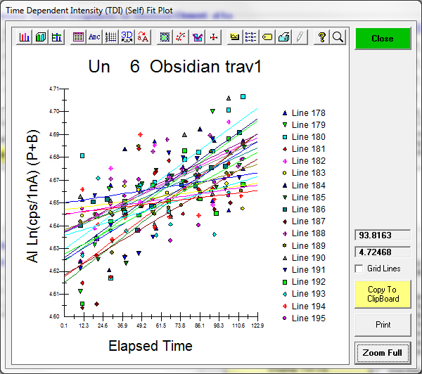

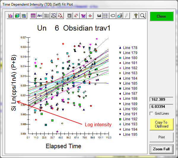

Obviously the totals are low, so we might suspect a TDI situation (even though we used a 10 um beam for all the points). If we examine the TDI data (I almost always just leave this acquisition option turned on because it uses very little overhead, and if you do run into a TDI situation you already have the intensity interval data to perform a TDI correction), you'll see a significant decrease in the Na intensities over time as seen here:
For Si ka the situation is less dire (and is barely statistically significant), but worth a correction:
Al ka is somewhat more statistically significant as seen here:
The results for these linear (exponential) extrapolations are seen here:

The totals look good, but are we done? Well if we look more closely at the Na TDI plot above, we see that there seems to be a slight curvature in the linear (exponential) fit, so maybe we should utilize the quadratic fit in log space or "hyper-exponential" fit as seen here:
How does this tiny change affect our results? Not that much, but a little. Note the difference in the average deviation in the linear and quadratic fits for Na. The linear (conventional exponential fit) has a DEV% of 5.8, while the "hyper-exponential" (quadratic exponential fit) has a DEV% of 3.4, so the hyper-exponential is definitetely a better fit to the data as seen here:

And our Na value went from 3.5 wt% to just under 3.4 wt%. Not much, remember the fit is better, so it should be a better extrapolation.
Now what about Ed's point about the early TDI intervals being more important for the extrapolation?
If we pull up the Analytical | Analysis Options menu dialog, in addition to a global flag for toggling all TDI corrections in the run, we also see the Use Time Weighted data for TFI Fit option. Let's turn that on and use the default 8 weighting factor which means that the first TDI point will be duplicated 8 times, the 2nd TDI point 7 times, the 3rd TDI point 6 times, etc., etc., before being fit!
Now what does our Na data look like?
Un    6 Obsidian trav1, Results in Elemental Weight Percents
ELEM:       Na      Si       K      Al      Mg      Fe      Ca      Sr      Mn       S      Cl      Ti       P      Zr       O       H
TYPE:     ANAL    ANAL    ANAL    ANAL    ANAL    ANAL    ANAL    ANAL    ANAL    ANAL    ANAL    ANAL    ANAL    ANAL    CALC    SPEC
BGDS:      MAN     MAN     LIN     MAN     MAN     MAN     MAN     LIN     LIN     LIN     LIN     LIN     EXP     EXP
TIME:    90.00   60.00   20.00   80.00   60.00  160.00   80.00   40.00   30.00  100.00  100.00  100.00  100.00  100.00
BEAM:     9.99    9.99    9.99    9.99    9.99    9.99    9.99    9.99    9.99   50.29   50.29   50.29   50.29   50.29
ELEM:       Na      Si       K      Al      Mg      Fe      Ca      Sr      Mn       S      Cl      Ti       P      Zr       O       H   SUM
   178   3.086  35.654   3.801   7.090    .025    .497    .356    .061    .071    .002    .044    .036    .001   -.010  49.135    .000  99.848
   179   3.321  35.488   3.953   6.886    .017    .483    .351    .008    .048    .003    .046    .045   -.004   -.011  48.849    .000  99.483
   180   3.273  35.258   3.674   7.076    .018    .417    .364    .020    .046    .003    .042    .028   -.004    .006  48.666    .000  98.887
   181   3.121  35.403   3.897   6.847    .018    .480    .362    .034    .055   -.001    .039    .050   -.003   -.009  48.652    .000  98.946
   182   3.300  35.628   3.621   6.982    .022    .534    .369   -.019    .053   -.001    .041    .027    .000   -.008  49.035    .000  99.584
   183   3.354  35.546   3.822   7.081    .023    .494    .371   -.001    .058   -.001    .040    .037   -.003   -.006  49.088    .000  99.904
   184   3.277  35.309   3.695   6.935    .020    .471    .358   -.003    .064    .002    .035    .038   -.003    .001  48.626    .000  98.824
   185   3.450  35.538   3.764   6.835    .024    .418    .365   -.008    .040    .002    .036    .020   -.001   -.020  48.838    .000  99.302
   186   3.465  35.431   3.717   7.048    .026    .441    .363   -.015    .039    .001    .033    .037    .000    .000  48.925    .000  99.510
   187   3.366  35.184   3.895   6.827    .024    .475    .354    .044    .033    .000    .036    .042   -.005   -.010  48.456    .000  98.721
   188   3.155  35.356   3.740   6.979    .016    .392    .351    .033    .040    .001    .034    .023    .000   -.002  48.649    .000  98.768
   189   3.186  35.214   3.775   7.030    .020    .372    .355    .011    .029    .001    .033    .030    .003   -.006  48.549    .000  98.601
   190   3.365  35.294   3.854   7.085    .017    .473    .343    .036    .042    .002    .033    .027   -.006   -.015  48.783    .000  99.335
   191   3.305  35.340   3.648   6.952    .020    .475    .351    .004    .047   -.002    .034    .039   -.002   -.020  48.664    .000  98.854
   192   3.403  35.474   3.750   6.899    .019    .460    .360    .039    .063   -.001    .034    .034   -.001   -.006  48.840    .000  99.371
   193   3.304  35.654   3.683   7.005    .020    .446    .366    .033    .051    .000    .034    .031    .000   -.012  49.082    .000  99.699
   194   3.209  35.320   3.662   7.111    .020    .539    .351   -.009    .055   -.001    .035    .020   -.002   -.008  48.762    .000  99.064
   195   3.181  35.328   3.741   7.089    .017    .476    .352    .067    .040    .000    .035    .049    .004   -.018  48.774    .000  99.136
AVER:    3.284  35.412   3.761   6.987    .020    .464    .358    .019    .049    .001    .037    .034   -.001   -.009  48.798    .000  99.213
SDEV:     .110    .148    .094    .097    .003    .044    .008    .026    .011    .002    .004    .009    .003    .007    .195    .000    .403
SERR:     .026    .035    .022    .023    .001    .010    .002    .006    .003    .000    .001    .002    .001    .002    .046    .000
%RSD:     3.33     .42    2.50    1.38   14.35    9.44    2.12  138.43   23.09  265.87   10.91   26.43 -199.12  -82.49     .40     .00
STDS:      336      14     374     160     162     162     162     251      25     730     285      22     285     257       0       0
STKF:    .0735   .4101   .1132   .0334   .0568   .0950   .1027   .4268   .7341   .5061   .0601   .5547   .1599   .4201   .0000   .0000
STCT:    71.55  568.51  226.21   62.09   81.21   18.33  161.20  292.31 2053.05  449.51   79.86   58.15  227.12  213.15     .00     .00
UNKF:    .0181   .2912   .0326   .0551   .0001   .0039   .0032   .0002   .0004   .0000   .0003   .0003   .0000  -.0001   .0000   .0000
UNCT:    17.66  403.69   65.20  102.27     .20     .75    5.02     .10    1.12     .00     .39     .03    -.01    -.03     .00     .00
UNBG:      .32     .22     .94     .88     .51     .23    1.01     .94    4.78     .16     .33     .05     .81     .88     .00     .00
ZCOR:   1.8103  1.2161  1.1528  1.2688  1.4481  1.1980  1.1184  1.2337  1.2174  1.2857  1.2528  1.1970  1.4629  1.4594   .0000   .0000
KRAW:    .2468   .7101   .2882  1.6472   .0025   .0407   .0312   .0004   .0005   .0000   .0049   .0005  -.0001  -.0001   .0000   .0000
PKBG:    56.05 1853.28   70.71  117.47    1.39    4.31    5.97    1.12    1.24    1.03    2.20    1.65     .98     .97     .00     .00
INT%:     ----    ----    ----    ----    ----    -.02    ----  -93.84    ----    ----    ----    ----    ----    ----    ----    ----
TDI%:   78.615   -.609   -.162  -2.187    ----    .092    ----    ----    ----    ----    ----    ----    ----    ----    ----    ----
DEV%:      2.5      .7     2.5     1.2    ----     7.6    ----    ----    ----    ----    ----    ----    ----    ----    ----    ----
TDIF:   QUADRA  LINEAR  LINEAR  LINEAR    ----  LINEAR    ----    ----    ----    ----    ----    ----    ----    ----    ----    ----
TDIT:   125.56   97.78   61.11  117.28    ----  198.17    ----    ----    ----    ----    ----    ----    ----    ----    ----    ----
TDII:     18.0    404.    66.1    103.    ----    .965    ----    ----    ----    ----    ----    ----    ----    ----    ----    ----
I have to say I was surprised. The time weighted data option had more effect on the data that the hyper-exponential fit (on this dataset anyway), because Na went from 3.4 wt% to 3.28 wt% *and* the overall DEV% improved to 2.5.
So, yes, Ed is correct, we should give our first TDI intervals more "weight" one way or another.

A student recently analyzed a fiber optic as a class project and it was interesting to see the TDI effects for pure SiO2 crystal versus glass. For example, if we use SiO2 as a standard and acquire the standard also as an unknown, we get reasonable results because the TDI effects on the Si Ka and O ka are almost normalized out as seen here:
Un    7 SiO2 synthetic
TakeOff = 40.0  KiloVolt = 15.0  Beam Current = 50.0  Beam Size =   10
(Magnification (analytical) =  40000),        Beam Mode = Analog  Spot
(Magnification (default) =      400, Magnification (imaging) =    800)
Image Shift (X,Y):                                          .00,   .00
Number of Data Lines:   5             Number of 'Good' Data Lines:   5
First/Last Date-Time: 11/27/2013 04:57:01 PM to 11/27/2013 05:21:02 PM
WARNING- Using Exponential Off-Peak correction for si ka
WARNING- Using Exponential Off-Peak correction for o ka
Average Total Oxygen:         .000     Average Total Weight%:   99.708
Average Calculated Oxygen:    .000     Average Atomic Number:   10.798
Average Excess Oxygen:        .000     Average Atomic Weight:   20.020
Oxygen Equiv. from Halogen:   .000  Halogen Corrected Oxygen:     .000
Average ZAF Iteration:        7.00     Average Quant Iterate:     2.00
Un    7 SiO2 synthetic, Results in Elemental Weight Percents
ELEM:       Si       O      Er      Cl
BGDS:      EXP     EXP     LIN     LIN
TIME:    40.00   40.00  160.00  160.00
BEAM:    50.09   50.09   50.09   50.09
ELEM:       Si       O      Er      Cl   SUM
   169  46.586  53.121   -.001   -.001  99.705
   170  46.491  53.288   -.002    .001  99.777
   171  46.521  53.079    .008    .000  99.607
   172  46.599  53.152   -.009    .002  99.745
   173  46.459  53.260   -.013    .000  99.706
AVER:   46.531  53.180   -.003    .000  99.708
SDEV:     .060    .090    .008    .001    .064
SERR:     .027    .040    .004    .001
%RSD:      .13     .17 -235.67  745.15
STDS:       14      14    1003     285
STKF:    .4101   .2664   .5350   .0601
STCT:   693.09  267.64  184.31   43.90
UNKF:    .4082   .2661   .0000   .0000
UNCT:   689.96  267.40    -.01     .00
UNBG:     1.00    1.44     .82     .22
ZCOR:   1.1398  1.9985  1.5611  1.2798
KRAW:    .9955   .9991   .0000   .0000
PKBG:   692.47  186.37     .99    1.01
In addition to the TDI effects being similar (because we are analyzing the same material for both standard and unknown), they are also fairly minor in magnitude as seen here for Si Ka in SiO2 crystal:
One could even argue we are "over fitting" the Si Ka TDI correction because it is such a small correction. Which is *not* the case for O Ka in SiO2 crystal:
As has been observed by many, the oxygen intensity changes dramatically over time even with a 10 um diameter beam. In fact the TDI effect for O Ka is very dependent on subtle surface conditions such as the carbon coat. Because of this, with the TDI correction turned on for both the standard SiO2 and the same standard acquired as an unknown, we get these somewhat improved results for SiO2 analyzed as an unknown:
Un    7 SiO2 synthetic
WARNING- Using Time Dependent Intensity (TDI) Element Correction
Average Total Oxygen:         .000     Average Total Weight%:   99.846
Average Calculated Oxygen:    .000     Average Atomic Number:   10.800
Average Excess Oxygen:        .000     Average Atomic Weight:   20.024
ELEM:       Si       O      Er      Cl
   169  46.629  53.392   -.001   -.001 100.019
   170  46.641  53.254   -.002    .001  99.893
   171  46.414  53.376    .007    .000  99.797
   172  46.619  52.784   -.009    .002  99.397
   173  46.856  53.279   -.013    .000 100.122
AVER:   46.632  53.217   -.003    .000  99.846
SDEV:     .157    .249    .008    .001    .280
SERR:     .070    .111    .004    .001
%RSD:      .34     .47 -230.82  747.92
STCT:   699.38  249.93  184.41   50.55
UNKF:    .4092   .2662   .0000   .0000
UNCT:   697.79  249.77    -.01     .00
ZCOR:   1.1397  1.9993  1.5466  1.2799
KRAW:    .9977   .9993   .0000   .0000
PKBG:   700.33  174.14     .99    1.01
TDI%:    1.135  -6.591   -.632   -.248
DEV%:       .1      .2      .2     1.3
TDIF:   QUADRA  QUADRA  LINEAR  LINEAR
TDIT:    51.40   51.80  170.20  170.20
TDII:     698.    250.    .823    .220
From this we might conclude that even when analyzing the *same* material, it is sometimes necessary to run *both* the standard and unknown not only at similar beam conditions, but also utilizing the TDI acquisition and correction for both standard and unknown because of subtle variations in coating, adsorbed water, beam focus and thermal conductivity (etc.?).

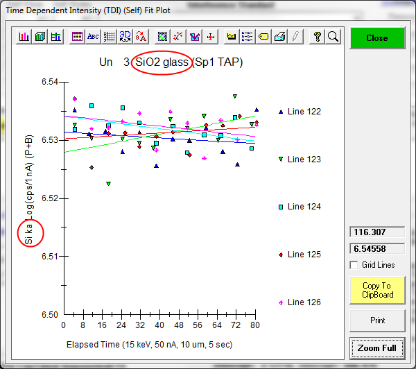

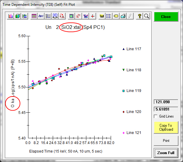

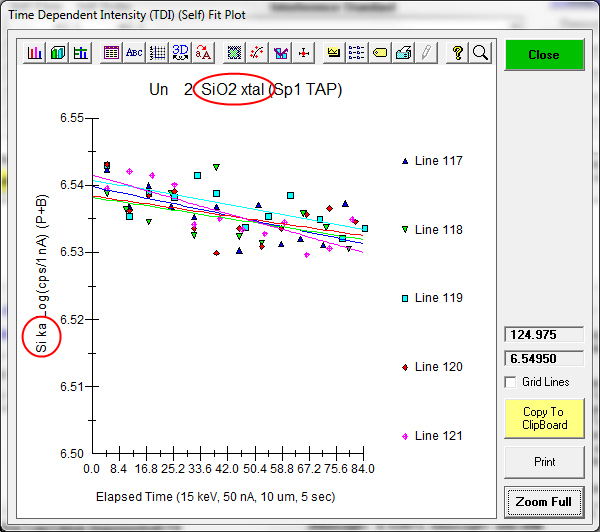

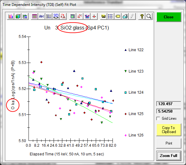

Ok, so I was able to do a quick run of SiO2 crystal versus SiO2 glass and here are the results. Conditions (using the Analyze! "Report" button) were:
Compositional analyses were acquired on an electron microprobe (Cameca SX100 (TCP/IP Socket)) equipped with 5 tunable wavelength dispersive spectrometers. Operating conditions were 40 degrees takeoff angle, and a beam energy of 15 keV. The beam current was 50 nA, and the beam diameter was 10 microns.
Elements were acquired using analyzing crystals LPET for Cl ka, LTAP for Al ka, TAP for Si ka, and PC1 for O ka.
The standards were Ca10(PO4)6Cl2 (halogen corrected) for Cl ka, Nepheline (partial anal.) for Al ka, and SiO2 (elemental) (#14) for Si ka, O ka.
The counting time was 60 seconds for all elements. The intensity data was corrected for Time Dependent Intensity (TDI) loss (or gain) using a self calibrated correction for Si ka, O ka, Al ka, Cl ka. The off peak counting time was 20 seconds for all elements. Off Peak correction method was Linear for Cl ka, and Exponential for O ka, Al ka, Si ka.
Unknown and standard intensities were corrected for deadtime. Standard intensities were corrected for standard drift over time.
The exponential or polynomial background fit was utilized. See John J. Donovan, Heather A. Lowers and Brian G. Rusk, Improved electron probe microanalysis of trace elements in quartz, American Mineralogist, 96, 2011
The SiO2 crystal acquisition for Si Ka looks like this:
The SiO2 crystal acquisition for O Ka looks like this:
The SiO2 glass acquisition for Si Ka looks like this:
The SiO2 glass acquisition for O Ka looks like this:
The quant results running both materials as unknowns (using SiO2 crystal as the primary standard) is here w/o the TDI correction:

Un    2 SiO2 xtal, Results in Elemental Weight Percents
ELEM:       Si       O      Al      Cl
BGDS:      EXP     EXP     EXP     LIN
TIME:    60.00   60.00   60.00   60.00
BEAM:    49.82   49.82   49.82   49.82
ELEM:       Si       O      Al      Cl   SUM
   117  46.791  53.450    .005    .001 100.247
   118  46.767  53.493    .000    .000 100.259
   119  46.849  53.574    .001    .000 100.425

Un    3 SiO2 glass
First/Last Date-Time: 12/03/2013 03:00:25 PM to 12/03/2013 03:09:47 PM
WARNING- Using Exponential Off-Peak correction for al ka
Average Total Oxygen:         .000     Average Total Weight%:   99.375
Average Calculated Oxygen:    .000     Average Atomic Number:   10.811
Average Excess Oxygen:        .000     Average Atomic Weight:   20.040
Un    3 SiO2 glass, Results in Elemental Weight Percents
ELEM:       Si       O      Al      Cl
   122  46.514  52.881    .004    .004  99.403
   123  46.538  52.747    .004   -.003  99.285
   124  46.572  52.861    .006   -.003  99.436
   125  46.540  52.787    .005   -.003  99.329
   126  46.586  52.829    .006    .002  99.423
AVER:   46.550  52.821    .005    .000  99.375
SDEV:     .029    .055    .001    .003    .065
SERR:     .013    .024    .000    .001
%RSD:      .06     .10   23.08 -815.86
STDS:      914     914     336     285
STKF:    .4101   .2664   .1331   .0601
STCT:   687.97  250.02  725.07   78.20
UNKF:    .4086   .2637   .0000   .0000
UNCT:   685.39  247.54     .21     .00
UNBG:      .97    1.28    3.17     .32
ZCOR:   1.1394  2.0028  1.2278  1.2803
KRAW:    .9962   .9901   .0003  -.0001
PKBG:   705.66  194.79    1.07    1.00
The SiO2 crystal looks fine because it was run at the exact same conditions as the SiO2 (crystal) standard, but the SiO2 glass is a little low in oxygen due to the different TDI effects for glass.
The quant results running both materials as unknowns (using SiO2 crystal as the primary standard) is here with the TDI correction:
Un    2 SiO2 xtal
First/Last Date-Time: 12/03/2013 02:48:14 PM to 12/03/2013 02:57:40 PM
