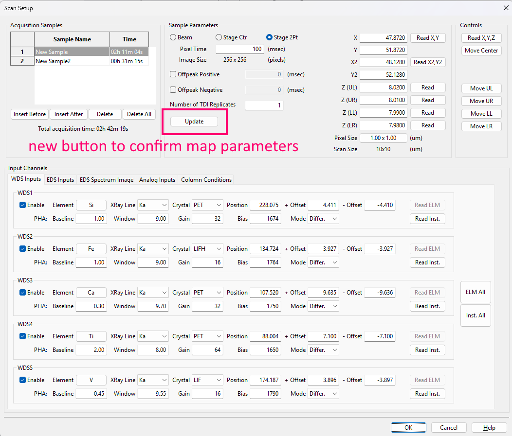

We added a new Update button to the Setup | Acquisition dialog to allow the user to confirm the mapping parameters manually:
Previously the mapping parameters were only checked when switching to another map sample or closing the dialog (and they still are).
