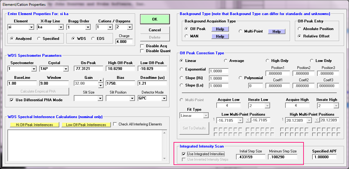

Another alternative for APFs is to utilize the "integrated peak intensities" acquisition option. This tells Probe for EPMA to acquire a full scan on each peak, as opposed to just the peak intensity. That is to utilize the integrated intensity as opposed to just the peak intensity to deal with chemical states causes shape changes in the peak. This option is here in the Elements/Cations dialog:
The basic idea is to acquire a scan from the low off-peak to the high off-peak to capture the entire integrated intensity of the peak.  It works! But it is more time consuming than just measuring the peak intensity.  Here is an example measuring sulfur which is a somewhat different animal because changes in the sulfur chemical state cause a change in the sulfur peak *position*, but not their *shape*:
https://smf.probesoftware.com/index.php?topic=733.msg4660#msg4660
