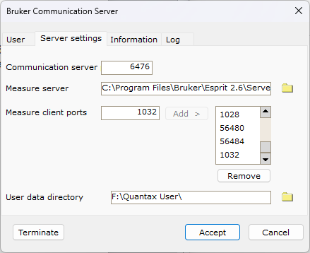

Just a quick suggestion for when one is having trouble connecting Probe for EPMA to the Bruker server.
Matt Taylor at Bruker suggests adding more ports on the Bruker server configuration window:
He suggests:  "no less then 10 server ports. I also suggest to include both 4-digit and 5 digit numbers (e.g. 1026... and 56477...) as this can also be one of the barriers to getting this to work reliably. I read somewhere that 4 digit port numbers are generally used for registered services, while higher value 5 digit port numbers are utilized for the client."
This seems to help, though sometimes when PFE asks whether you want to start a new instance of Esprit it helps to say "Yes", but sometimes it helps to say "No"!
But try adding more more ports to the Bruker server config which is found in the Windows "hidden controls" pop up on the right side of the desktop.  Then right click the Esprit icon and click the "Configuration" menu.
