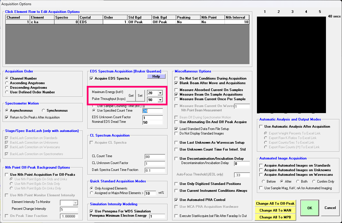

It is worth reminding oneself that when you use the Get/Set max keV or kcps throughput methods in the Probe for EPMA Acquisition Options dialog:
the values are obtained or sent through the Bruker low level RCL interface directly from or to the Bruker Quantax server and are not seen or displayed in the Esprit application GUI.
I had to remember this recently.
