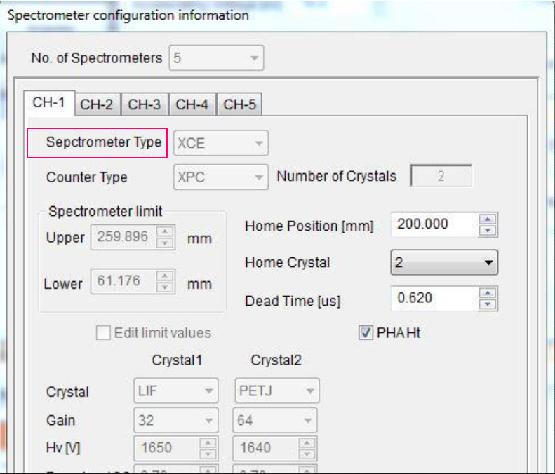

More proof that software is never finished:
:P
DavidAdams
Quote from: Probeman on April 05, 2022, 10:39:00 AM
:P
Maybe we should start a new thread because there are so many typo's in the JEOL software. They're fun little easter eggs sometimes when one has to use that software  ;)
David Adams
The University of Auckland
Ha, yeah I hear you. I was just making a joke on a slow forum day because it caught my eye, but seriously, maybe better to document these typos off-line.
So if you (or anyone else) has notes (and/or screen shots), please send them to my email and I would be happy to forward these to my JEOL Japan contacts.
