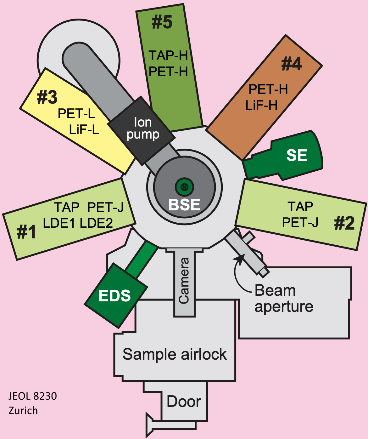

Julien Allaz confirms that there may be regional differences in the JEOL spectrometer arrangements.
Otherwise it would be just too easy!
The point of this topic is to document the JEOL (and Cameca) spectrometer orientations as described in The FIGMAS Round Robin Excel spreadsheet by Aurelien Moy.

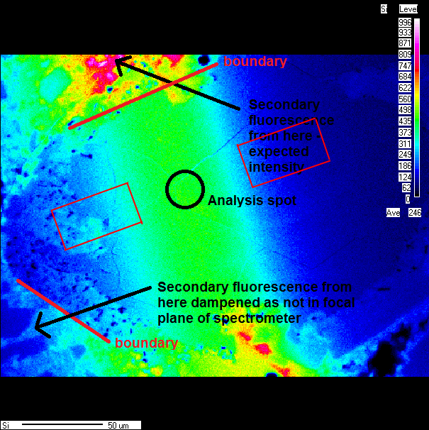

It really shouldn't matter what the spectrometer ordering is for most purposes. Even for the FIGMAS simultaneous k-ratio measurements it's just a convention. The only reason I can think of why we should document the spectrometer orientations, is for performing a Bragg defocus secondary fluorescence correction along the lines published by Ben Buse, where the spectrometer to boundary orientation must be defined (and the Bragg defocus effect measured using beam scans).
https://www.cambridge.org/core/journals/microscopy-and-microanalysis/article/abs/secondary-fluorescence-in-wds-the-role-of-spectrometer-positioning/94F6F5D3992B37BFBB8B4116BB4605D3
If I ever get the time I'd like to implement this procedure in Probe for EPMA, so maybe adding a way for users to define this in PFE is worthwhile.

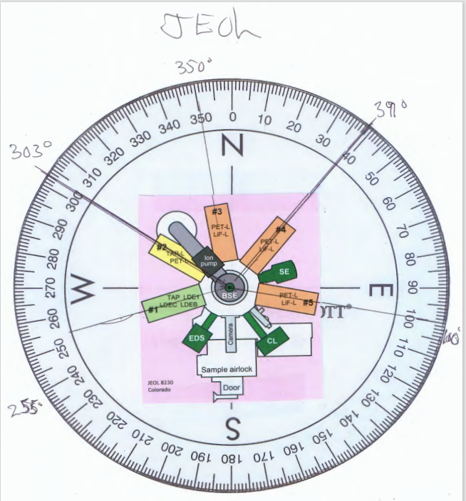

This is a very rough calibration, but this is this is what I came up with:
The angular distances I calculate are:
350 - 303 = 47
303 - 255 = 48
100 - 39 = 61
39 + 10 = 49
So 4 spectrometers are about 47 to 49 degrees apart (+ or -), but one is 61 degrees away to allow for the SE detector I guess. If anyone has numbers from JEOL schematics please let me know what the actual angles are.

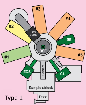

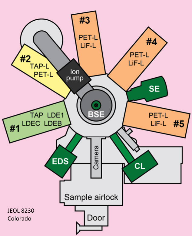

In the above post we attempted to determine the spectrometer orientation angles for JEOL EPMA instruments. I'm hoping that someone out there has a JEOL schematic which would provide the actual angles for the WDS spectrometers.
Based on rotation angles with 0 degrees at the top (North or back) of the instrument and starting with the lower left spectrometer (which we refer to as a Type 1 JEOL spectrometer orientation)  and proceeding clockwise we obtain these rough numbers:
JEOLSpectrometerOrientationType=1
SpectrometerOrientations1="250"
SpectrometerOrientations2="300"
SpectrometerOrientations3="350"
SpectrometerOrientations4="40"
SpectrometerOrientations5="100"
JEOLSpectrometerOrientationType=2
SpectrometerOrientations2="100"
SpectrometerOrientations3="300"
SpectrometerOrientations5="350"
Does anyone have better numbers for these orientations?
Much thanks to Julien Allaz for these very pretty schematics!
