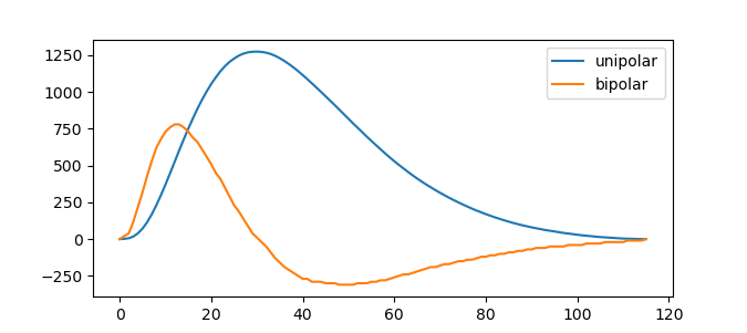

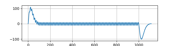

Anyway, I also was working on the way to demonstrate as much as clear why bipolar pulses and its bipolarity maters (how it is behind the shifting and broadening of the PHA distribution). So I took this picture which I already showed previously as a starting point:
and prepared it for capturing the waveform (the time section of 12µs has 300pixels, thus one pixel = 40ns). I refined the captured shape (the orange curve) until integration of the bipolar-pulse (the previous -unipolar- form (blue curve)) would begin at 0=0 and end at y=0:
As we can see from that picture the properties of asymmetry (around y=0) of bipolar pulse is inherited from asymmetry (around x) at max position of uni-polar pulse  - its left side is shorter than right side. Unipolar pulse gets its asymmetry from "cascade" pulses and the background of Charge sensitive preamplifier. Thus important questions are:
Would Unipolar pulse look the same at very high count rates, and low count rates? Would not slope of background should be different - and thus tail - and so the shape of bipolar pulse? The longer is the tail, the longer is the negative part of bipolar pulse, and the shallower.
...so, should unipolar end at y=0 at all count rates or rather not at all???
edit: answer after comparing pulses from measurements on low count rate and high count rate is - it does not change the shape.
I am attaching the digitized form of pulse below as txt.
I found out that it is very easy to model pulse coincidences using simple numpy library of python, using ".convolve" method.
I am not adding any units (neither y, neither x is so important, the important is only pulse proportions), as if I would introduce U [V] and t[µs] and then probeman would freak out that this has something to do with electronics :D, so I leave these unit-less. Also my in-construction pulse generator will be using 8-bit values - thus I will confuse less myself keeping this like that.

to get the previous unipolar form we need to do integration of signal:
uni_pulse_model = np.cumsum(bi_pulse_model)
plt.plot(bi_pulse_model * 10, label="bipolar")  # lets scale for comparison with unipolar pulse
plt.plot(uni_pulse_model, label="unipolar")
plt.legend()
plt.show()

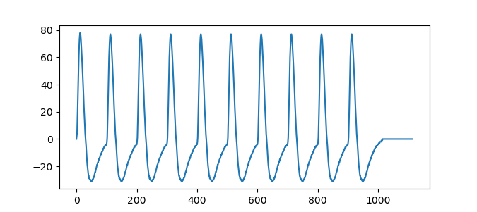

which would produce this (for 250kcps):

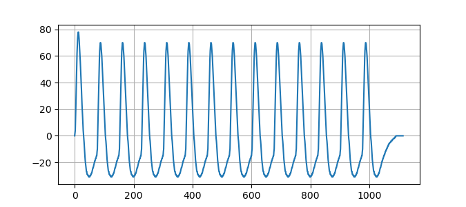

And so if we start to decrease this gap between pulses we start to see amplitude (Relative to y=0) shift downward (except the very first pulse):
pulse_space[:] = 0 # reset everything to 0
pulse_space[0::75] = 1 # pulse every 3µs
model = np.convolve(pulse_space, bi_pulse_model)
plt.plot(model)
plt.show()

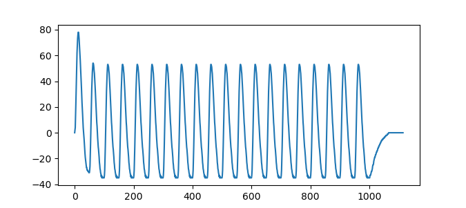

which would produce this for 3µs (for 333kcps):
then for 2µs after code modification (for 500kcps):
then for 1µs (for 1Mcps):

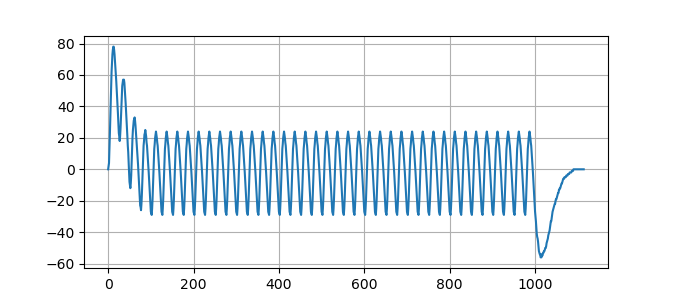

and finaly for 520ns (for 2Mcps):
Well, few things to remind - this is synthetic modeling with even time gaps between pulses imitating average time gap shortening with increased count rate. However pulses comes at random in real life. This simulation shows that with even spaced pulse trains PHA shift should start at 250kcps (input rate), however in real life we observe on Cameca it much earlier, because pulses randomly hit the spot close after other pulse. However this agrees quite well with breaking point of clear PHA shift increase crossing the 250kcps (input).

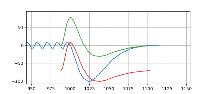

One more point is that those pulse trains are shifted with whole information of amplitude preserved. That gets clear with last negative big pulse when compared with y-shifted single pulse overlays. In example below, the previous (with gaps of 520ns) plot is zoomed at the end part of pulse train:
Stay tuned for the random pulse simulation.
