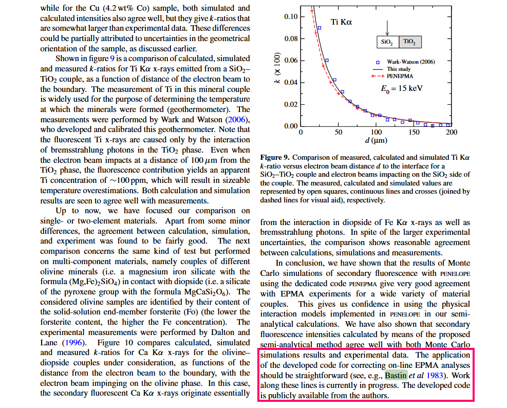

I was recently looking over our secondary boundary fluorescence paper of Llovet et al. and I found this statement, which claims that the development of code for on-line EPMA analyses, of trace elements near boundaries of phases containing significant concentrations of the elements, should be "straightforward" and I had to smile.
Not because the code isn't straight forward as it's really not too bad, one just needs to iterate the adjusted k-ratios  during the matrix correction, but because of all the complications that can occur with actual samples, for example Ben's question below.  Not to mention the complication of correcting for WDS Bragg defocus when the distances are greater than 20 um or so. Fortunately as the distance increases the boundary fluorescence effects decrease!
https://smf.probesoftware.com/index.php?topic=1545.msg13214#msg13214
But I also noticed in the Llovet paper a reference from 1983 by Bastin, which I then had to look up and it is attached as a pdf to this post.  It really is worth a read, but one thing they mentioned several was the difficulty in dealing with non-vertical boundary geometries.
