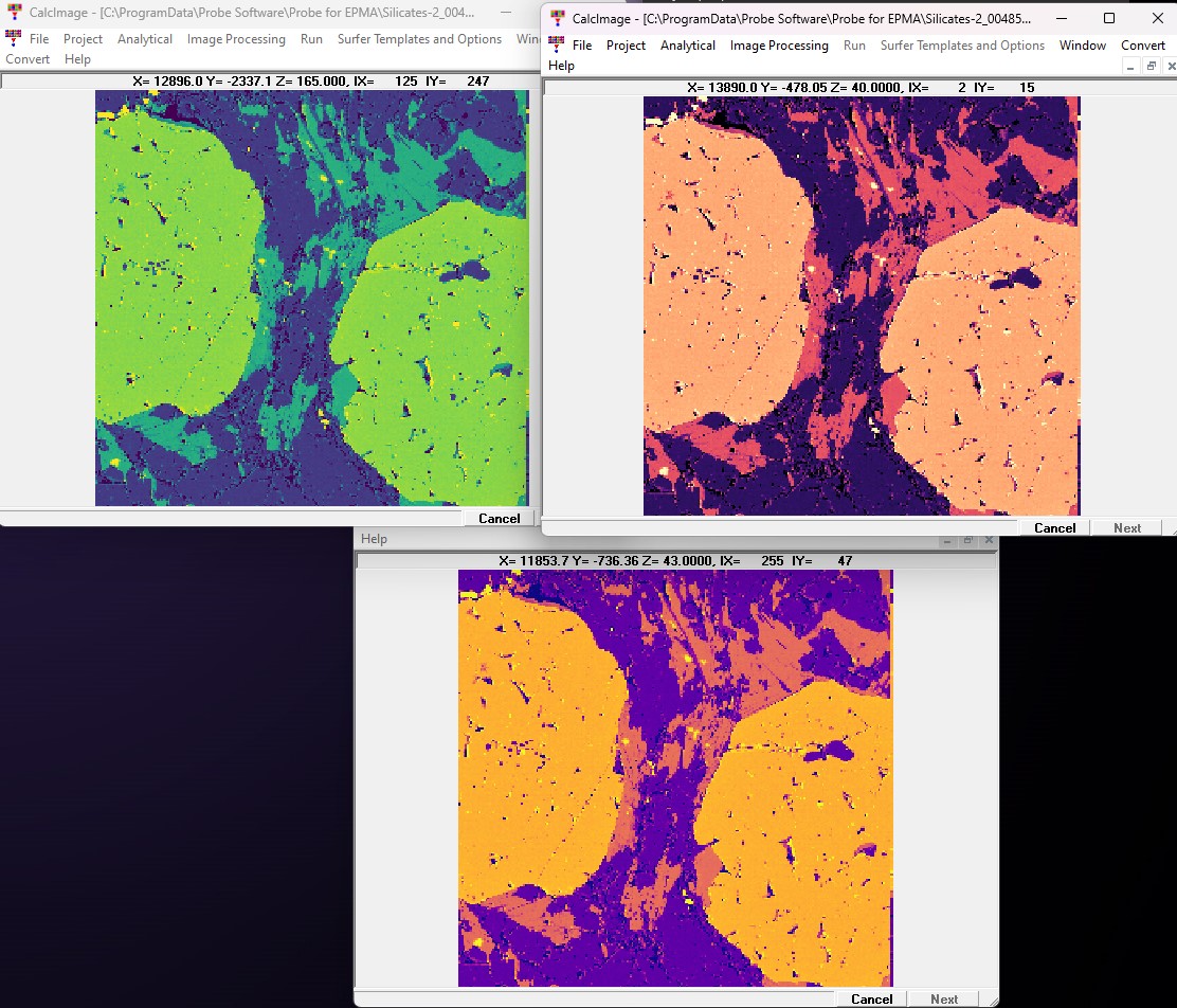

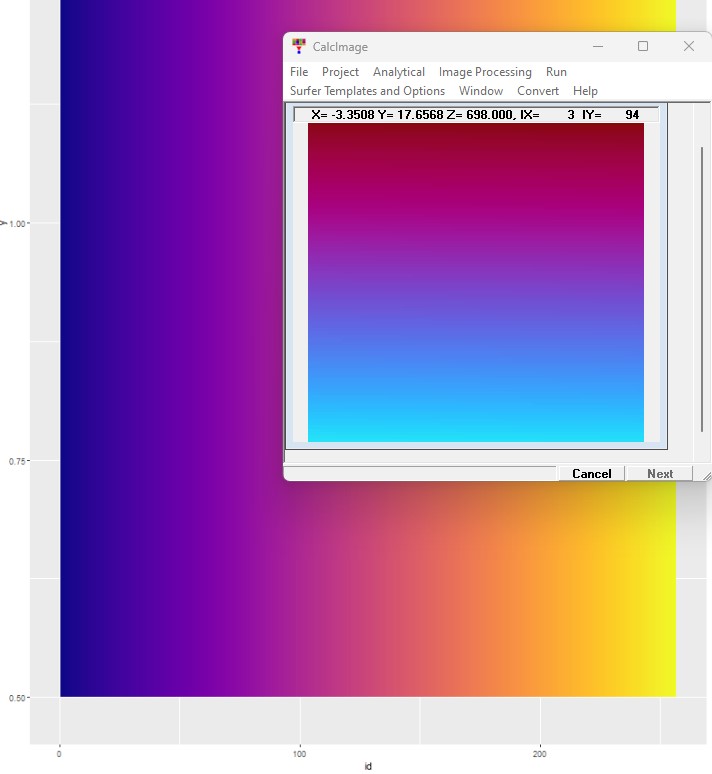

Here's my latest attempt at the Plasma colour scheme, with how it should look plotted up underneath the CalcImage interpretation of it. Getting there, but not quite right yet!
Very nice.

Well, ain't that the weirdest...
I ended up replicating the RGB call in VB to try and figure out where I was going wrong and it turns out VB switches the offset for the R and B channels, hence why my colours were all mixed up (i.e. the blue channel is multiplied by 65536, rather than the red channel). Simply swapped this around and everything is sorted! They are decimal values though, so I wasn't going completely mad.

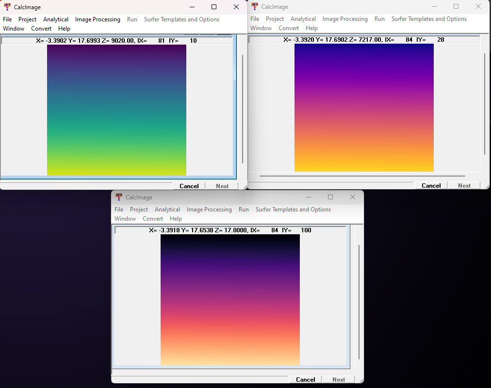

This is the new LUTs in action:
Gradient .grd file:
PfE demo data:
and I've attached the .FC files for CalcImage to this post. To use them, just copy them to your PfE directory e.g. C:/ProgramData/Probe Software/Probe for EPMA/ and rename your LUT of choice to CUSTOM.FC and then re/start CalcImage, open your project/grd and go to Image Processing > Change Current Image Palettes and select Custom.

For completeness, I've also attached the CUSTOM_cividis.FC file to this post

require(viridis)
require(Rmpfr)
require(ggplot2)
require(RColorBrewer)
#Select which range and palette you would like to use e.g.
##Viridis Palettes
#For "magma" from the viridis set:
colshex <- magma(256,alpha = 1, begin = 0, end = 1, direction = 1)
### OR
##RColorBrewer Palettes
#or for "Blues" from the RColorBrewer palettes:
col1 <- brewer.pal(9,"Blues")
#NB you can invert the colour palettes to make more sense e.g. red = high vs blue = high
col1 <- rev(brewer.pal(9,"Blues"))
#Interpolate 256 colours along the selected palette
col1_pal <- colorRampPalette(col1)(256)
#And create a list of the hexadecimal colour values
colshex <- col1_pal
#Create array to fill with colour values converted to decimal
coldecs = array(dim=c(256))
#Convert hexadecimals to RGB values
for (i in 1:length(colshex)) {
    tmp_vir <- col2rgb(colshex[i])
    print(tmp_vir)
    coldecs[i] <- (tmp_vir[1]) + (tmp_vir[2]*256) + (tmp_vir[3]*65536)
    print(coldecs[i])
cat(" False color description for MicroImage",file="CUSTOM.FC",sep="\n")
cat(" BEGIN Items",file="CUSTOM.FC",append=TRUE,sep="\n")
cat(" Interpolate=0",file="CUSTOM.FC",append=TRUE,sep="\n")
for (i in 1:256) {
    cat(paste0(" Item=          ", i-1, "           ", i-1, "     ", coldecs[i]),file="CUSTOM.FC",append=TRUE,sep="\n")
cat(" END Items",file="CUSTOM.FC",append=TRUE)
You've inspired me to look at the python matplotlib color tables, they have a range of colour tables termed colour maps available https://matplotlib.org/stable/users/explain/colors/colormaps.html and it's easy to make your own
So here's the code to make .fc color palette
Create own colour table, where list colors it interpolates between
cmap=matplotlib.colors.LinearSegmentedColormap.from_list(name='testmap',colors=['red','blue'],N=255)
Specify one of preexisting colour tables
cmap = matplotlib.colormaps['gist_earth']
import matplotlib
#create own
#cmap=matplotlib.colors.LinearSegmentedColormap.from_list(name='testmap',colors=['red','blue'],N=255)
#read existing colour tables
#cmap = matplotlib.colormaps('Spectral')
#list all color maps avaliable
#list(matplotlib.colormaps)
#colourtable is 0 to 1, so applying it to range of interest
norm = matplotlib.colors.Normalize(vmin=0, vmax=255)
import pandas as pd
import tkinter
import tkinter.filedialog
savelocation = tkinter.filedialog.asksaveasfilename(title="select save location")
f = open(savelocation,"a")
f.write(" False color description for MicroImage"+"\n")
f.write(" BEGIN Items"+"\n")
f.write(" Interpolate=0"+"\n")
for x in range(0,255):
    #cmap() returns rgba; [] specifies r or g or b or a; norm(x) is 0 to 255 given as 0 to 1 for color map
    r = cmap(norm(x))[0]
    g = cmap(norm(x))[1]
    b = cmap(norm(x))[2]
    #rgb are in range 0 to 1
    rgbdecimal = int(b*255) * 65536 + int(g*255) * 256 + int(r*255)
    f.write(" Item= "+str(x)+" "+str(x)+" "+str(rgbdecimal)+"\n")
f.write(" END Items")
f.close()
Having seen the other thread about the new image export option and the request for the Surfer rainbow and rainbow2 colour scales as .FC format, you can amend the R code above to define the interpolated points from those spectra like so:
#OR interpolate colours between known colours
rainbow2<-c("#000000","#0000ff", "#00ffff", "#009900","#ffff00","#ff0000","#ffffff")
rainbow<-c("#9966ff","#0000ff", "#00ff00", "#ffff00","#ff6600","#ff0000")
col1_pal <- colorRampPalette(rainbow,interpolate="linear")(256)
