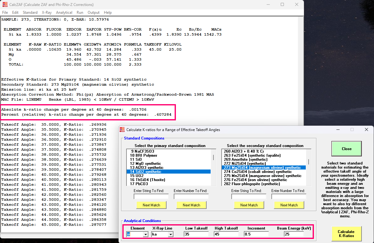

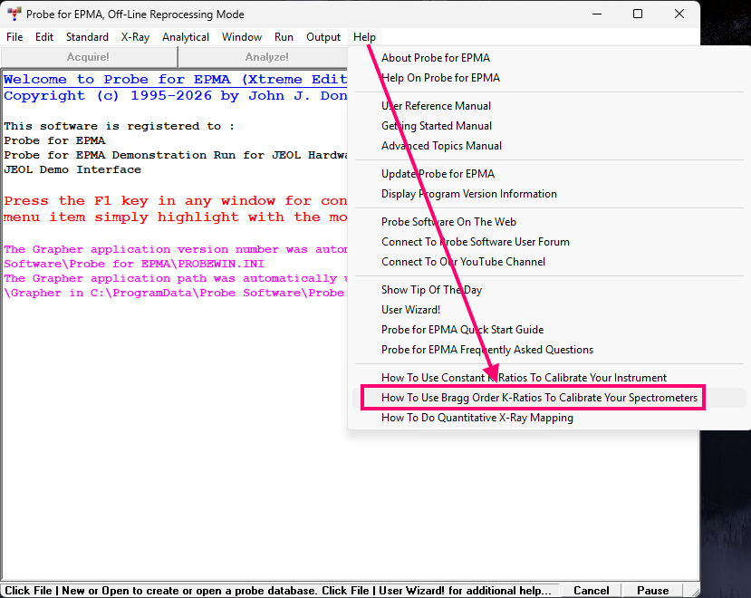

To help perform these Bragg order k-ratio calibrations on your EPMA spectrometers, we added a document to the Probe for EPMA Help menu:
Remember, that these tests can be performed with any materials containing the same element as long as they are beam stable and homogeneous. For the most sensitive Bragg order k-ratio measurements, consider running these tests at a higher beam energy, e.g., 20 or 25 keV in materials with relatively high absorption absorption characteristics. The goal being to obtain the same k-ratio within statistics at all Bragg orders if ones spectrometer is properly aligned.
Note that one can calculate k-ratios for specific primary and secondary standards as a function of effective takeoff angles in CalcZAF as described here:
https://smf.probesoftware.com/index.php?topic=598.msg12062#msg12062
Here is the calculation for SiO2 as the primary standard, Mg2SiO4 as the secondary standard at 25 keV. Note there is a 0.6% change in the k-ratio as a function of effective takeoff angle:
This is helpful to test your spectrometer effective takeoff angles on TAP Bragg crystals using three Bragg orders:
Spectro position for si ka on TAP (2d=25.745 A) (Spc=140 mm), is 77.67373 (with refractive index correction, k= 0.00218)
Spectro position for si ka (II) on TAP (2d=25.745 A) (Spc=140 mm), is 155.0933 (with refractive index correction, k= 0.00218)
Spectro position for si ka (III) on TAP (2d=25.745 A) (Spc=140 mm), is 232.5695 (with refractive index correction, k= 0.00218)
Update Probe for EPMA (and CalcZAF) from the Help menu or download the latest apps from our web site for free:
