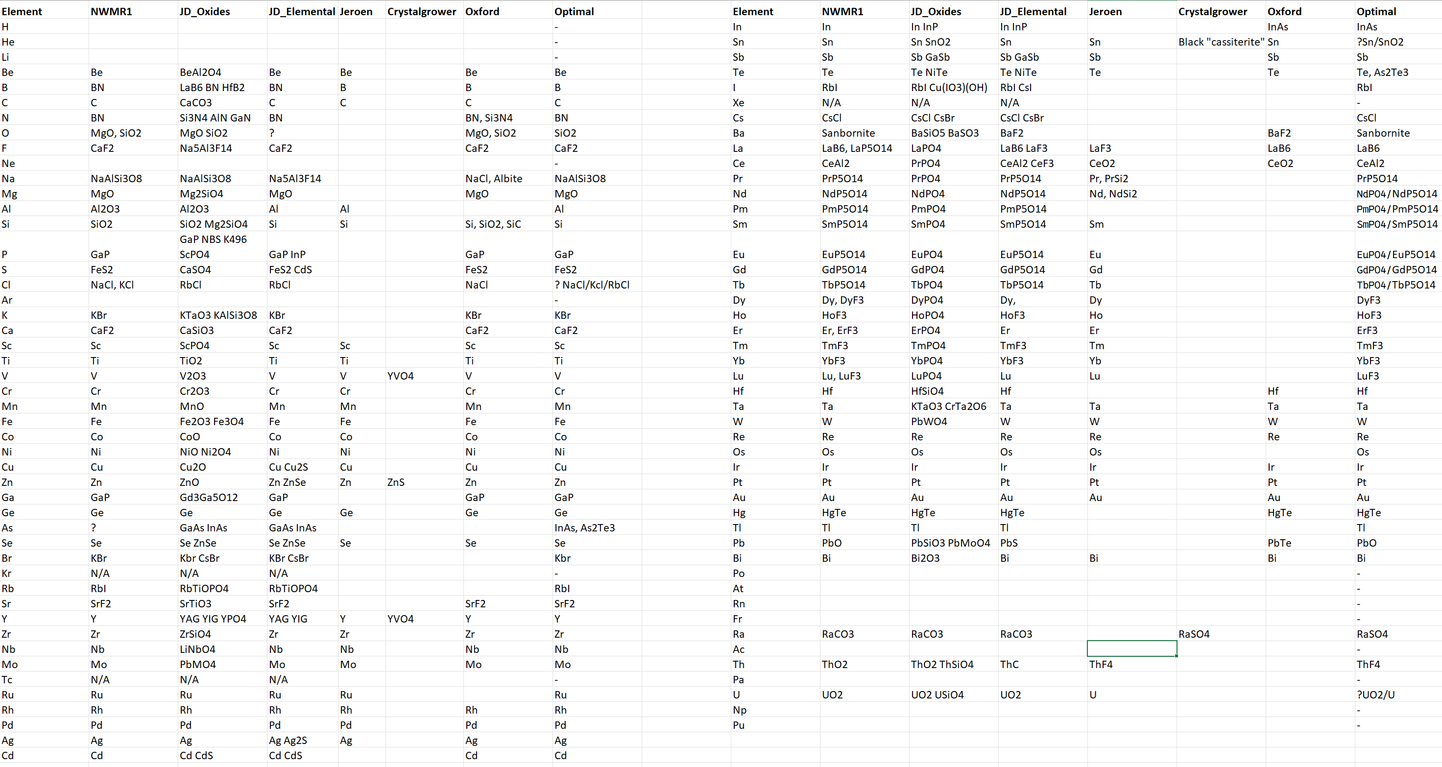

What do you think?  Do you have some favorite standards that I've overlooked?  Have I made some poor choices?

Owen Neill suggested InAs for As.  The In M-lines are below the As L and the In L-lines are below the As K. It is a semiconductor and could serve for both In and As.
  - Teddy Roosevelt
For minor/trace element analyses, I would always use a pure metal or pure oxide if available.
As you well know, for minor/trace elements the background characterization is the most important parameter and a high concentration (that is count rate per concentration) in the primary standard gives the best sensitivity. That statement pretty much covers everything except the alkali metals, liquids/gases.
For major elements the standard accuracy (and matrix correction accuracy) are most important, and the chemical effects might also be worth considering (at least for low energy emission lines), so here is my list divided two ways into elemental/alloy and oxides/silicates:

Also, oxides/silicates tend to oxidize less than pure elements or alloys, so there is some additional advantage in using oxides/silicates in standard mounts.
BTW, I just noticed that one of my standard names in the UofO standard database has a typo.  Standard 259 should be BeAl2O4, not Be4Al2O4!  However, the composition was correct, so just edit the standard name and all is good.
Also, I've always referred to the Smithsonian (Boatner) REE phosphates as PO4, but I see you have the REE phosphates as P5O14. Are those from another source?

Thanks, this is really helpful. I'm coming around to the idea of using oxides like Al2O3 and SiO2 rather than pure elements although you do have to coat and even then the Duane-Hunt is often a little (100 eV-ish) surpressed.  Does anyone else have some suggestions?
The phosphates are "SPI Rare Earth Phosphates" . I recall that they are of Chineses origin via Astimex and are XP5O14. Seee https://astimex.com/com/catalog/reep.html

I can offer a  shortlist of forms that should NOT be used for standards.  Based on years of purchasing for Astimex (check their website for details which still appears to be online) which have been in use for EDS since 1969.  FYI SPI Supplies does not maintain their online catalog any longer.  I still have the EDS spectra archived...my apologies for many updates.
Use of binary compounds such as GaAs and InP and Sb2S3  take care of many nonmetallic elements on EDS.  Astimex catalog only offered the beam- stable ones.   LiF , BN, also useful and no overlaps.
Avoid graphite electrodes as a source of C (too porous)
Try to find an older source of Zr metal rod as the currently available wire has a hole down the middle.  This is partly due to Zr being classified as "reactor material".  Check both Zr and Hf for purity from the other element (price will be higher) because these have perfect overlap for EDS.   And ZrO2 NOT good because it will have too much of both Y and Hf  with perfect overlap on EDS.
We had success with Os, Ru, and other refractory metals from Metallium that they melted by electrical current in vacuum.  They tracked the original certificates of analysis faithfully and did custom cuts. We never found any other acceptable form of Os metal
Optical grade Tl(Br,I) from a reliable source is the only really stable material for all three elements. Sold as KRS-5 for infrared optics, it is 6N and the eutectic composition.  Both TlBr and TlI are difficult to polish and rarely available as crystals.
Th wire is good and available but must be kept dessicated.
I posted instructions on this forum for easy synthesis of K2SiF6, Rb2SnF6 and Cs2SiF6 which are far more homogeneous than any minerals.  Avoid pollucite  unless you can find a clean museum specimen.
Black "cassiterite" is closer to FeSn2O3  than SnO2.  A museum specimen of white SnO2 would not be better than Sn metal.
For Cu use OFHC wire NOT any oxide.
Do not use Mg foil.  FAR too fragile.
Be careful that Be metal has no Al or flux present.

I've summarized the conversation so far in this table.
The optimal column is my current thinking about the best choice to use as "transfer standards" for EDS analysis - robust, available, no peak interferences, etc.
