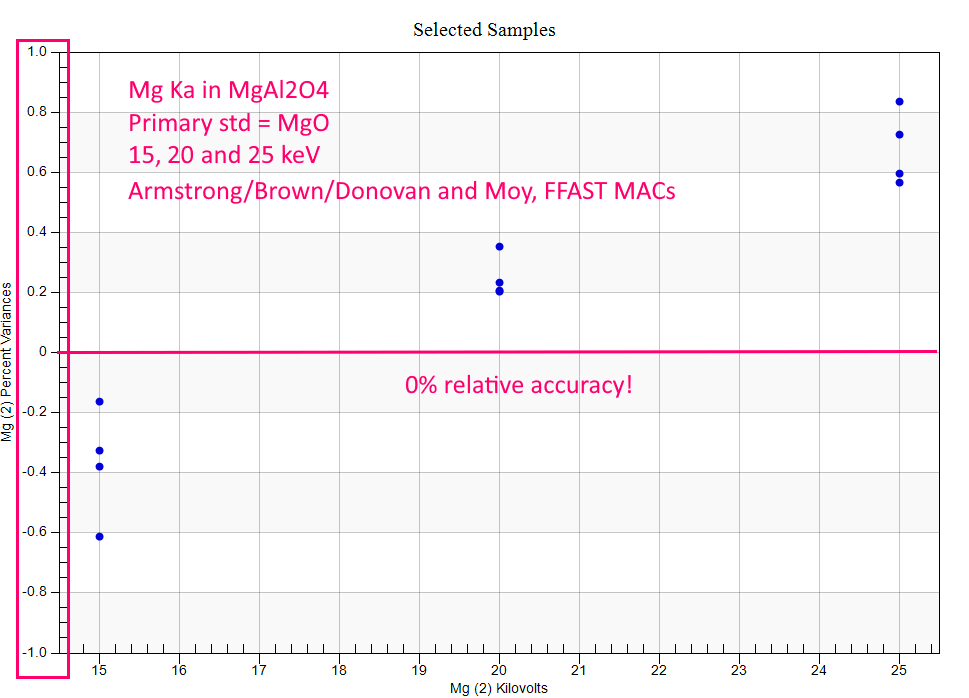

we can quickly evaluate our secondary standard accuracy. Here for Mg Ka in MgAl2O4 using MgO as a primary standard in the FIGMAS mount from Will Nachlas:

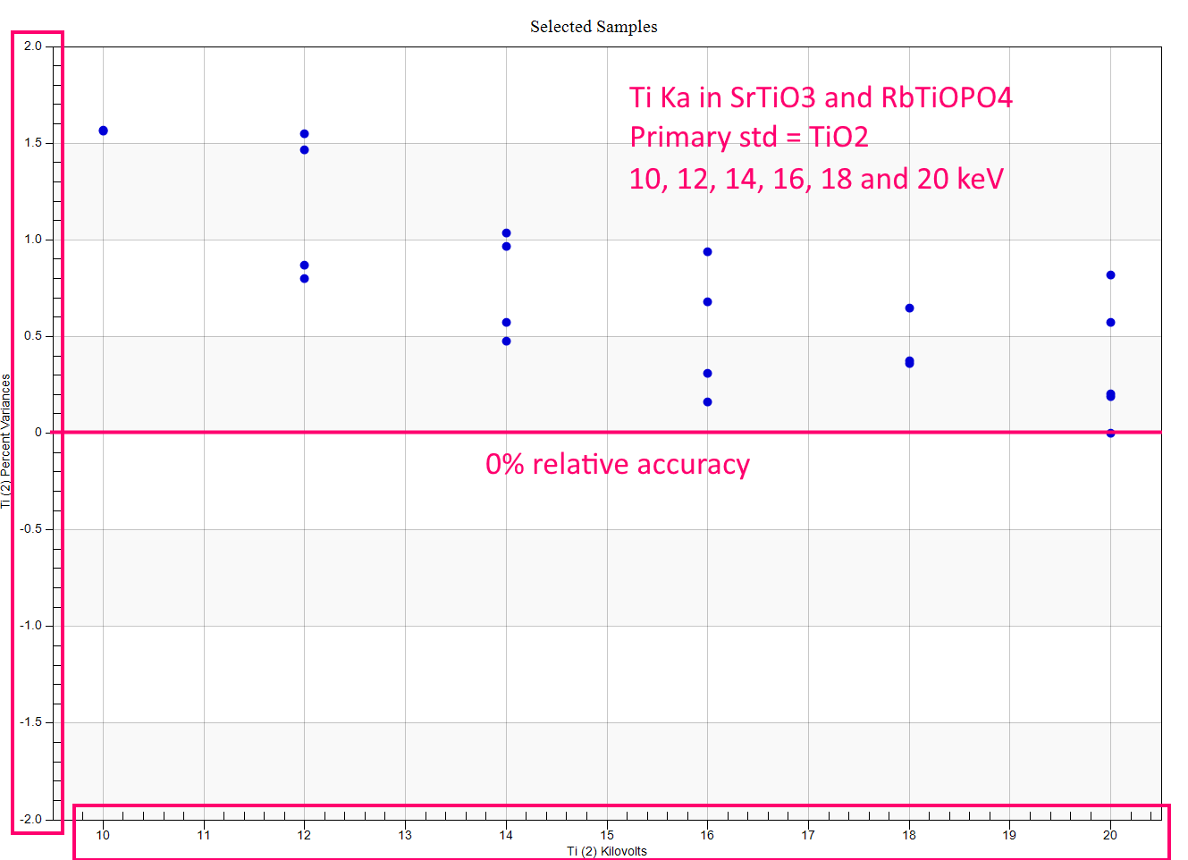

All within 1% relative accuracy. But since we're plotting relative percent accuracy, we can plot more than a single compound, here Ti Ka in SrTiO3 and RbTiOPO4 using TiO2 as a primary standard:

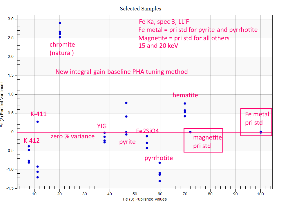

And here for Fe ka in a multitude of compounds using Fe metal as the primary standard for the sulfides, and magnetite as a primary standard for the oxides, silicates and glasses:
Note that only the natural chromite is significantly outside the 1% variance accuracy limits.

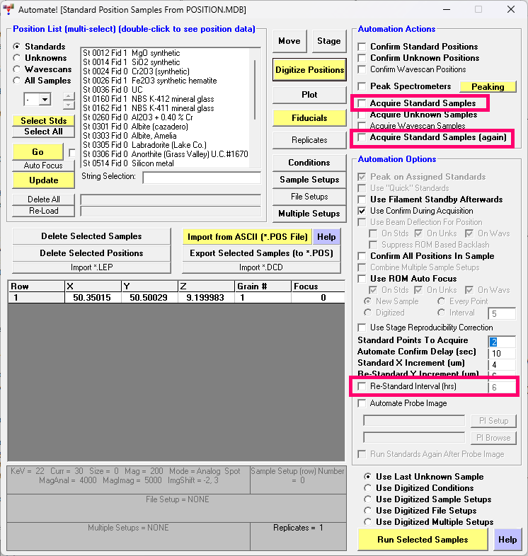

In order to utilize the accuracy checks shown in the above plots, one must run their secondary standards as standard samples. Therefore, some of you have asked: how do I run my standards more than once?
Well first, to re-run ones standard samples a second time, just check the "Acquire Standard samples (again)" checkbox.  Even if you don't have an unknown sample selected, the standards will run a second time.
To run your standard even more replicates, just create an unknown sample and check the Re-Standardization Interval checkbox and enter a short interval (in hours) as seen here:
Say every hour or so. That's easy, right?
