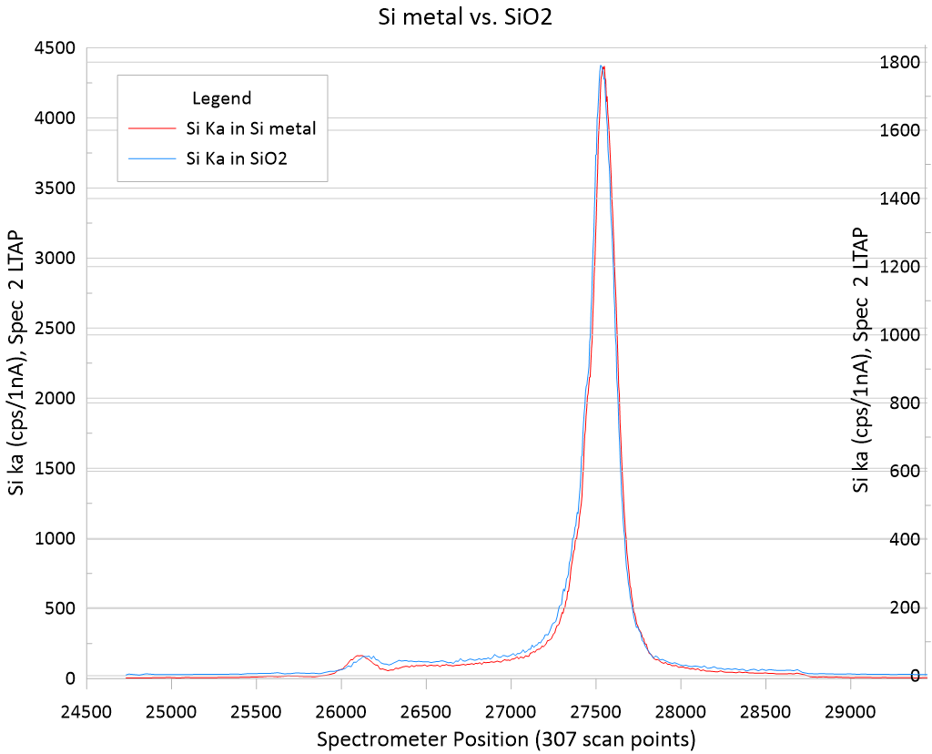

As mentioned in the previous post I have found it necessary for WDS to utilize a metal standard for alloys and sulfides, and utilize an oxide standard for oxides and silicates. Basically WDS has too much spectral resolution than it really needs for quantitative work!
We all know that there is some degree of peak shift with these metal vs oxide measurements, but how much of the effects in quantification accuracy are actually changes in peak position (peak shift) as opposed to changes in peak shape?
Recently I decided to see if I could determine that by first adjusting the peak position for the metal vs the oxide separately. Here are my metal peak positions for Si, Ti and Fe:

Note that the peak position for Fe Ka is the same for the metal and the oxide.  That should be a clue as to what we see next...
When analyzing SiO2 using the pure metal as the primary standard we see this:

By the way, these percent variance values from the published are quite reproducible as I ran each standard twice and got almost exactly the same numbers a second time.  But it is odd that the largest variance was for Si while the smallest was for Ti, while Fe was in the middle (and error is in the opposite direction!).  I suspect this speaks to some complications regarding the physics.
Anyway, these results say to me that the problem is not really due to a peak shift effect but rather a peak shape effect. The reason I had originally suspected this was a peak shift issue, was due to some efforts I did back in 2004/2005 where I found that for S Ka, the quantitative effect was almost entirely due to a peak shift, not a peak shape change. Here is an analysis (aggregated from 3 spectrometers) for S Ka in anhydrite using pyrite as a primary standard:

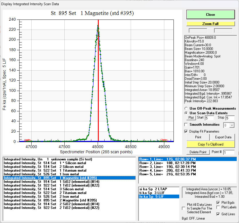

Next we'll perform "integrated intensity" scans where we utilized the area between the off-peak positions to obtain the full integrated intensities of the emission lines, to be continued...
Quote from: Probeman on September 11, 2026, 09:33:30 AMNext we'll perform "integrated intensity" scans where we utilized the area between the off-peak positions to obtain the full integrated intensities of the emission lines, to be continued...

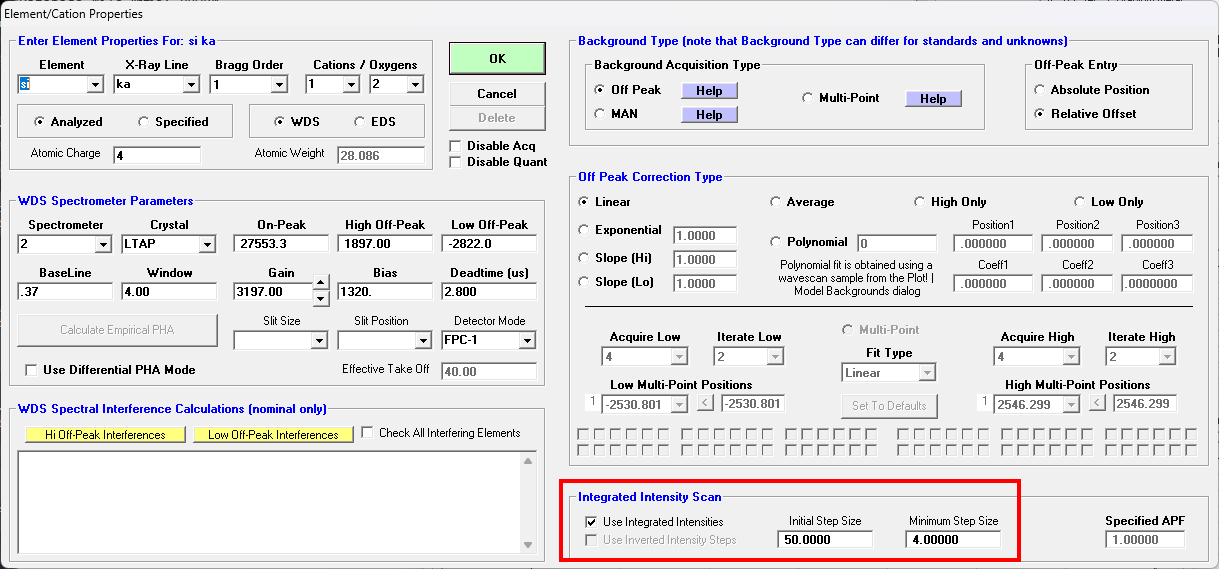

The integrated intensity acquisition feature (see the Elements/Cations dialog) in Probe for EPMA allows one to acquire the full integrated intensity of an emission line for quantification:
by using a spline fit to perform the intensity integration for the full emission peak shape. This allows the software to eliminate peak shift/shape changes between phases that could affect the quantification accuracy for light elements, or as we shall see, even more subtle peak shape changes for higher Z elements even up to Fe Ka between the metal and oxide!
Note that this feature is designed to perform lower resolution steps at low intensities, with the step size decreasing as the intensity increases in order to improve counting statistics on the emission line peak.
In the previous post we saw that even when adjusting the peak position of the emission line for both the metal and the oxide, we still observed quantification inaccuracy on the order to 2 to 4 percent for Si, Ti and Fe. Now we will acquire the full integrated intensities for both materials between the off-peak background positions, starting with Si which we can see displayed here for both the metal and the oxide:
It doesn't look like much of a difference, yet we saw in the previous post that this produced an ~4% inaccuracy when extrapolating from Si metal to SiO2.  Here are the results when using this integrated intensity feature:

The point is that there are indeed subtle chemical peak shifts even for Fe Ka as was originally brought to our attention by Rom a few years ago:
Quote from: Rom on May 07, 2023, 07:43:17 PMSome addition things which might give somebody good ideas. In all cases of the list lower the Standards - 100% metal.
1. Incorrect result of measuring metal in oxide/silicate we obtain for many (I suppose for all) metals.
2. More often the measured concentration of metal (Fe, Ni, Pb,....) in its oxide/silicate is lower then we expected but sometimes higher (Sb, Cu).
3. Differences between measured and expected (published) concentration can be from ~1-2 rel% (Sb in oxide) to ~2 rel% (Fe in oxides, Ni in silicates) and more: ~2-3 rel% (Pb in oxide, silicate).
https://smf.probesoftware.com/index.php?topic=1423.msg11788#msg11788
While we have known for decades of these peak shape changes for low energy emission lines such as O Ka, N Ka, C Ka, etc. we had not noticed these effects for higher energy emission lines as discussed above. I myself had wrongly assumed that these quantification problems were solely due to peak shift issues (as in my discussion of sulfur in the previous post).
The good news is that the integrated intensity feature in Probe for EPMA allows us to investigate these effects. BTW, once you have integrated intensities acquired in PFE, you can investigate them using the Run | Display Integrated Intensities menu dialog as seen here:
Search for "integrated" in the Probe for EPMA User's Reference manual more more details on this integrated intensity feature.
