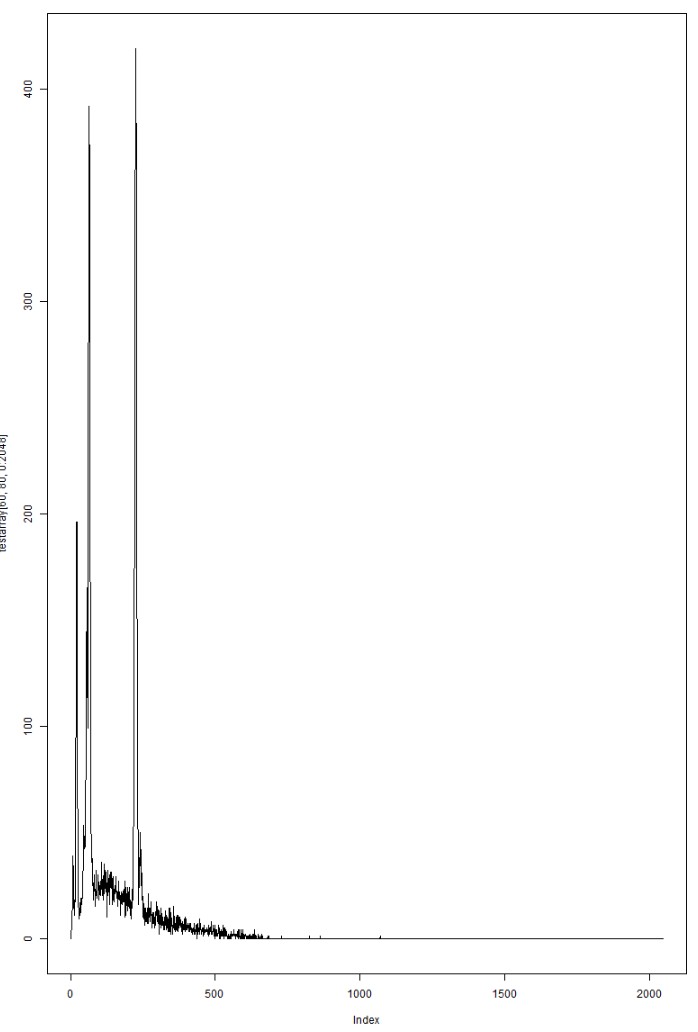

Here's a spectrum from a map I took on our iHP200F using the JEOL EDS (combined SXES, WDS and EDS mapping from within the PC EPMA software):

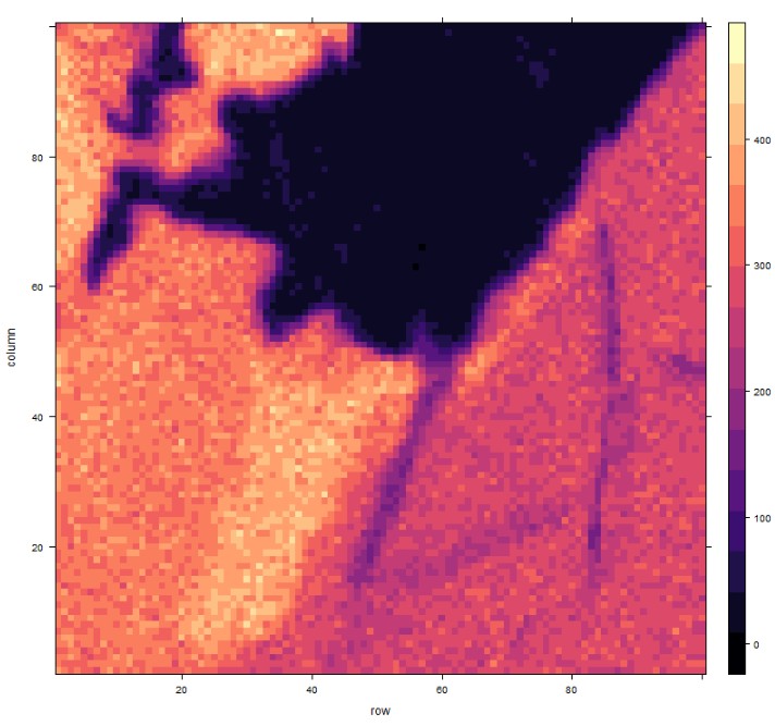

and you can extract arbitrary layers from the map e.g.:

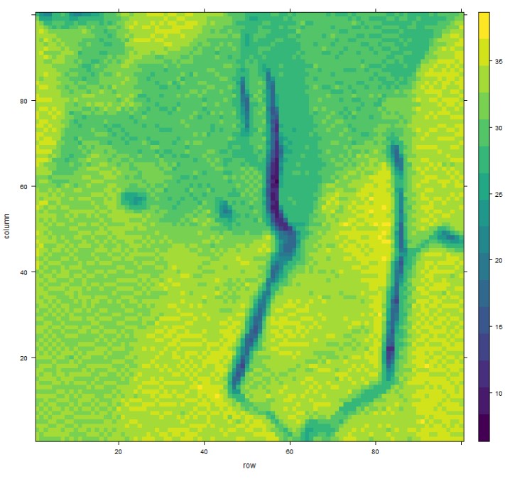

and pull out the dead time for the map, too (units are % dead time):

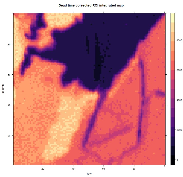

You can then integrate the various channels from the map and correct each pixel for deadtime (units are cps):
The above was from a 100x100 pixel map at 7kV, 30nA with a 600ms dwell time.

Note that intensity data for each pixel (WDS and EDS) are already in raw cps.
Quote from: JonF on Today at 09:01:48 AMI've been doing quant EDS mapping alongside quant WDS (and quant SXES) on our 8530F (old JEOL EDS and SXES-LR) for a while, I gave a presentation on it at EMAS in Mataro last year, but the work wasn't included in the conference proceedings so I've been looking for somewhere else to publish it. It actually works really quite well! This thread has given me the push to crack on and get the same sorted for our iHP200F, which has the new MEC EDS interface and the SXES-ER.
That would be interesting, but sounds like the iHP200F JEOL data cube is different among other things...
Quote from: JonF on Today at 09:01:48 AMI've gone about dealing with the EDS in a very different way from what Ben is doing with NeXL, so I'm very interested to see where that goes.
The problem I see with Ben's NeXL method for quantification in CalcImage is that standards for use in CalcImage are acquired in Probe for EPMA and these net intenities are extracted using the JEOL net intensity function.
So I'm not sure these two different net intensity methods will give commensurate results.
