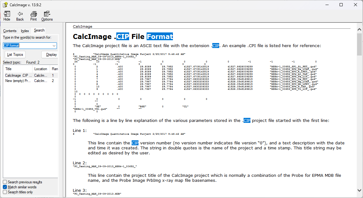

CalcImage CIP project file format
Started by John Donovan, April 28, 2026, 11:15:26 AM
I thought it might be useful to post the read/write code for the CalcImage CIP project file format.  This is the text file that CalcImage uses to store all information (not contained in the PFE MDB file), for defining a quantitative mapping project.
For example to help Ben Buse here:
Quote from: Ben Buse on April 27, 2026, 07:10:03 AMAlso need to figure out how to load files into calcimage best.
At moment I'm creating a new blank project in calcimage and then loading each of the files as grd files. Is there a better way of doing this.
I tried loading the wds elements through the create project wizzard. But when I added eds grd files at the end, it said must be added before off peak maps.
So here is the code for reading and then, writing a CalcImage CIP project file:

Note that additional explanation is provided in the CalcImage Help file:
which can be accessed from the CalcImage Help menu.

I love this entry in the file definition, it made me smile
The next line contains flags for output of analog signal images:
0            "SE"          0            "BSE"          0            "CL"
"MSH4-1_00653_VS1.grd"      ""            ""
It's pretty self explanatory
What do the zeros mean in first line?
Second line is a list of the file names, does "" mean no file present

Quote from: Ben Buse on May 05, 2026, 07:25:57 AMThanks for this post and the help file flag.
I'm just working through programming it in python.
Sorry about that!    :)
The code from above is:
' If version 6, read analog signal image output flags and names
If CalcImageProjectVersion% >= 6 Then
Input #CalcImageProjectFileNumber%, CalcImageAnalogSignalFlags(1), CalcImageAnalogSignalLabels(1), CalcImageAnalogSignalFlags(2), CalcImageAnalogSignalLabels(2), CalcImageAnalogSignalFlags(3), CalcImageAnalogSignalLabels(3)
End If
The CalcImageAnalogSignalFlags parameters are booleans (0 or -1) and indicates if the image is to be displayed along with the x-ray maps as seen here in the GUI:
Quote from: Ben Buse on May 05, 2026, 07:25:57 AMSecond line is a list of the file names, does "" mean no file present
The code is:
' If version 7, read analog signal image filenames
If CalcImageProjectVersion% >= 7 Then
Input #CalcImageProjectFileNumber%, AnalogFilenames$(1), AnalogFilenames$(2), AnalogFilenames$(3)
If Trim$(AnalogFilenames$(1)) <> vbNullString Then AnalogFilenames$(1) = MiscGetPathOnly$(CalcImageProjectFile$) & AnalogFilenames$(1)
If Trim$(AnalogFilenames$(2)) <> vbNullString Then AnalogFilenames$(2) = MiscGetPathOnly$(CalcImageProjectFile$) & AnalogFilenames$(2)
If Trim$(AnalogFilenames$(3)) <> vbNullString Then AnalogFilenames$(3) = MiscGetPathOnly$(CalcImageProjectFile$) & AnalogFilenames$(3)
End If
So yes, an empty double quotes means no image file was specified.

Quote from: Ben Buse on May 06, 2026, 03:37:20 AMWhen I load the generated cip file in CalcImage, it says 'input past end of file' so I'm obviously missing something
Yup, you'll need to add placeholders for dynamic elements.   The other approach is to edit the version number at the beginning of the CIP file to an earlier version number, and then CalcImage will automatically add these missing placeholders...
