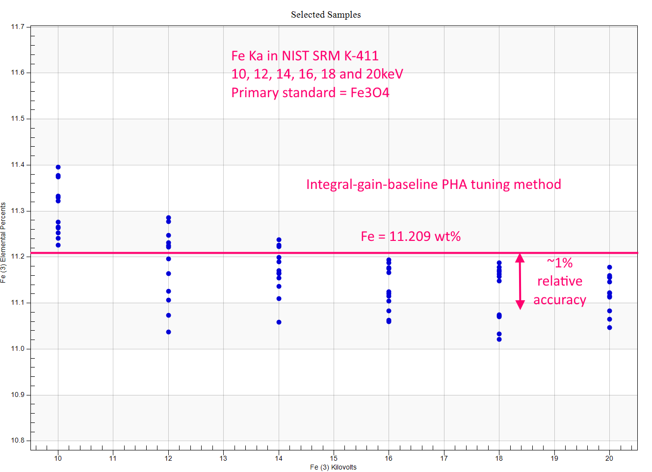

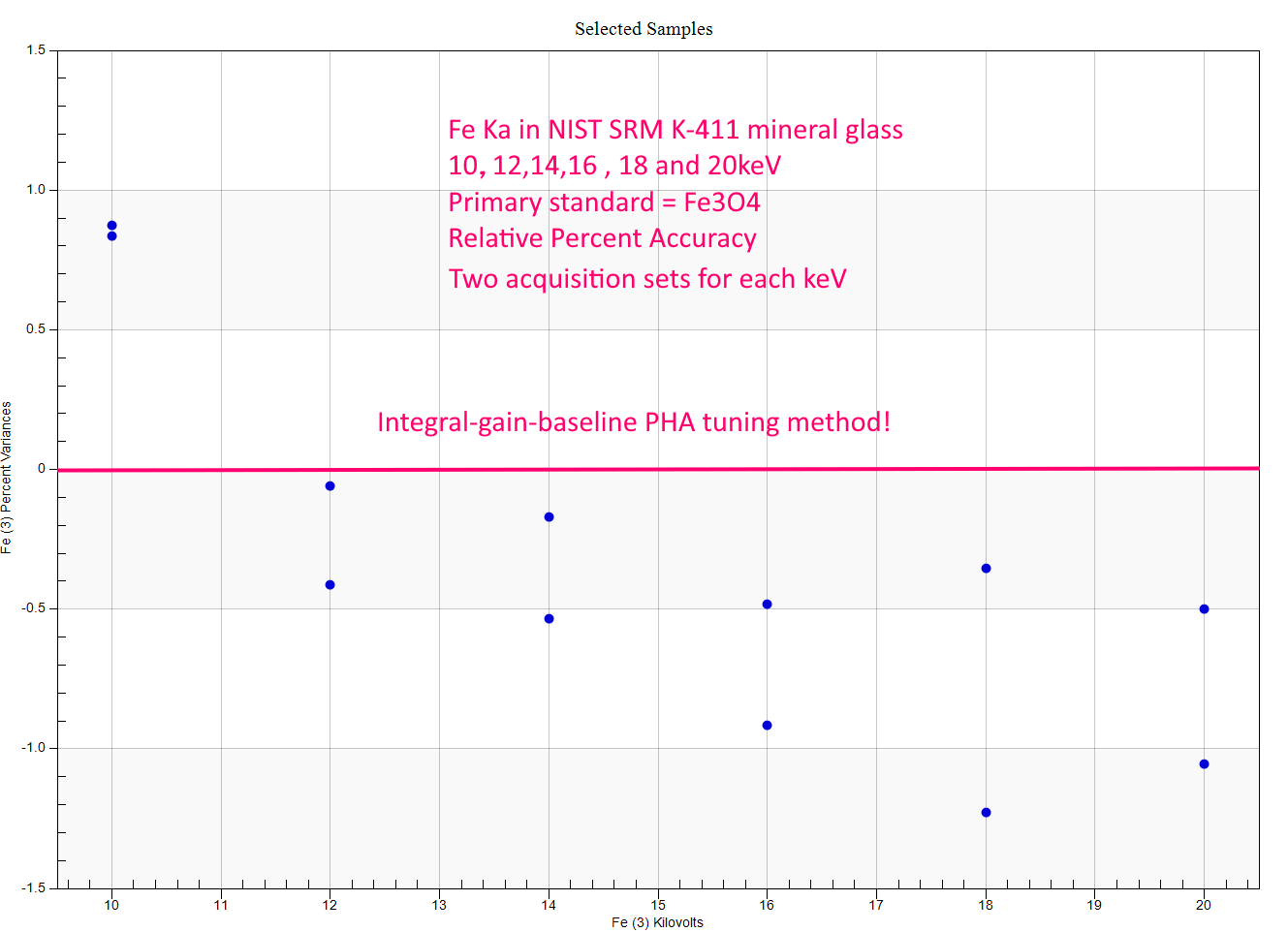

Try this PHA tuning method for ~1% relative accuracy even with large count rate differences, but be sure to check your off-peak backgrounds first!
Attached below (and included in the latest Probe for EPMA v. 14.3.8, see the Help menu) is the latest version of the PHA tuning document with some JEOL PHA examples.
Using this method we can achieve ~1% relative accuracy when extrapolating Fe ka from Fe3O4 to SRM K-412, a 10x difference in count rates.
So much for matrix matching or count rate matching!    8)

Maybe this integral-gain-baseline PHA tuning method won't work on a JEOL instrument as it does on a Cameca instrument, but I think it's worth a try!
The idea is to see if we can extrapolate from a primary standard with a high concentration of the element, to a low concentration, with high (~1%) accuracy. For these JEOL PHA tuning tests we choose Fe Ka, because it is less affected by absorption, so the matrix correction accuracy and the effective take off angle of the spectrometer (mechanical alignment) will matter less.  We will also run at a relatively low count rate because then the dead time correction will also matter less.
And of course do a wavescan to check your off-peak background positions on the glass, because the NIST glasses have a small amount of Mn and the Mn Kb peak is nearby.
To perform this test you'll want to choose the Armstrong/Brown/Donovan and Moy matrix correction because although the absorption correction is small, the atomic number correction from magnetite to the NIST K-412 glass is relatively large:
ELEMENT  ABSCOR  FLUCOR  ZEDCOR  ZAFCOR STP-POW BKS-COR  F(x)u      Ec  Eo/Ec    MACs  STDNUM uZAF/sZAF
  Fe ka  1.0041  1.0000  1.1740  1.1787  1.2484  .9404  .9816  7.1120  2.1091 85.6373    509    1.1136

I realized I hadn't posted the Fe Ka accuracy for NIST K-411 glass using magnetite as a primary standard as a function of beam energies, so here that is:
Also here using the new plot options for standard samples, where can plot the % relative accuracy directly in Probe for EPMA as discussed here:
https://smf.probesoftware.com/index.php?topic=40.msg14388#msg14388
