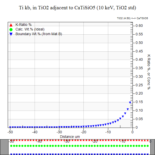

It doesn't make any sense that high totals in the rutile inclusion could be caused by fluoresecence from the CaTiSiO5 matrix, but I ran a quick simulation in Standard:
https://smf.probesoftware.com/index.php?topic=58.msg212#msg212
It doesn't make any sense that this high Ti in the inclusion could be from the matrix since there's less Ti in titanite than TiO2, but sometimes physics unintuitive so I ran it.
There was a TiO2 PAR file already in the Compound sub folder, but had to run a titanite material simulation first. Both PAR files are attached below. Here's the PENFLUOR/FANAL calculation:

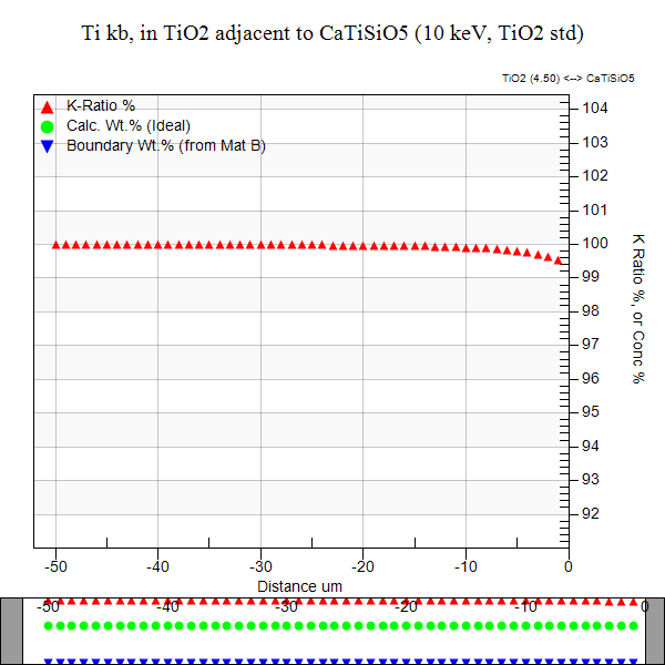

If we zoom into the Ti Kb signal:
It makes sense that the Ti should decrease due to less internal fluorescence and here we can see the contribution just from the boundary material:
Of course this geometry assumes a vertical plane boundary and the actual inclusion geometry should be modeled in PENEPMA but an inclusion geometry should only increase these effects more.
So the high Ti in the rutile has got to be from a carbon coat difference or maybe a standard that is charging slightly...
