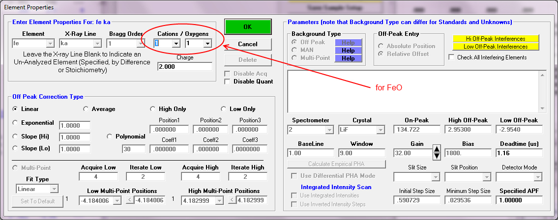

St  395 Set   1 Magnetite U.C. #3380, Results in Elemental Weight Percents
ELEM:       Fe       O       H      Al      Mg      Mn
TYPE:     ANAL    ANAL    SPEC    SPEC    SPEC    SPEC
BGDS:      LIN     LIN
TIME:    10.00   10.00
BEAM:    29.99   29.99
ELEM:       Fe       O       H      Al      Mg      Mn   SUM
     4  71.957  27.474    .000    .201    .072    .054  99.757
     5  72.300  27.712    .000    .201    .072    .054 100.339
     6  71.941  27.797    .000    .201    .072    .054 100.065
AVER:   72.066  27.661    .000    .201    .072    .054 100.054
SDEV:     .203    .168    .000    .000    .000    .000    .291
SERR:     .117    .097    .000    .000    .000    .000
%RSD:      .28     .61     .00     .00     .00     .00
PUBL:   72.080  27.803    n.a.    .201    .072    .054 100.210
%VAR:   (-.02)    -.51     ---     .00     .00     .00
DIFF:   (-.01)   -.142     ---    .000    .000    .000
STDS:      395     377       0       0       0       0
STKF:    .6779   .2132   .0000   .0000   .0000   .0000
STCT:   6749.8  2131.2      .0      .0      .0      .0
UNKF:    .6779   .1944   .0000   .0000   .0000   .0000
UNCT:   6749.8  1943.5      .0      .0      .0      .0
UNBG:     84.6    42.6      .0      .0      .0      .0
ZCOR:   1.0630  1.4229   .0000   .0000   .0000   .0000
KRAW:   1.0000   .9119   .0000   .0000   .0000   .0000
PKBG:    80.86   46.59     .00     .00     .00     .00
St  395 Set   1 Magnetite U.C. #3380, Results in Oxide Weight Percents
ELEM:      FeO       O     H2O   Al2O3     MgO     MnO   SUM
     4  92.572   6.616    .000    .380    .119    .070  99.757
     5  93.014   6.756    .000    .380    .119    .070 100.339
     6  92.552   6.944    .000    .380    .119    .070 100.065
AVER:   92.713   6.772    .000    .380    .119    .070 100.054
SDEV:     .261    .165    .000    .000    .000    .000    .291
SERR:     .151    .095    .000    .000    .000    .000
%RSD:      .28    2.43     .00     .00     .00     .00
PUBL:   92.731   6.899    n.a.    .380    .119    .070 100.210
%VAR:   (-.02)   -1.84     ---     .00     .00     .00
DIFF:   (-.02)   -.127     ---    .000    .000    .000
Above the Fe is calculated as FeO, so in magnetite (Fe3O4), we see an excess of oxygen. Now by adjusting the Fe cations and oxygens as seen here from the Elements/Cations button in Analyze! we can set them to any value between 0 and 99:

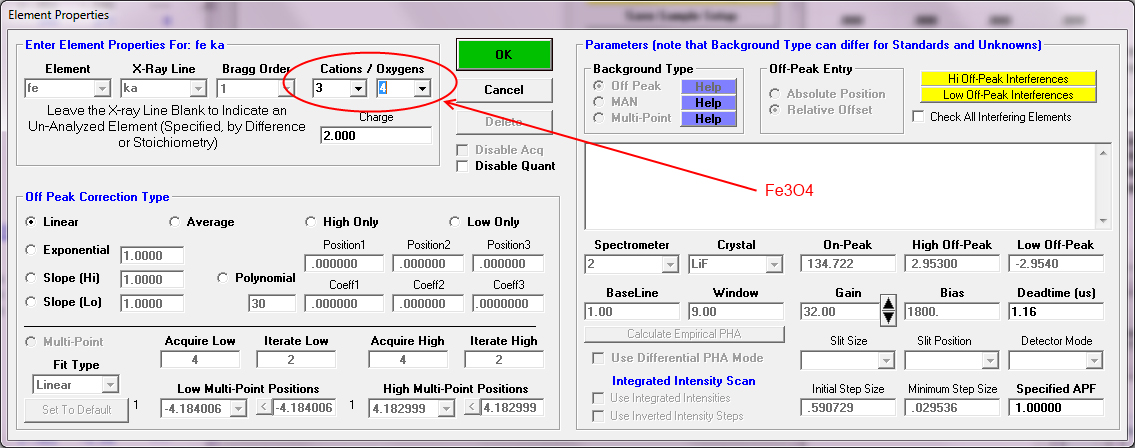

or here as Fe3O4:
Now our output looks like this:
ELEM:    Fe3O4       O     H2O   Al2O3     MgO     MnO   SUM
     4  99.444   -.255    .000    .380    .119    .070  99.757
     5  99.919   -.148    .000    .380    .119    .070 100.339
     6  99.422    .074    .000    .380    .119    .070 100.065
AVER:   99.595   -.110    .000    .380    .119    .070 100.054
SDEV:     .281    .168    .000    .000    .000    .000    .291
SERR:     .162    .097    .000    .000    .000    .000
%RSD:      .28 -152.92     .00     .00     .00     .00
PUBL:   99.614    .016    n.a.    .380    .119    .070 100.210
%VAR:   (-.02) -805.91     ---     .00     .00     .00
DIFF:   (-.02)   -.125     ---    .000    .000    .000
