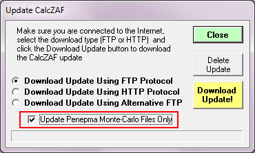

Remember, if you haven't updated CalcZAF and/or Probe for EPMA since we switched to secure https connections in August this year, you will need to manually download the CalcZAF.msi and/or ProbeForEPMA.msi installers on this page:
and run the installer manually once.  After this, you can continue to update CalcZAF and/or Probe for EPMA from the Help | Update menu again.
Or you can manually download the Penepma12.zip file from the various download sites if you prefer and unzip it to your user data folder (usually C:\UserData\Penepma12). The actual pure element PAR files are in the \Penfluor\Pure sub folder.

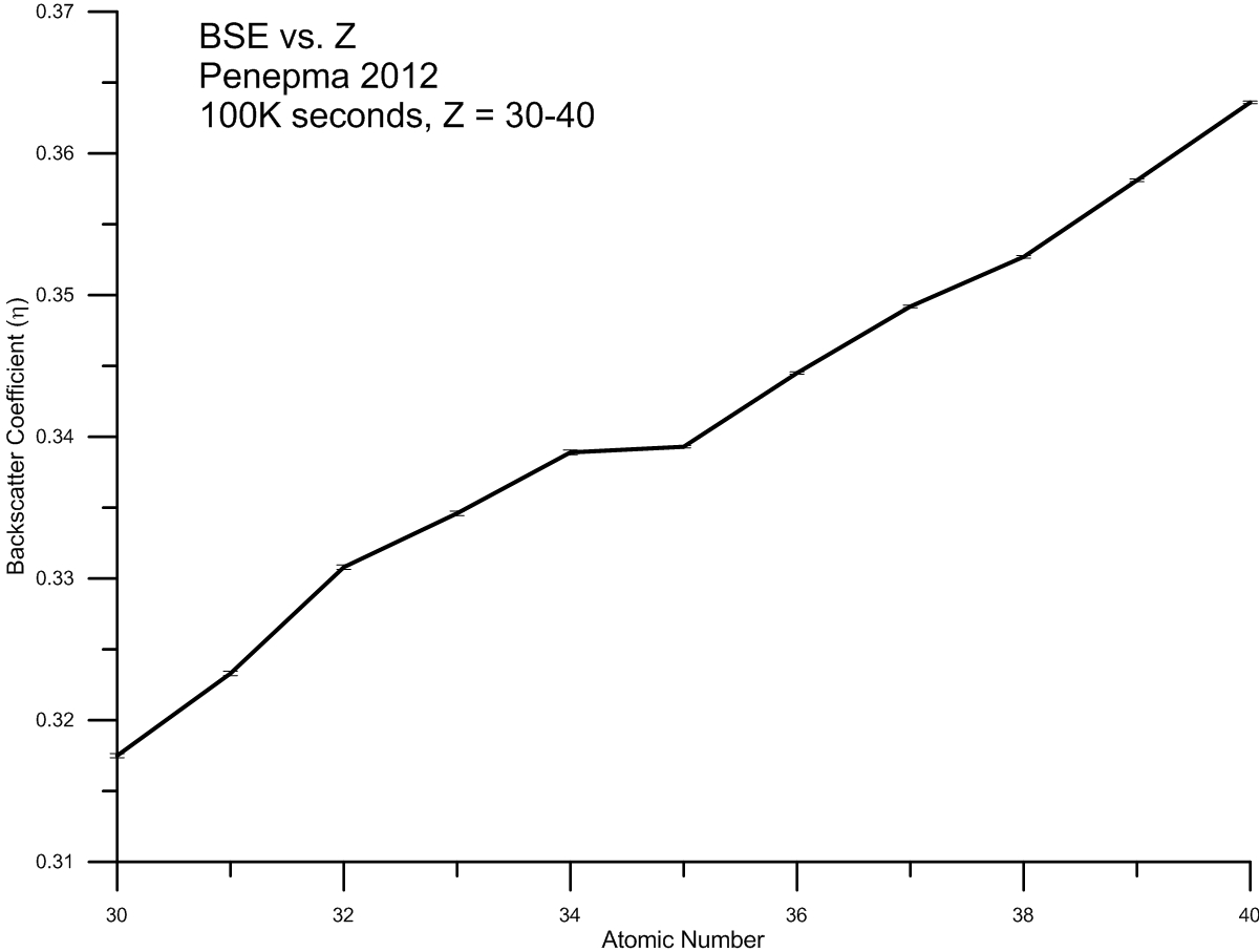

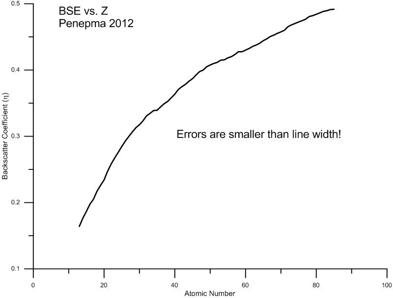

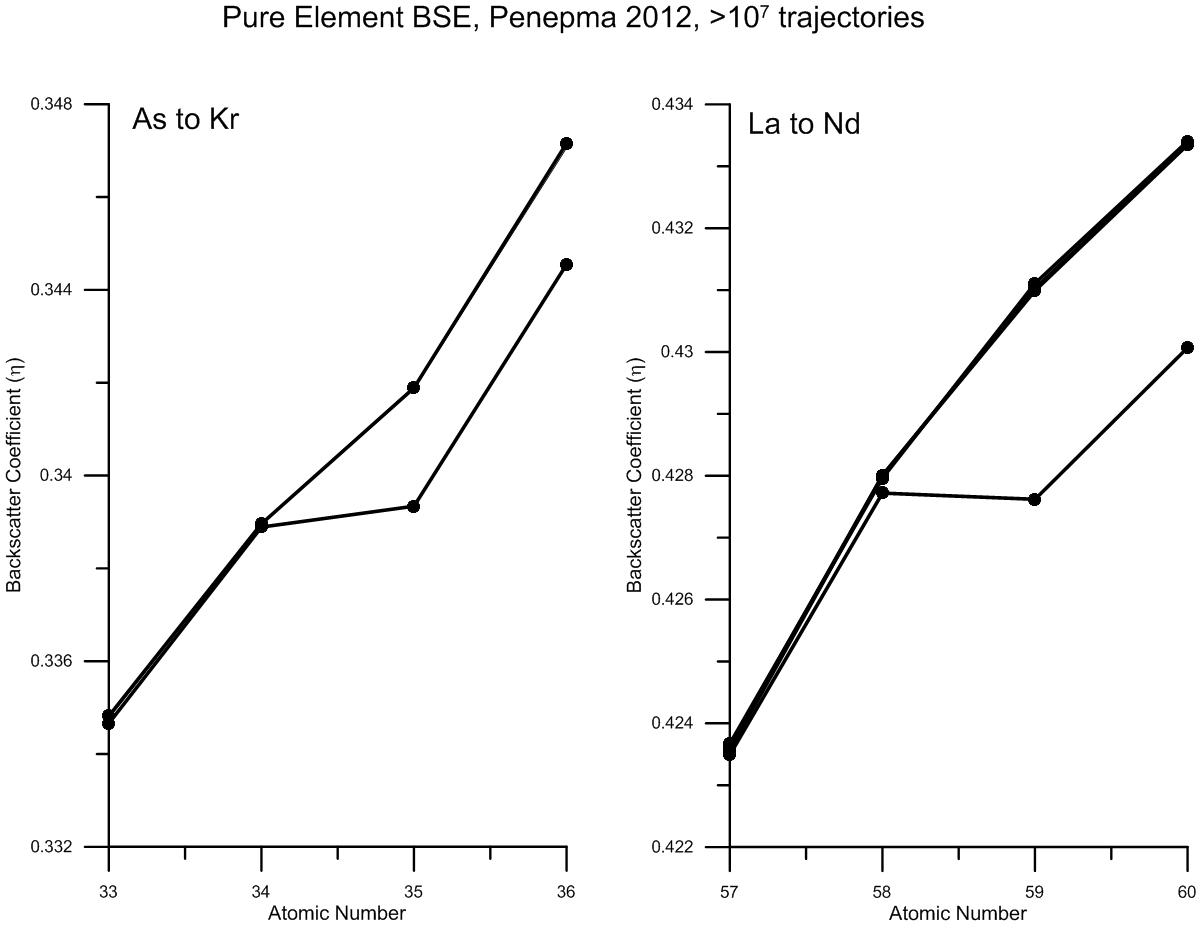

Attached is a plot of some BSE simulations I did recently for pure elements in Penepma (Penelope) 2012 (please login to see attachments).
My question is: are these BSE fluctuations for these pure elements, e.g., around Z = 35 or so, we are seeing in the Penepma calculations, confirmed by empirical measurements?  What I mean, is there a physical basis for these BSE fluctuations in the Penepma modeling?  Or is it an artifact of the elastic scatter modeling in Penepma?
I asked Xavier Llovet and he said: good question!
As he also pointed out, it would be difficult to get enough sensitivity to see this empirically, but I might give it a try. Does anyone have any thoughts on whether this is just a modeling artifact?  Has any one tried to see this with other MC software?
I posted an image in the previous post as an attachment a few days before Christmas so not sure how many people saw it.  Here it is again as an in-line image:
At that time I asked if anyone had noticed whether any other MC software packages show the same discontinuous trends (e.g., around Z=35), for the pure elements.
I haven't had a chance to try other MC programs, but I wondered (because this data was calculated from several different computers), if these discontinuities were just an artifact of statistics, so I ran a longer calculation on a single computer over the holidays and obtain this for pure elements between Z = 30 to 40:
The variances are shown as the tiny errors bars.  So at least Penepma is consistent.  But why these discontinuities occur, for example between Se (34) and Br (35), I have no idea.
So in addition to the small increase in BSE from atomic number 34 to 35 (Se to Br):
34   0.3389
35   0.3393
There is also a small change (actually a decrease!) from 58 to 59 (Ce to Pr):
58   0.4277
59   0.4276
Does this make any sense to anyone?
Yeah, it does make sense in my head at least - this is what I was thinking about back in August on the brain teaser thread (assuming I'm right, of course - something which should never be assumed!). Link to the brain teaser thread:https://smf.probesoftware.com/index.php?topic=1111.msg7468#msg7468.
To paraphrase Goldstein et al*, the elastic scattering events that combine to form the BSE emission result from an interaction of the primary electron beam with the electrical field of an atom i.e. the positive nuclear charge of an atom as shielded by the electron cloud.
It is this effect of the electron shielding that I think you are seeing here.
I've pulled some numbers off the web for the effective nuclear charge at the valence shell (which shell is valence? discussed briefly below) and plotted these up in the attached images - I hope you agree the plot for the effective nuclear charge, Zeff, as a function of atomic number for the elements Z= 30 to 40 looks similar to the plot of BSE coefficient vs Z. What I haven't figured out is why it appears to be offset by 1 compared to your data?
The plot of the 6s subshell for Z = 55 to 61 also show the decrease you were referring to (and in the right place this time!). I've plotted up the 6s and 4f subshells for Caesium (Cs) to Promethium (Pm) (no 4f for Cs and Ba - the 4f energy level is higher than the 6s and so 6s fills first). Why does the 6s subshell show the BSE pattern whereas the 4f doesn't if the 4f is higher energy and so shouldn't it be further from the nucleus and therefore the valence orbital? Not quite... Despite the 4f being higher energy than the 6s, the 4f electrons have a higher probability of being closer to the nucleus than the 6s owing to the shape of the orbitals. The Encyclopedia Britannica actually has a nice diagram of the probability of electron position for Gadolinium (Z= 64) with electron configuration [Xe].4f7.5d1.6s2:
(link for if the image doesn't work: https://www.britannica.com/science/rare-earth-element/media/491579/187149)
Further to this, the filling of the subshells in the lanthanide series also unusual: the electron configurations of Cs and Ba are as expected [Xe].6s1 and [Xe].6s2; but La skips the 4f subshell and starts filling up the higher energy 5d subshell [Xe].5d1.6s2; Ce starts filling up the 4f subshell [Xe].4f1.5d1.6s2; and then Pr dumps the 5d subshell and moves the electron in to the 4f to get [Xe].4f3.6s2 (no 5d electrons).
I think all the wobbles and fluctuations you see through the BSE vs Z model that has been posted are mostly caused by these electron subshell filling/nuclear screening artefacts. If so, I'm actually quite impressed that the MC simulations show it.

Hi Jon,
Wow, this is super interesting!
First of all the BSE brain teaser that Ben and you and I were discussing is a slightly different issue (in my mind anyway), as that is more related I think to how one should calculate average Z for compounds.  Hence the Z fraction to the 0.7 exponent model. The value of 0.7 for the exponent is necessary to calculate the effect of nuclear screening by inner orbitals in higher atomic number elements (it's why the BSE coefficient tends to increase less as Z increases). That and the fact that the number of neutrons tends to increase faster than the number of electrons and protons as the atomic number increases is why using mass fraction skews the average zbar calculation at higher atomic numbers.  See a plot of A/Z for the periodic table and it will make sense.
If it wasn't for this nuclear screening, we could just use a simple z fraction for compounds.  By the way, if you'd like to compare a number of average Z calculations, simply check the Calculate Alternative Zbars in the Output menu of the Standard application.
Now as for these wriggles in the plot of the pure elements I think you nailed it.  I would never have guessed that the outer electron shells would have that much effect on elastic scattering.   Though I agree that it's odd about the change in BSE coefficient from 34 to 35, versus the change from 35 to 36 in the effective charge.  But I double checked the Penepma calculations and I did seemingly type them into the spreadsheet correctly from the penempa.dat files. Here is a section:

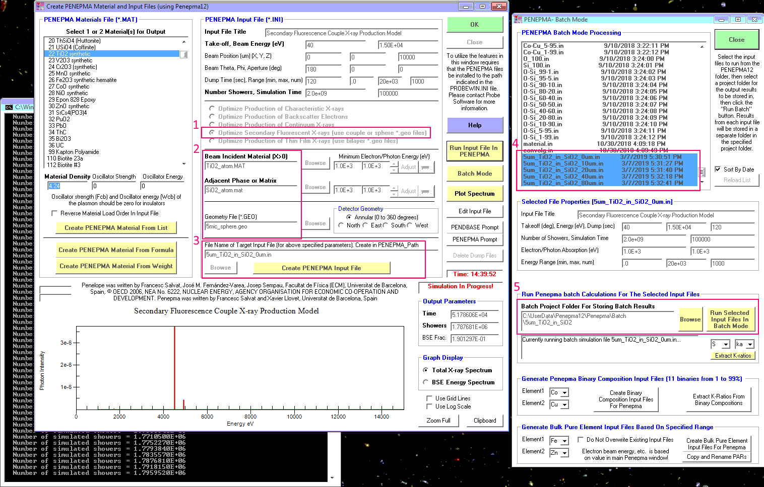

John Donovan has graciously let me test a new Penepma dialog that uses penepma16 under
the hood. This is the current from release from Professors Llovet and Salvat. Everything worked
as expected for simulation of bulk standards.
When I tried the thin-film option from the new release, the penepma16 executable would crash
without an error message.
I had an old penepma16 simulation I had done in 2018 from a similar attempt that had worked
and was able to compare the two input files. The difference was:
I found the problem in the .in file
This works for a bilayer
       >>>>>>>> Emerging particles. Energy and angular distributions.
NBE    0   4e3 1000                [E-interval and no. of energy bins]
NBANGL 45 30              [Nos. of bins for the angles THETA and PHI]
This is what the GUI for penepma16 generates
NBE    0   4e3 250                [E-interval and no. of energy bins]
NBTH   45                     [No. of bins for the polar angle THETA]
NBPH   30                   [No. of bins for the azimuthal angle PHI]
Note that the difference is the use of the NBANGL 45 30 that works
and the older sequence using two lines with NBTH and NBPH doesn't.
I don't think the different number of bins are important. This version
can easily handle 1000 bins...
Neither John Donovan nor I understand why the second doesn't work any longer.
