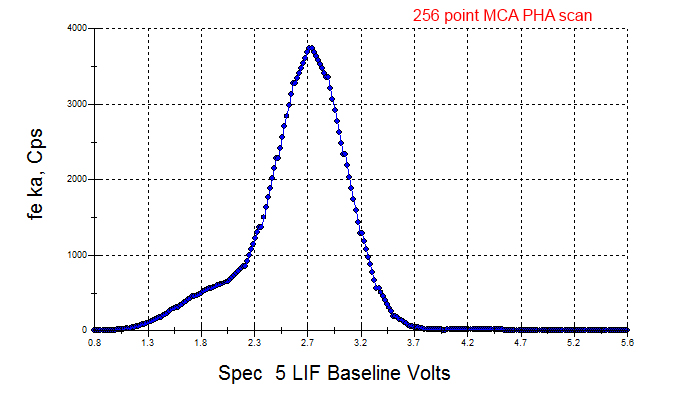

The new code (will upload tonight) also now handles 256 point acquisitions just fine as seen here:

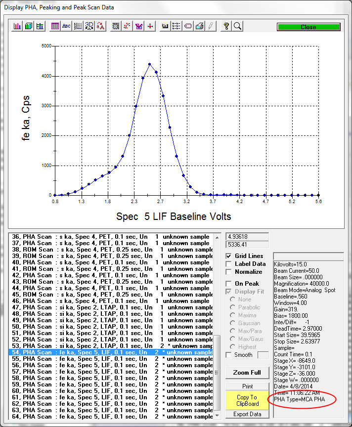

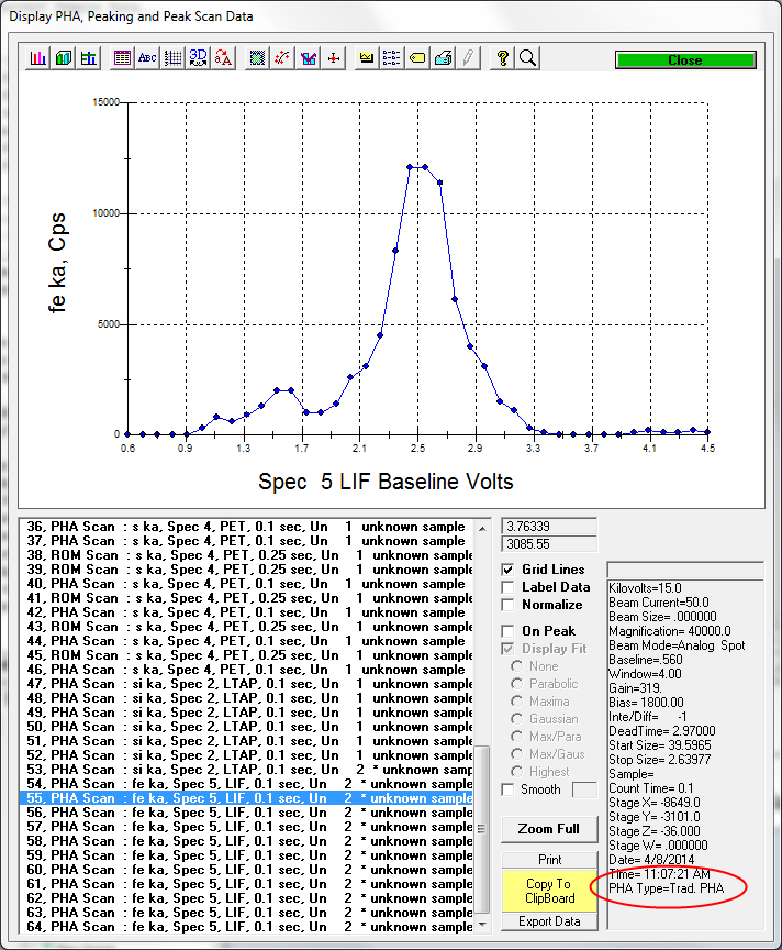

But I'm still a little dismayed that the MCA method seems to have lower energy resolution than the traditional PHA method as seen here:
Note in the two PHA scans above that both scans peak around 2.5 volts, but the traditional PHA scan shows the escape peak more clearly.

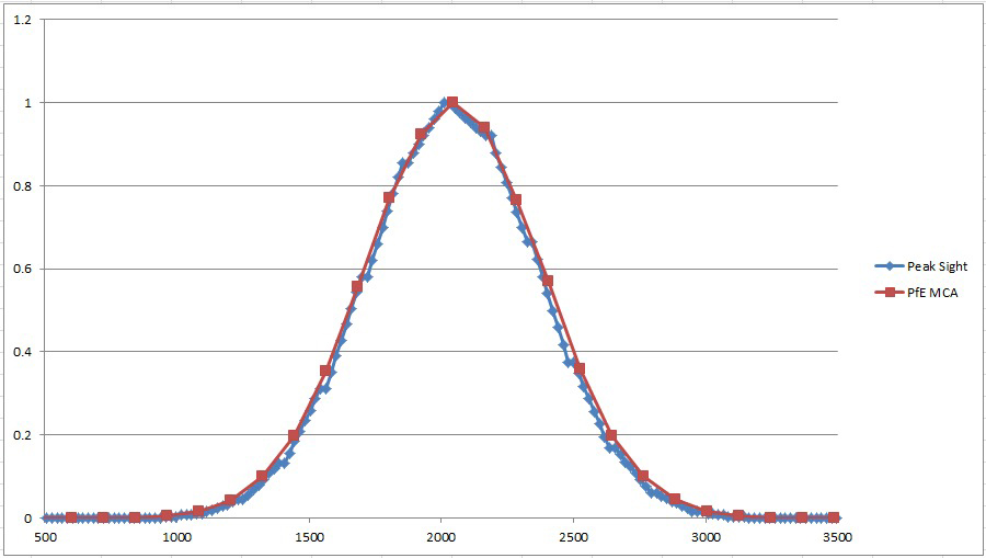

Guys,
I tested the .exe John shared on dropbox. This is what I get now:
This is PeakSight PHA scan over the PfE MCA scan. My parameters are:
PHAMultiChannelMin=0   ; Cameca MCA PHA minimum x-axis voltage
PHAMultiChannelMax=5   ; Cameca MCA PHA maximum x-axis voltage
This is for U Ma on a high pressure spectro and Qtz crystal. .1 counting; 40 channels.
This looks pretty good, doesn't it? As expected. I think the new code is good.
I did not try to look at any escape peaks now. But I am happy that the PHA peak is at the right voltage. Basically for non-escape peak studies this is usable now.

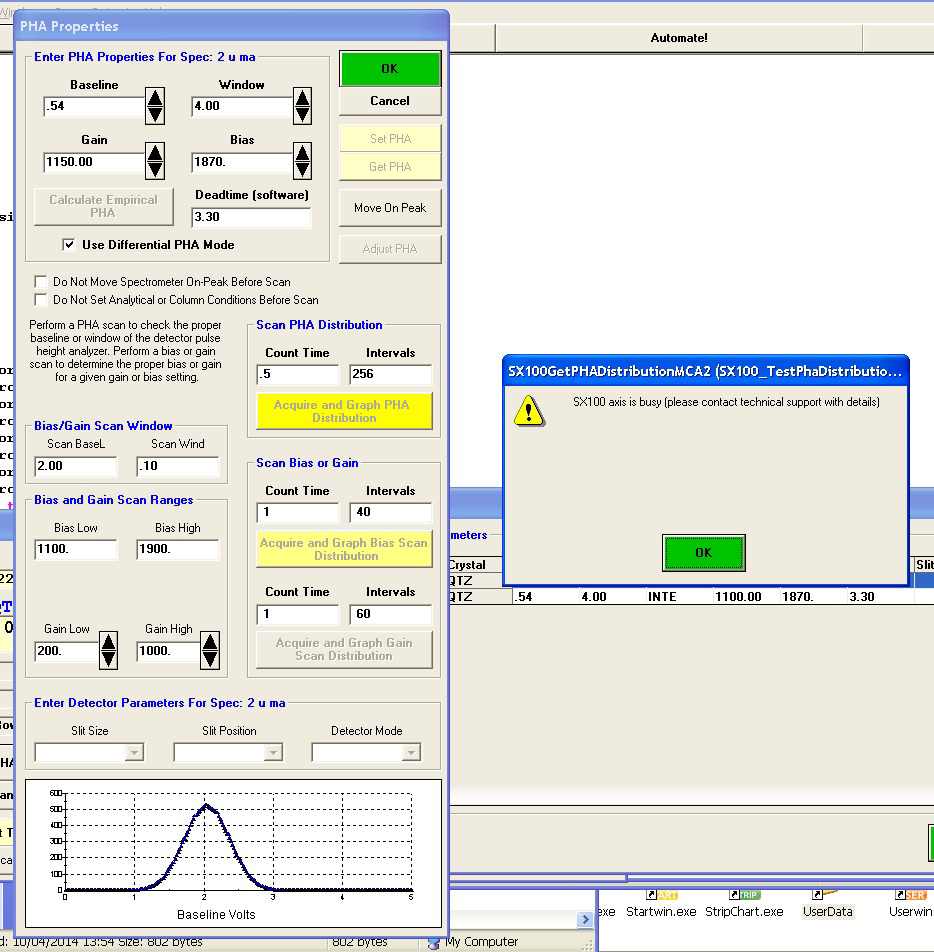

Btw, trying with .5 seconds counting and 256 channels I got:
Ph

You must be a very patient man!  I've written the code so the routine continues to average the MCA PHA values for a time period equal to the count time times the number of points, so 0.5 times 256 equals 128 seconds which is a long.... time!
I can only assume that maybe you accidentally tried to move a stage or spectro axis during the PCA acquisition?

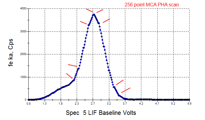

I'm more interested in why the Cameca MCA intensities seem to form line segments, e.g.:

No, in fact there was no time difference between 0.1/40 and 0.5/256. It did not take two minutes at all. The acquisitoin time was exactly the same, about 10-15 seconds or so.
I will try again, but I did not move anything; there is also no reason to move something during these 10 seconds.  I can also count the time, if that helps.
