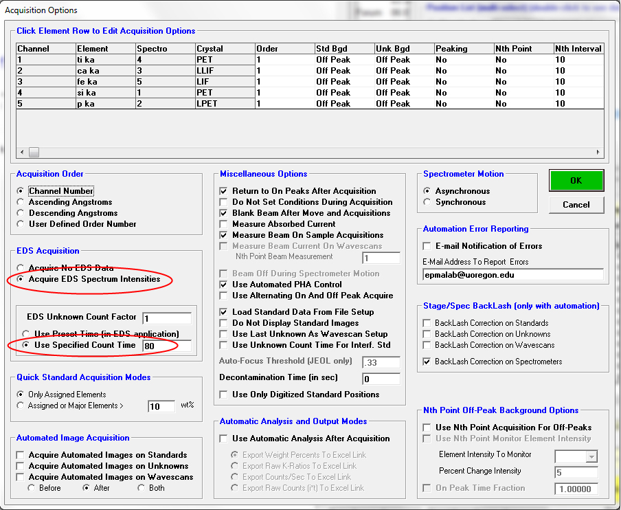

Probe for EPMA handles everything. That said you can certainly force different pulse processing speeds in the NSS software and there is even an option in PFE to just use the default EDS acquisition time, even though you can specify that in PFE also.
Note: when specifying the EDS acquisition time here:
That the specified acquisition time is "livetime", that is, without the deadtime. Therefore, if your DT is 50%, then your EDS acquisition time will be approximately 1.5 times longer than you actually specify- again, this is dependent on the beam current and even sample composition to some extent.
